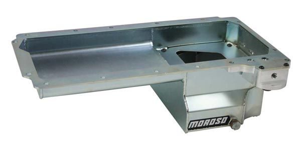

Melling 10296 was suggested for my 416 build, along with a Moroso 20140 7qts oil pan.

That Moroso pan is very nice.

Actually that Moroso 20142 Road Race Oil Pan looks great. I was thinking of doing a baffled stock pan, but that adds some capacity and looks like it'd be even better. Plus it comes with the oil filter integrated. A little pricey when you add the windage tray, pickup, and specific studs. But eh.
I think that'd fit with a UMI Tubular K-Member...

Jake, I just finished mocking up a Spohn K member/manual rack and UMI solid motor mounts. I have to say it has a mile of clearance with the Moroso oil pan.
The 20142 is a nice pan as well, but I like the idea of a remote oil filter.

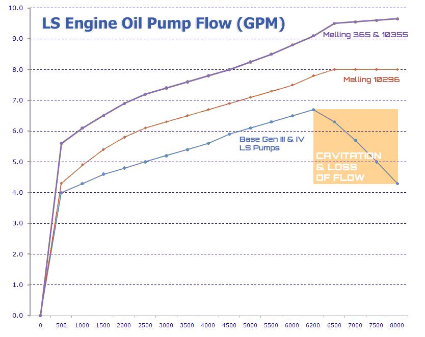

Porting:
  • Porting a pump doesn't change it's flow, at least not significantly enough to be measured or relevant. The flow rate or volume is determined by the displacement of the pump. That's why high-volume pumps have to be larger.
  • Porting a pump DOES help decrease cavitation, especially at high RPM's. Sharp corners and rough surfaces generate cavitation (essentially tiny air bubbles) at high flow rates (high RPMs). This can decrease flow at high RPMs as well as eventually cause "pitting" in the metal where cavitation occurs.
Coating:
  • Coating the gears to reduce friction doesn't increase flow either. However it would improve efficiency, or in other words decrease the amount of horsepower required to turn the pump. This frees up horsepower.
  • They didn't really mention which specific coating is being used. Looking at the Tech Line website, it looks like some coatings might be more permanent (some sort of baked on ceramic coating) than others (dry film lubricants). I didn't see any info on how long they last.
Melling Pumps:
  • The Melling M295 and 10295 are both factory-sized (same volume as the non-DOD factory pump) with approximately the same flow rates. The 10295 has an optional stiffer relief spring which allows for higher pressures a high RPM. The advantage of these pumps is they have less tendency to cavitate at high RPMs.
  • The Melling 10296 pump flows approximate 18% more than the factory non-DOD pump (because it has a little more displacement). It's a good choice if you need a little more oil flow for a non-DOD setup. It also has the optional higher relief pressure spring like the 10295 pump.
  • The Melling 10355 flows the same as the factory DOD pump. These pumps are only required for engines equipped with DOD and VVT, which are hydraulically actuated by oil pressure. Engines with DOD have a relief valve built-in to the oil pan to return excess oil flow straight back to the oil pan when DOD isn't active and the excess flow isn't needed. These pumps shouldn't be used with regular non-DOD engines because they flow more than necessary and can result in emptying the oil pan, which can lead to oil starvation, if you don't have the relief valve in the oil pan. And if you do have the relief valve but nothing to consume the extra oil flow, the excess flow won't be doing anything except decreasing wheel horsepower as they require more horsepower to turn. You might need the 10355 pump if you somehow have very loose tolerances or ported oil passages and have trouble maintaining oil pressure with a standard flow pump at lower RPMs. But typically the 10296 has enough flow to correct for that.
