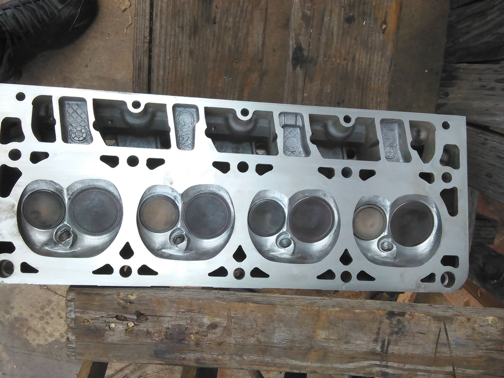

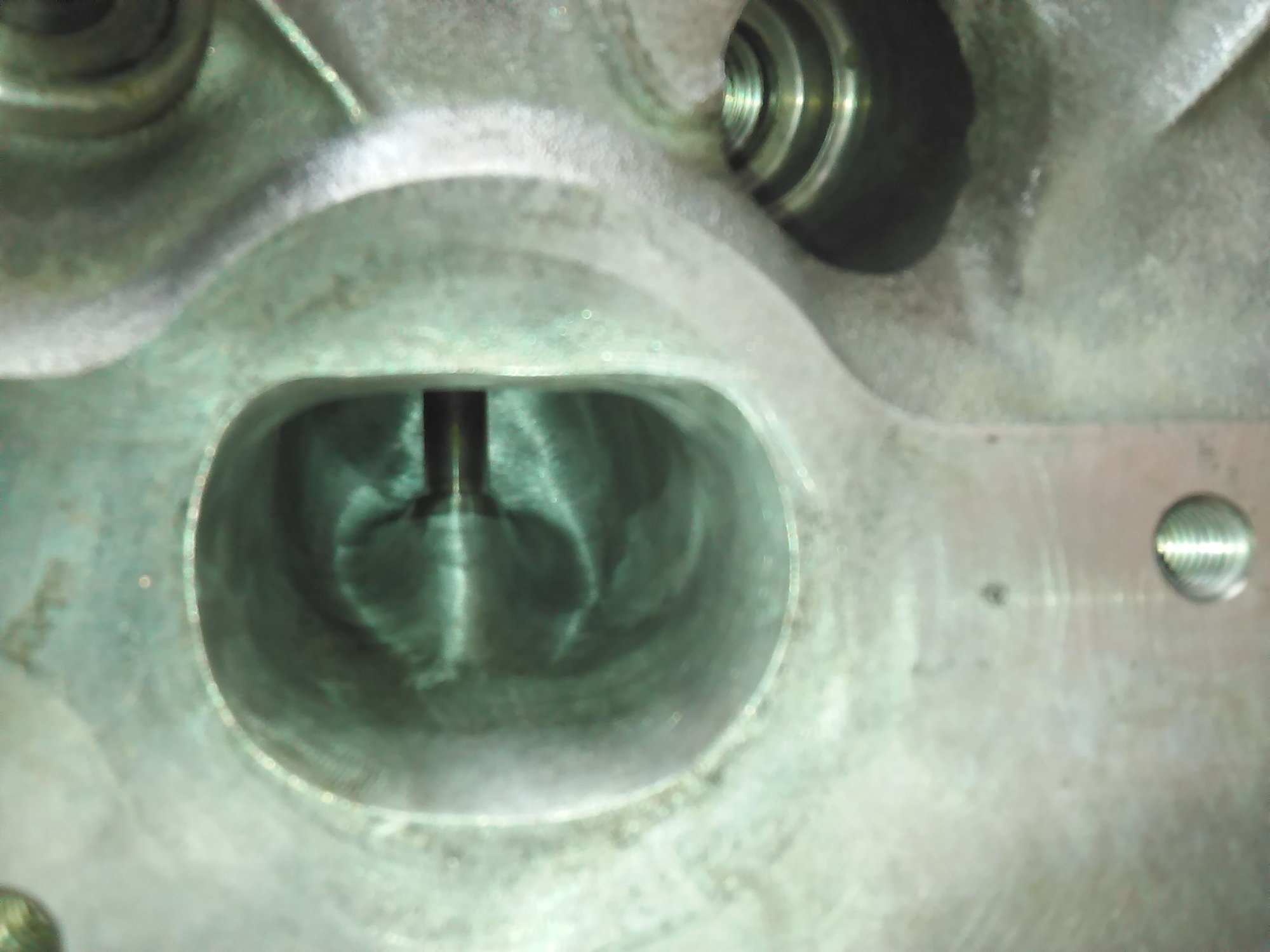

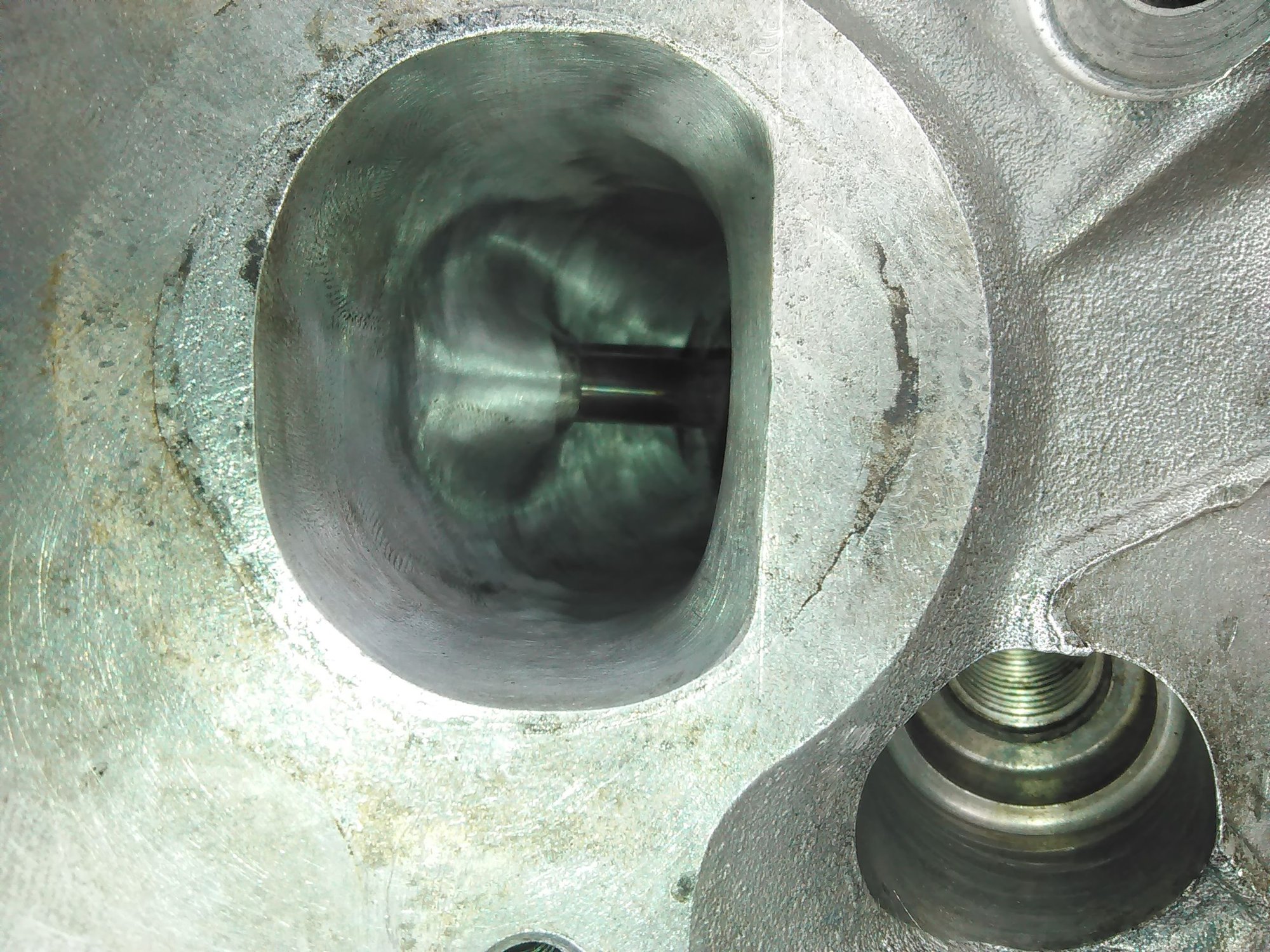

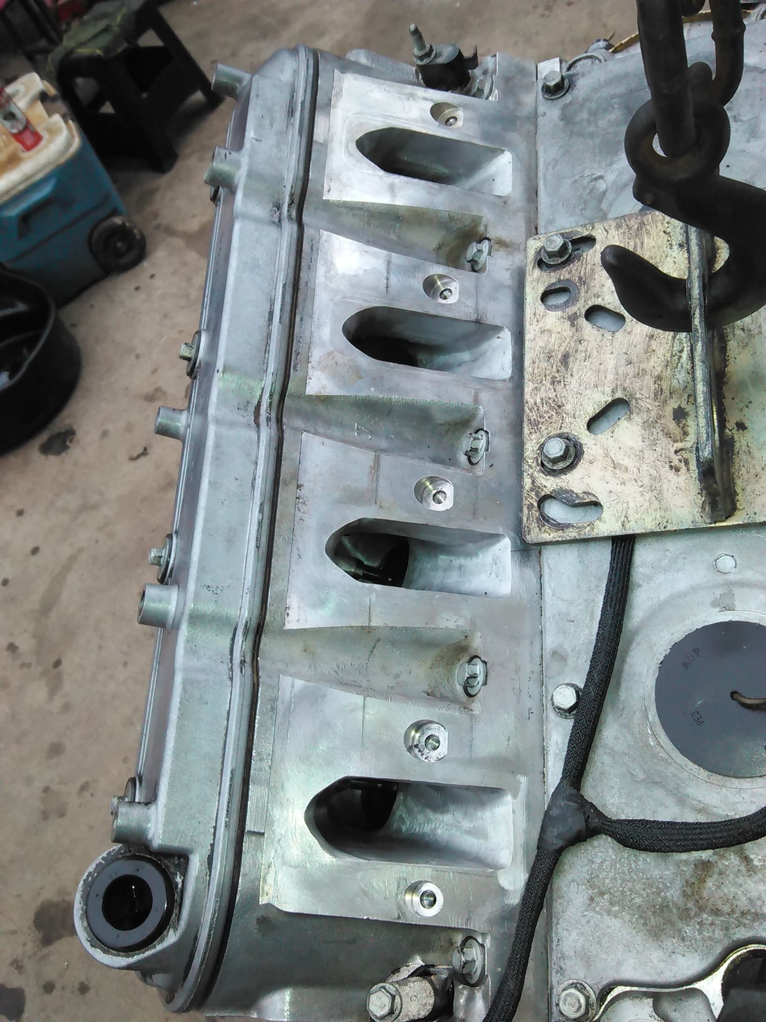

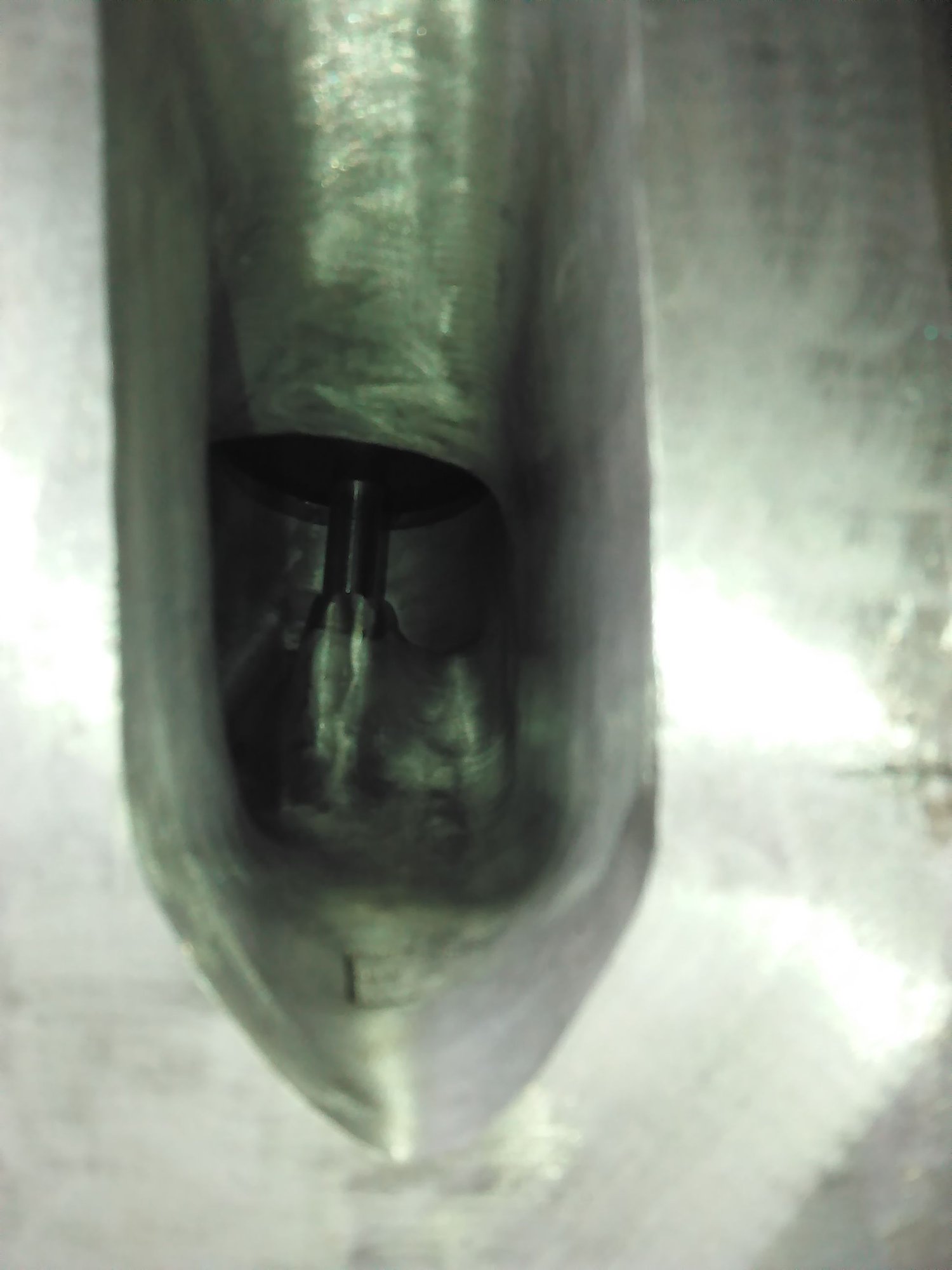

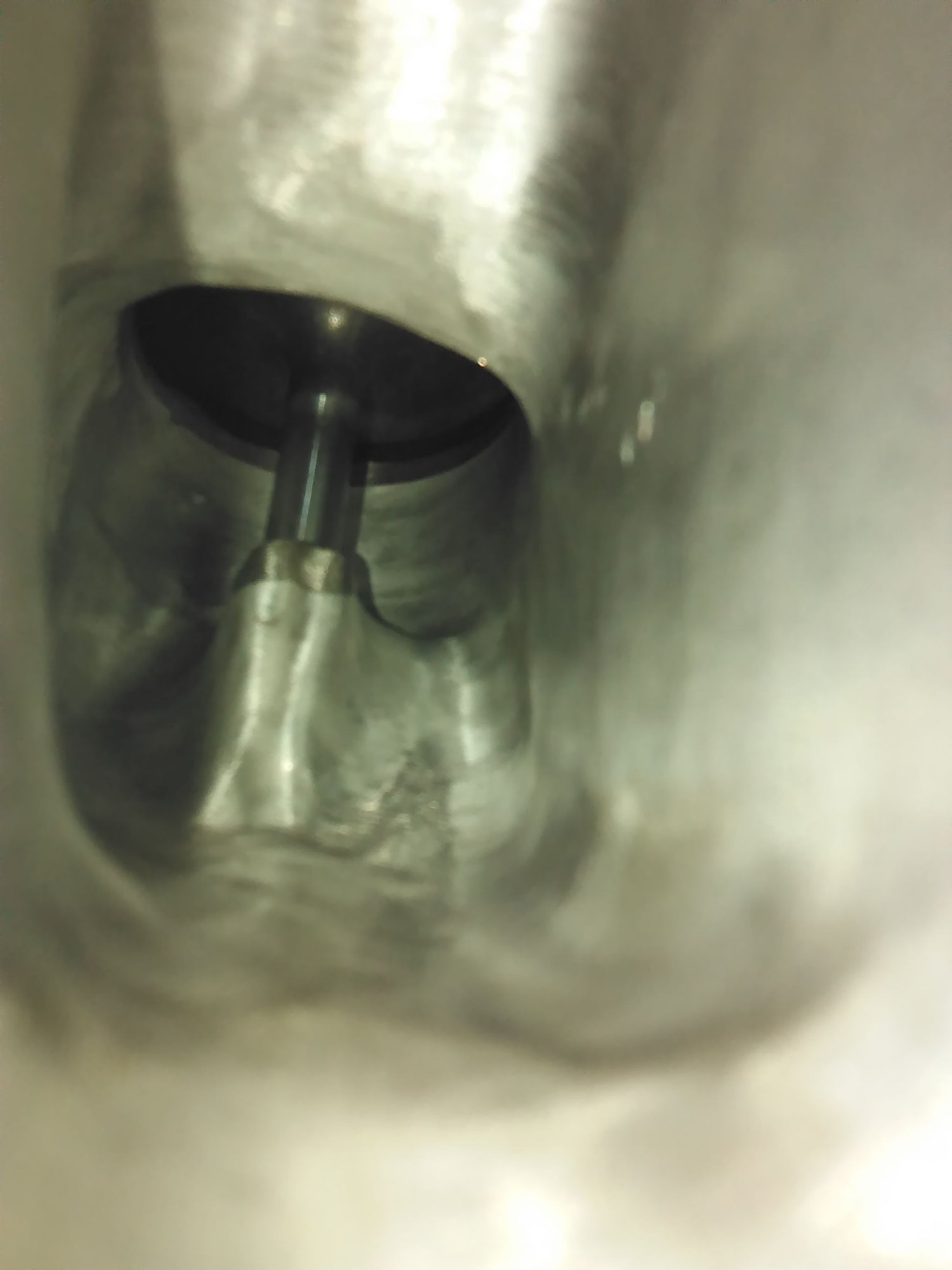

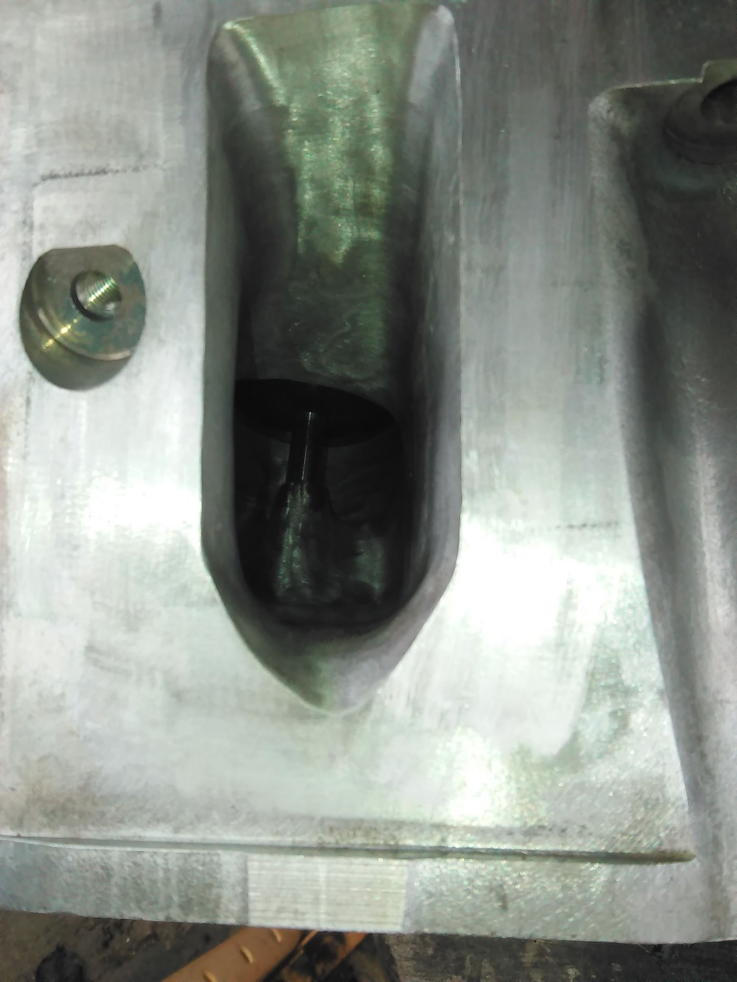

Hand Ported 243s by a guy named "Wuero" in Houston.

So does it look like he did a decent job on them?
Old Dec 22, 2015 | 05:59 PM
  #60
96capricemgr's Avatar
Posts: 11,975
Likes: 15
Pics can't show a good job and a job has to be really bad to see in pics.
