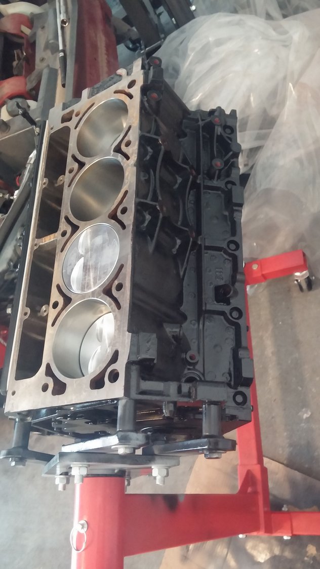

Oil pan doesn't leak, so we're good there.
Decided to paint the block black and got to masking everything.
Didn't turn out as pretty as I had hoped, but it's good enough.
Now to clearance the windage tray (I was told two washers will do) and oil pick up tube.

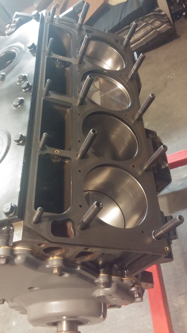

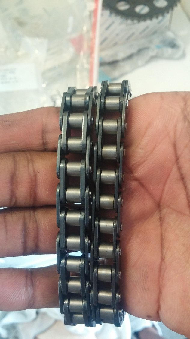

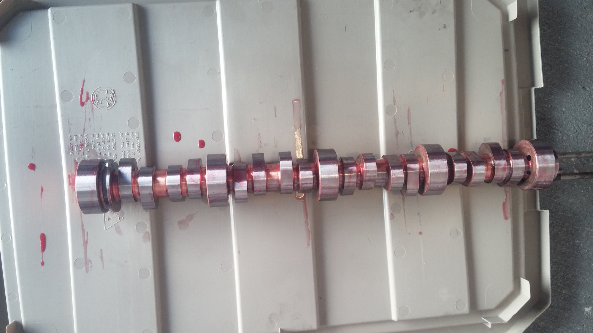

I got the woodruff key from the folks over at Manley, pressed on the sprocket and got camshaft and associated timing components on.
Noticeable difference between the ls1 and ls2 timing chain
Used two 3/8 washers and bolted up the windage tray without issue.Checked oil pan clearance and got between .28" and .30" after several measurements, so I'm good to go there, hopefully.
I then buttoned up all the covers and put on the head studs looking good so far! Next is to drill and tap for the alternator bracket and swap springs on the l92s.

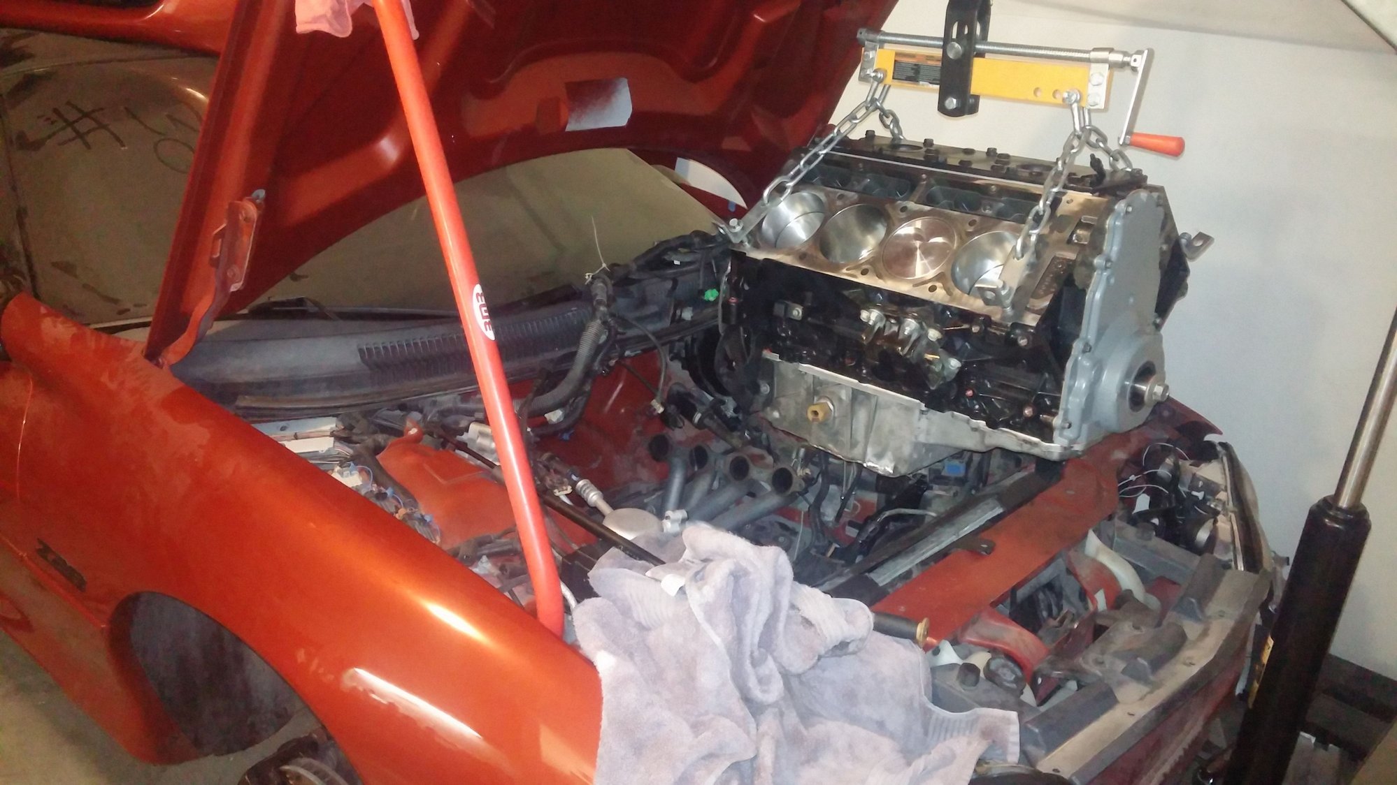

I got the motor seated and motor mount bolts in! It took awhile, but I had my girl man the engine hoist while I "guided" everything in. Now the tranny, not sure how I'm going to get that bad boy in...think I can muscle it up there with a few floor jacks?

I literally just did this with my 408 last week. I bolted the tranny to the engine and then dropped it in. Is much easier then trying to wrestle it under the car IMO. Then just drop it in all together and your done... You do have to pull the passenger side motor mount base to do it that way though. Once the bellhousing passes the mounting bolt holes you can go ahead and put it back in and then mount the engine. Wish I would have taken pics while installing engine/trans but I forgot :/

I agree with you completely. That's how I pulled it actually. I was concerned about the added weight of the iron block and my little harbor freight hoist. I needed a longer boom arm so I figured I would save myself the stress and drop the motor in separately.

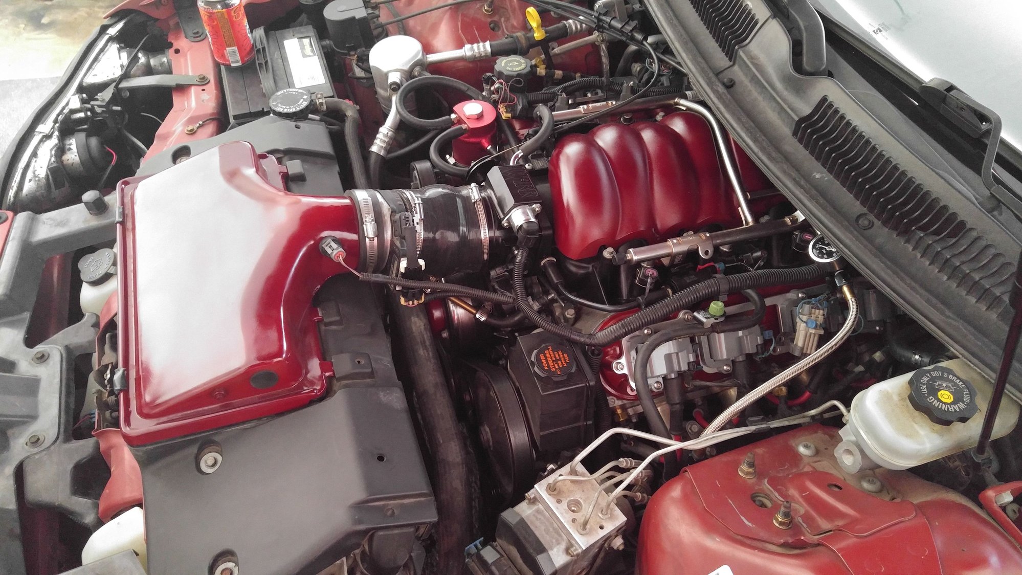

Finally got her up and running...had some issues at the beginning, but it was mostly dumb stuff on my part.
I've changed the oil 3x in less than 100 miles! I'm super paranoid, but hope I'm keeping the metal particles to a minimum.
I've gotten on it a few times and it's damn scary...Pat G sent me another tune after I logged a couple runs. More updates to come.

A few updates: I got the throttle opening at 100% now. Had to bend the pedal and use zip ties.
I took the car down to Victoria for some final dyno tuning (Mustang Dyno) from Pat G. The car maxed out at ~46x rwhp and about the same for torque, but I'm dissapointed in the numbers. Car feels really strong, but what do ya'll see?
Car drives well around town, I was expecting a bit more in terms of power.

460 on a Mustang Dyno is ~500+ on a dynojet.
