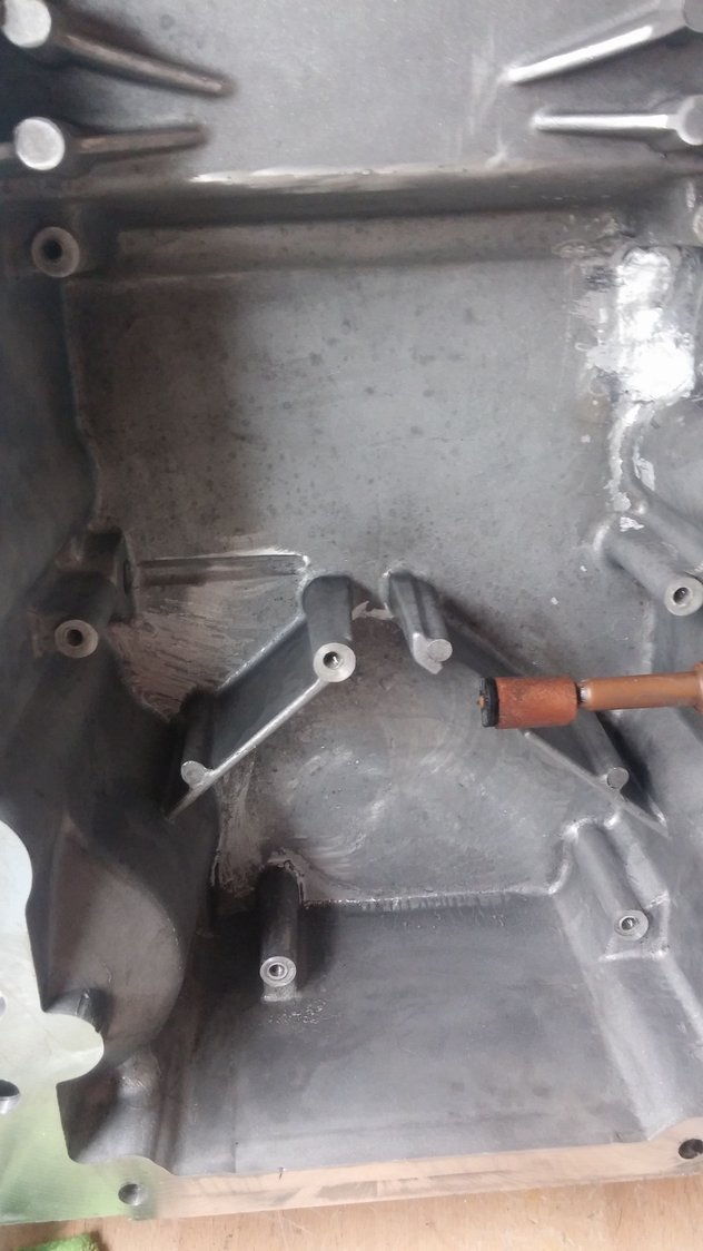

Welp, I got a call from G&G telling me I ordered the wrong size piston rings...so that delays the build a bit.
I noticed the inside of my oil pan had a slight crack in it. I'm not sure if it was from me or the previous owner, but I had my pops weld it. I later took a dremel to it to try and smooth out the weld. I'm hoping there won't be any issues.

There should be a key way for the sprocket so you can't put it on wrong. You press on crank sprocket until it stops or bottoms out. Make sure you use a key way. I would also fill your oil pan with water and let it sit for a while to make sure you have no leaks.

Water is in the pan as we speak, and I called Manley and ordered their keys for my crankshaft. A GM one won't fit.
