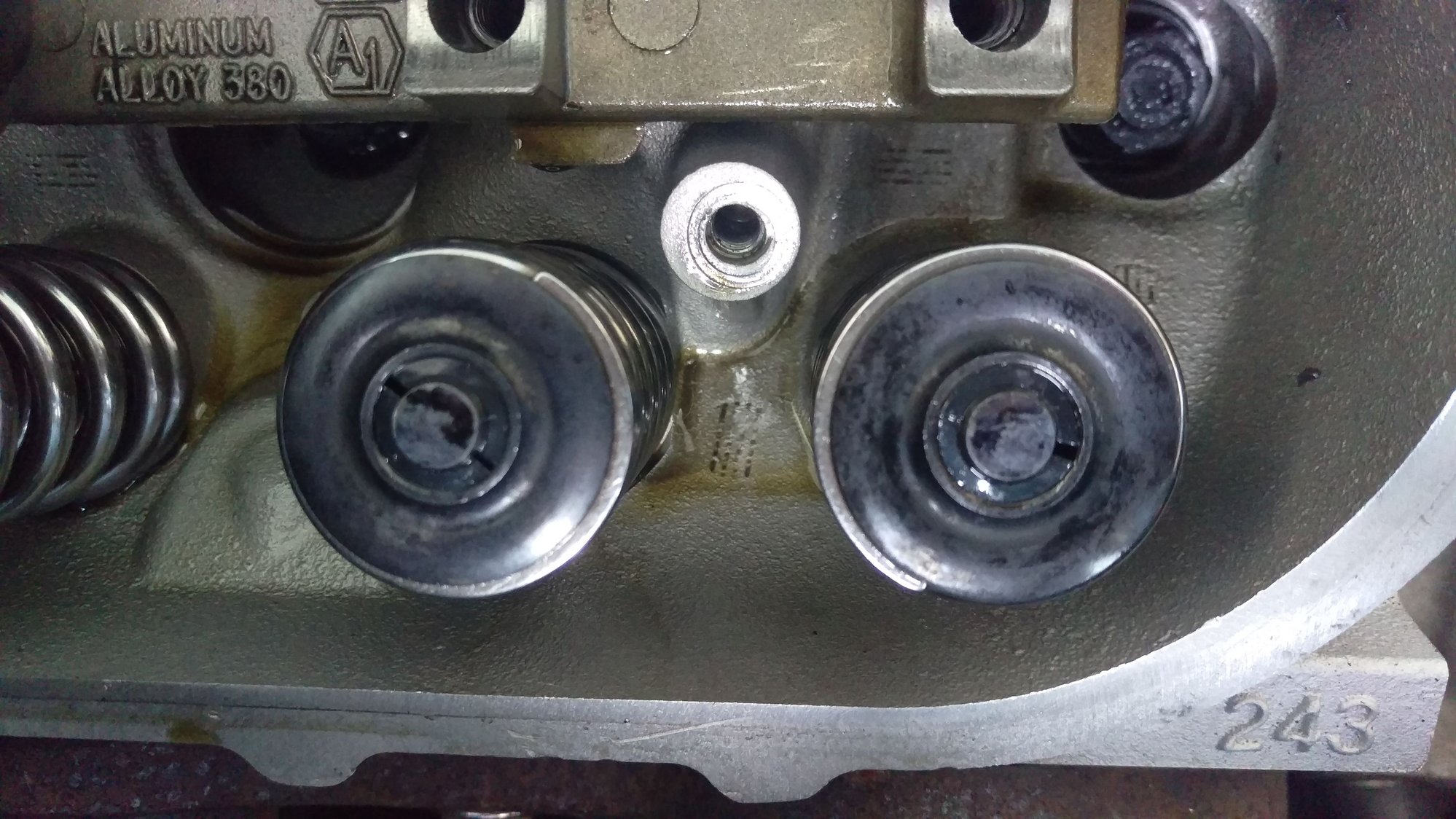

OK springs are 660 and stock rockers with truion upgrade . So I pulled it apart and we'll the truions have scrap marks on the bottom and checked to see where the rockers are pushing on the valve and not happy with what I see
Old May 2, 2016 | 05:13 AM
mngoos's Avatar
Joined: Sep 2014
Posts: 184
From: Albany,OR
Marks on the valves

Did you identify this cylinder as particularly problematic(moreso than others)? Did you bolt the rockers down the right way(with each cyl @ TDC)? Is that BTR springs? Are those the retainers that come with the kit? Steel? Can you post some pics of the underside of the rockers?

Springs came with the kit and yes those are the steel retainers that cam with the kit too

That wipe pattern is unfortunately rather typical of the stock rockers. Some of mine rode on the side of the valve stem as well.
