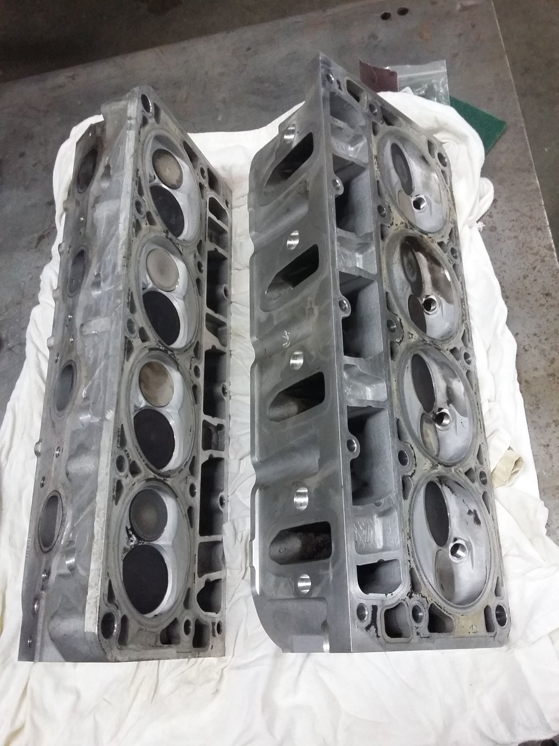

I finally got some heads from a local shop. 243 cast out of a 07 and 08 5.3. One has exhaust manifold broke off and the other is fine. I'm hoping after this week I will get the rest of the parts on the way.

243 heads (I smoothed the ports)
