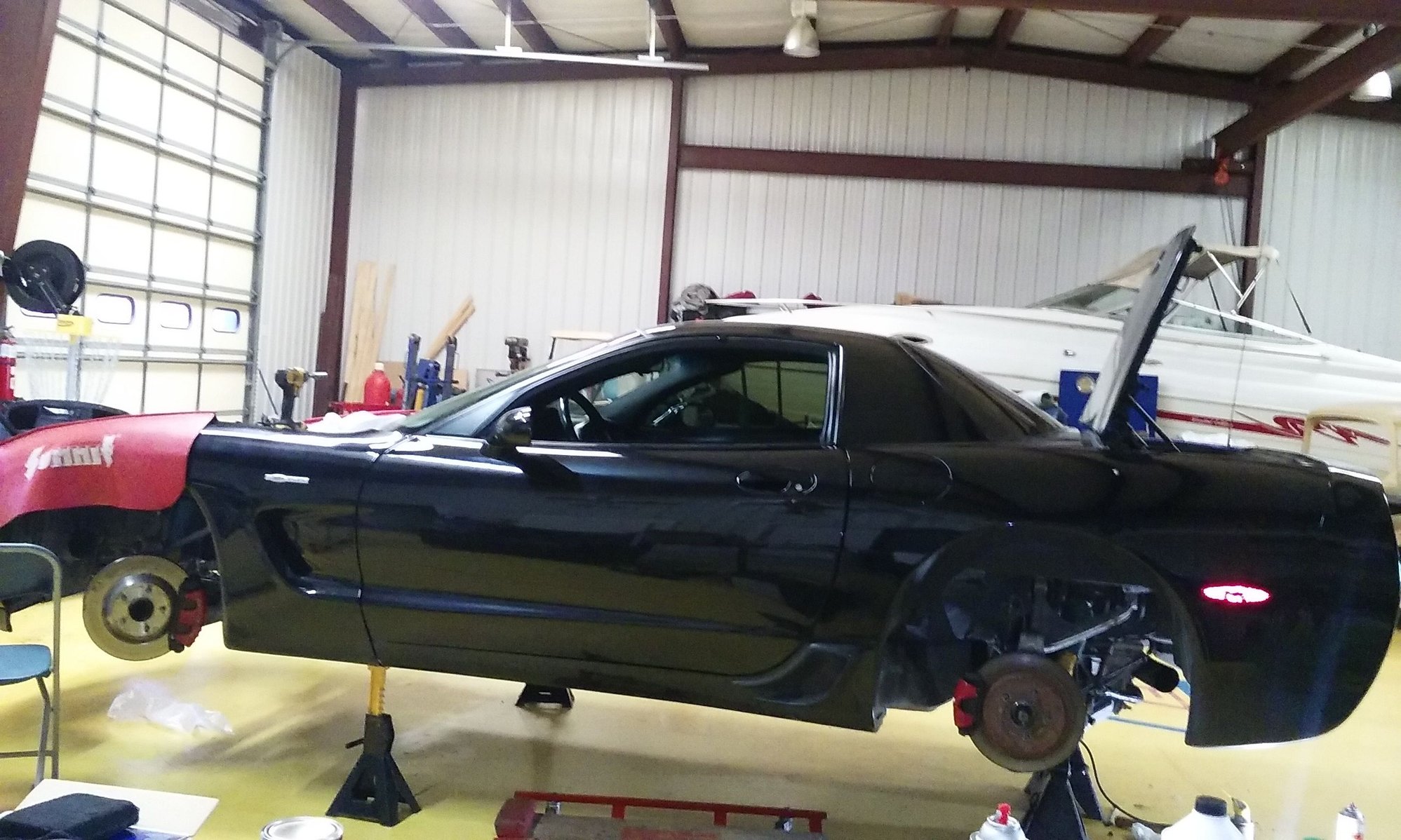

Just in case anyone was interested this is the car I'm working on, its a 2001 c5z. The cam is a btr stage 4 n/a.

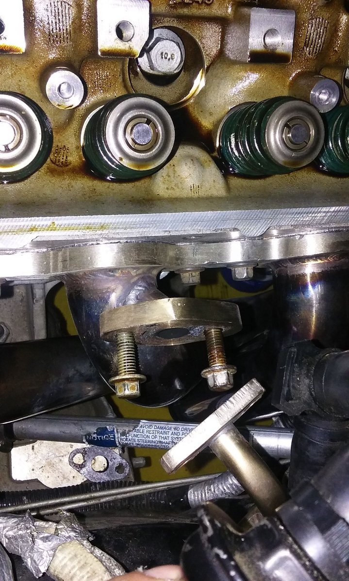

So this is were I tell everyone I'm an idiot.
The bolts had oil on them from sitting in oil on the table. Now to get this thing back together

Would have never guessed EGR people usually get headers that delete that LOL you haven't swapped out your Springs yet?
