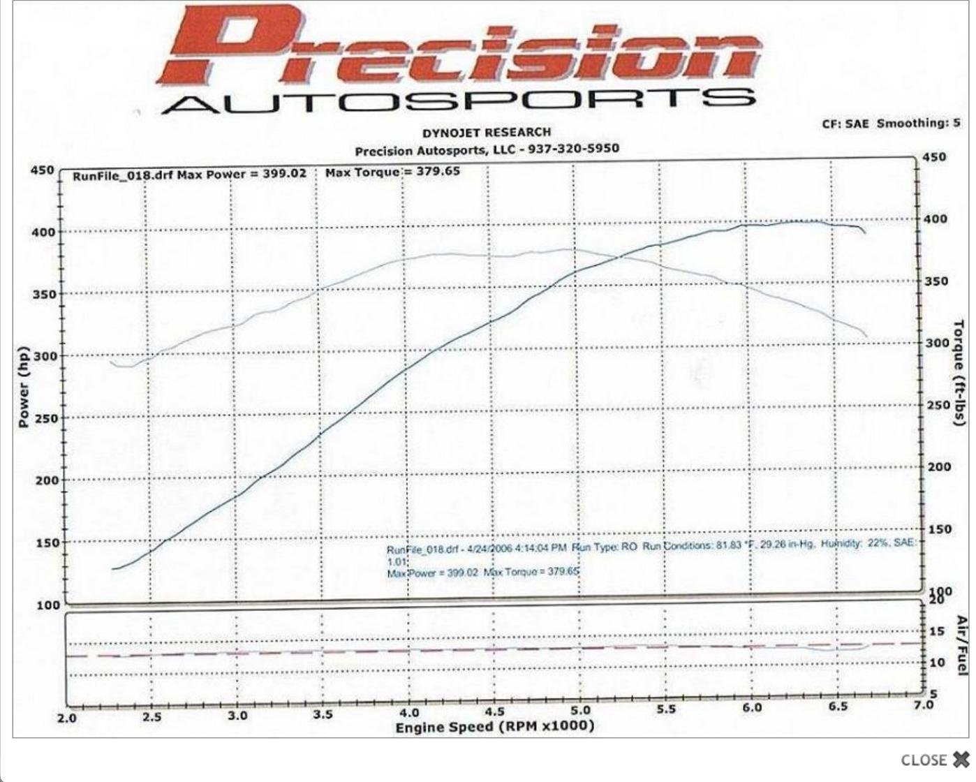

Here's a graph of a 230/224 on a 111. It just keeps pulling. This was through midlength headers with a cutout. I think the added duration will help crutch the top end, allowing enough air to keep things spinning. But at the same time, the early open and close of the intake valve will do a lot of good for the torque down low.
I'm far from an expert, but I try to rationally and logically think of the "how's" and "whys" and that's what I'm trying to explain here. Ultimately Trying to learn, not teach.
If my logic is flawed, or if there's an important point I'm missing, let me know!https://imgur.com/EHJTTzF

Thats a nice looking graph, what were the rest of the mods on that setup? Looks like it does carry nice, but also has less overlap and duration than your original post
