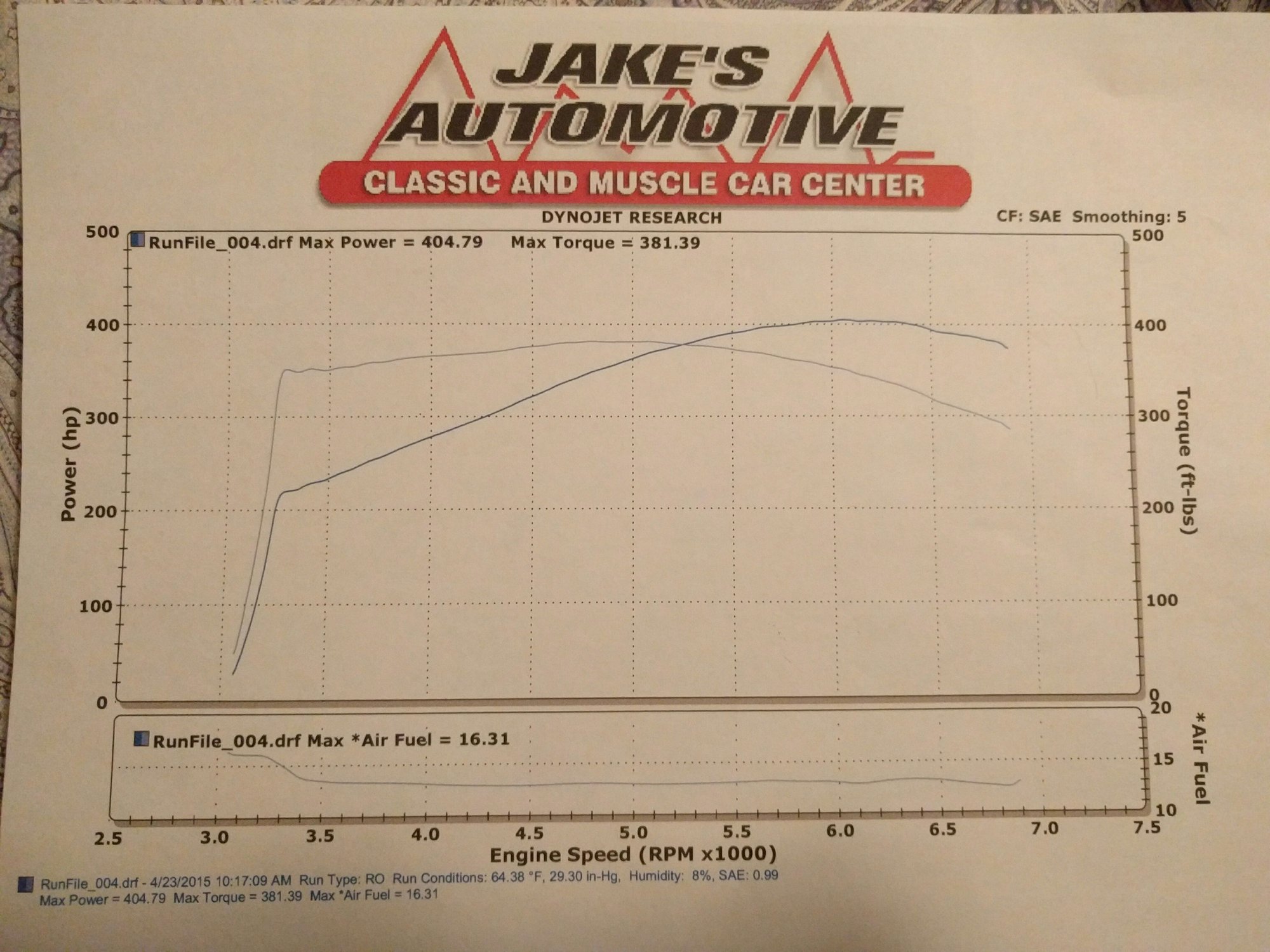

Reverse split cams definitely aren't the trend out there today, but they are proven performers if in the right setup. My cam is a bit smaller than yours, but very similar to one that was even more popular than mine in the early 2000's. I have the TR227, which is a 227/224 .569/.563 113.
The reverse split typically shines when in an intake restricted LS1, that also has a VERY good flowing exhaust. With that, if you plan on keeping your stock unported 241 heads and your LS6 intake manifold, I'd have no problem recommending the cam you listed. It should respond well to the added compression as well. If at any point you think you'll want heads or a new intake, I'd get with one of our sponsors on a more future proof option. I LOVE my cam, but it will be coming out at some point in lieu of a more suitable alternative for my future plans.
The only dyno graph I have available is a bit outdated, but will still give you a good idea of what you'll be looking at. I was able to gain and additional 17 rwhp and 10 rwtq on the same dyno with a ported TB, cutout, 25% UD balancer, and a new lid (Currently 421/391). This did include a new tune, which with the cutout probably netted the majority of the gain...especially considering the cam. Interestingly enough, the new numbers were on a warmer day last summer
**This was also through 4.10 gears in the rear, which has been known to suck up at least 5rwhp**

So that graph you posted was with what mods? stock heads, intake and just a lid on the intake side with longtubes on the exhaust side? Or did you have some head work done at that time?
If that's stock heads and intake, that's NUTS! How would you say the driveablity is?
Thanks for posting up in here and sharing your info!
That graph was with ported 853 heads, and all the mods in my signature, minus a cutout, bigger lid (which I didn't keep), ported TB, 25% UD balancer, ORY (previously catted), and a new tune. The things I just listed are what got me to 421/391. My 853 heads are not milled though, and I'm using the GM MLS head gaskets, so compression is factory.
