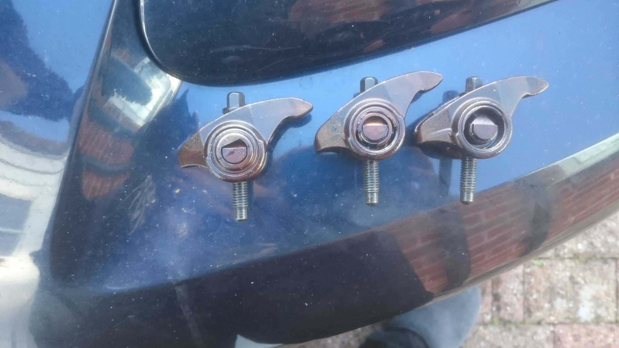

The good the bad and the ugly.<br/>Found 2 bearings gone, going to sweep the sump with a magnet to try and find the missing needle rollers.

Holy crap, if your engine has not yet blown up, you are a lucky man!

WOW. I'd keep your fingers crossed for a while. LOL. And chance of pulling the motor out and pulling the covers to have a look see?
