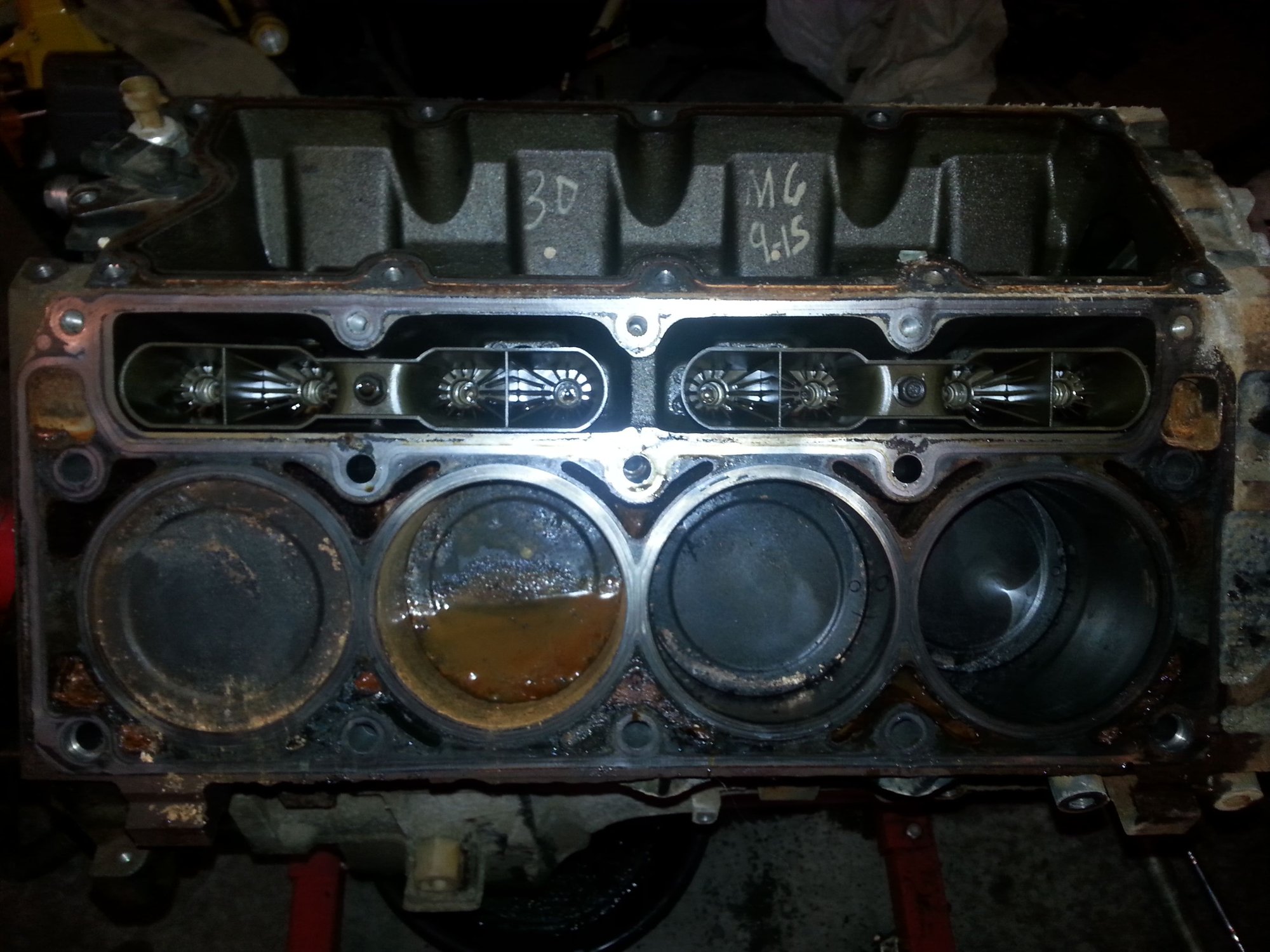

Waiting on moderator to approve post with picture of head removed atm.

After removing the passenger side head, I found a pool of liquid sitting on top of one of the pistons. The head gasket came off with the head as well(the driver's side head gasket stayed on the block and no liquid was pooled on top of any pistons. After vacuuming out the liquid (don't know if it's coolant or water with rust), I was able to freely turn over the crank using the crank bolt.
Based off that, does anyone know what caused this? Would that be normal for a blown head gasket or could it be the engine was hydro-locked?

Bump. Picture finally uploaded. Anyone know based on that picture if I'm completely screwed or if a complete rebuild should suffice?

I would just disassemble it and inspect the pistons, rods, bearings, block, etc. No way to really tell what kind of damage (if any) has been done without a complete disassembly.
Ok, figured I was jumping the gun on conclusions. This is my first build so I wasn't sure. I just have to get the damn crank bolt off now so I can pull the dampener and flexplate and rotate the engine.
Thanks again for the advice.

As mentioned at this point you need to disassemble to check condition.
It's likely the rings are stuck from moisture and sitting so long.
If I had to guess, Judging by the rust an build up in the cooling passages, I would say the previous owner didn't take care of the cooling system it likely ate the gasket and over heated it Thus causing the issue you see.
You may be able to re-ring, hone the block and replace the bearings if there is no pitting and get it back into running order.

Thanks for the info. I should be completing disassembly this weekend to check the RA and block. It would be great if it didn't need an overbore and I could reuse the stock pistons/rods minus rings/rod bolts/bearings. I don't feel any ridges in the cylinder walls, but my fingers are crossed the previous owner didn't run the crap out of the engine with overheating issues enough to crack the block.
