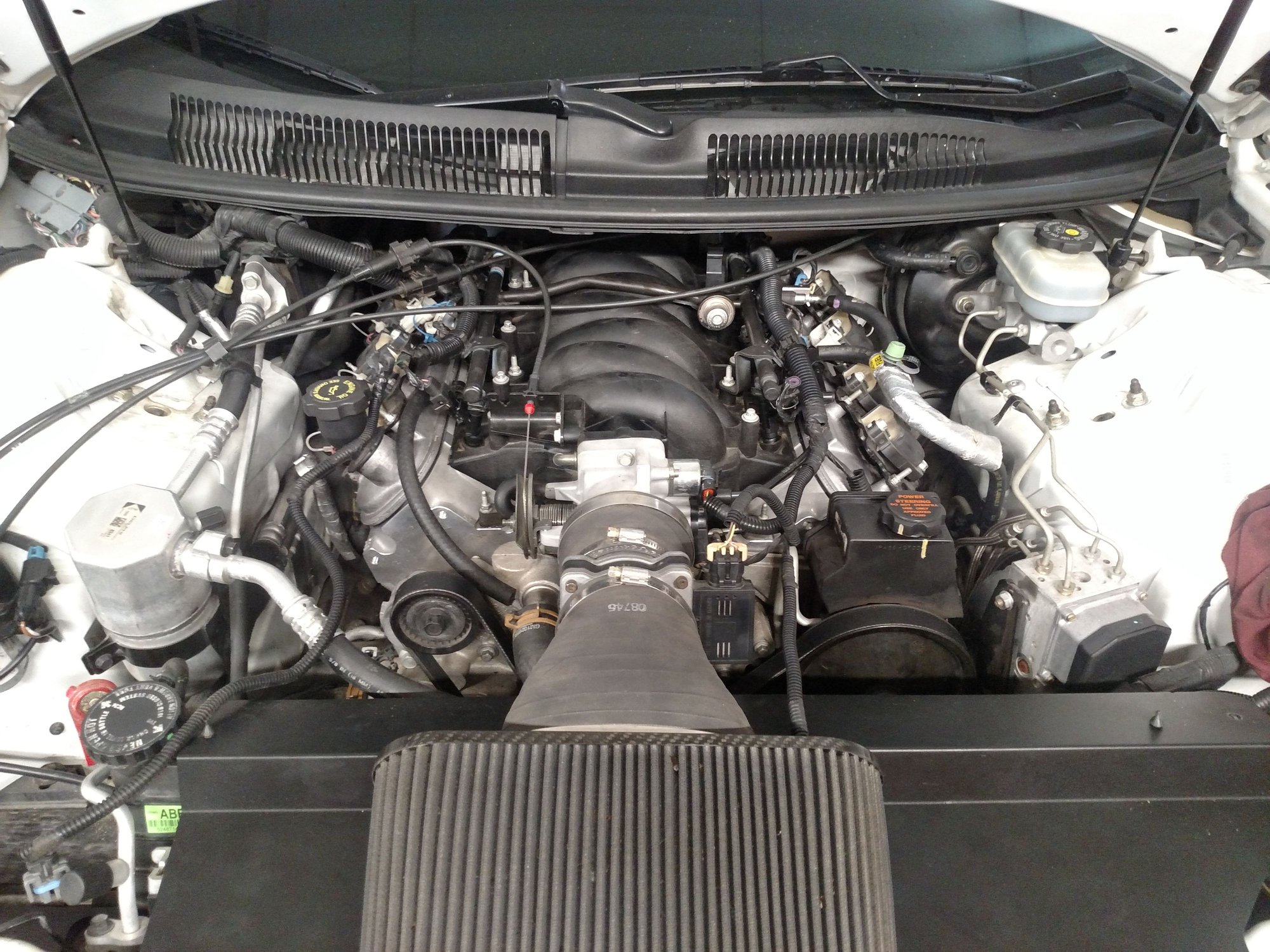

Alright looking for some guidance.
So a quick recap about the build I'm putting together. It's a 227/235 .620/.610 cam which I was told clears on stock applications. I sent a set of 241 heads to have the 219hcr package done on them. BTR springs, Morel drop ins, stock MLS head gaskets, straub bushings, and push rods came out to 7.325". I was torquing down the rockers one at a time today and ran into some trouble. This is my first time ever putting together an engine so I have ran into some speed bumps along the way.
The problem is when I was bolting down the rockers I was doing them one at a time. I would spin the motor over by hand until the push rod cam down to the base circle and then i would torque that one down and move on to the next. Well I got to the 4th from the last rocker and I was turning the motor over by hand and it got very difficult to turn so I stopped (plugs are not in). I got up above the car and noticed two exhaust valves open. Said OK and went under the car and spun it in the opposite direction and it got very difficult again. When I cam up above the car this time two other exhaust valves were open.
Should the motor become tough to turn over by hand or does this sound like a valve contacting a piston? I did not measure my PTV clearance as I thought the cam wasn't that huge and others have also thrown it right in.
What do you guys think?

To me, that sounds like piston to valve contact. And I think it is time to fly-cut your pistons.
Anything over .620" is a pretty big cam. I don't think the stock rockers even maintain proper geometry much past that point. So it doesn't surprise that there may be PTV issues with the 219HCR heads.
Don't worry and don't force anything. Just clay the pistons and measure/check PTV clearance. Fly-cut as necessary.

How easily should it roll over? I had the wife come out and tell me exactly what the valves were doing while I was under the car. Idk if I put a little more a$$ behind turning it over or what but I turned it a whole two revolutions. I am on my back with it right above my face so I wasn't giving it the all by no means.
Without plugs in should it feel no resistance or are there moments where you will feel slight resistance ?

Ok I just had another thought...would I feel quite a bit of resistance rolling the engine over and pushing a lifter into its tray(no rod or rocker on that valve yet)? I was only turning it over with like a 10" ratchet.
The lifter thought came to me because once I went back to it after a break and got over that tough spot the engine spun over a few times no problem.

I was pry just being too paranoid. I went back the next day and gave it a little more umph and it spun over a couple times no problem.
