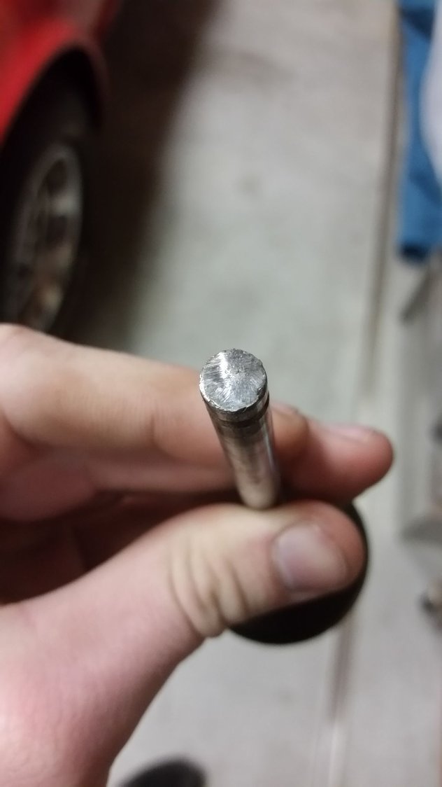

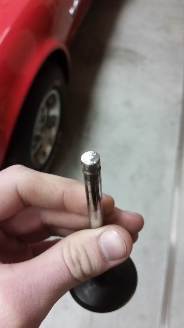

Hey guys, I have a set of LS6 valves that were damaged due to a failed oil pump. I am planning to repair them by grinding the tips, but I am worried about going through the case hardened layer. If that does happen would I be able to use lash caps? These two are representative of the rest, and there is no other damage to them. Hey everyone

Do you have one not so damaged? If so, look for a very small line around the exhaust valve tip down about 1/16" or so. If I recall, the hardened tips are welded on.

realize that with altered valves you might end up needing two different length pushrods.
I've always been under the impression that these valves are case hardened.
Both intake and exhaust valves are damaged. I planned to machine them all to the same length.

From: Conroe, TX
A machine shop should be able to repair that if the damage isn't too deep. My local shop will grind the 45 degree seat cut on the valve and grind the tips for a nice straight surface whenever they do any valve job. I've had it done on several sets of LS valves and the hardening is deep enough to grind. It may be one of those things where you just have to try it to see if it cleans up.

You could also check some of the head shops (e.g., Livernois, etc.) to see if they have take outs. They did have the light LS6 valves at one time, but I think those are getting rare these days. But upgraded heads with larger valves results in a stock set of valves on the shelf.
