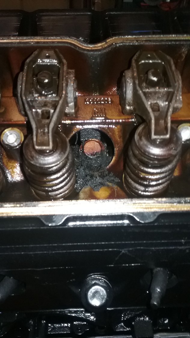

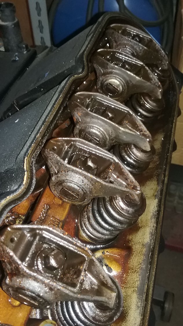

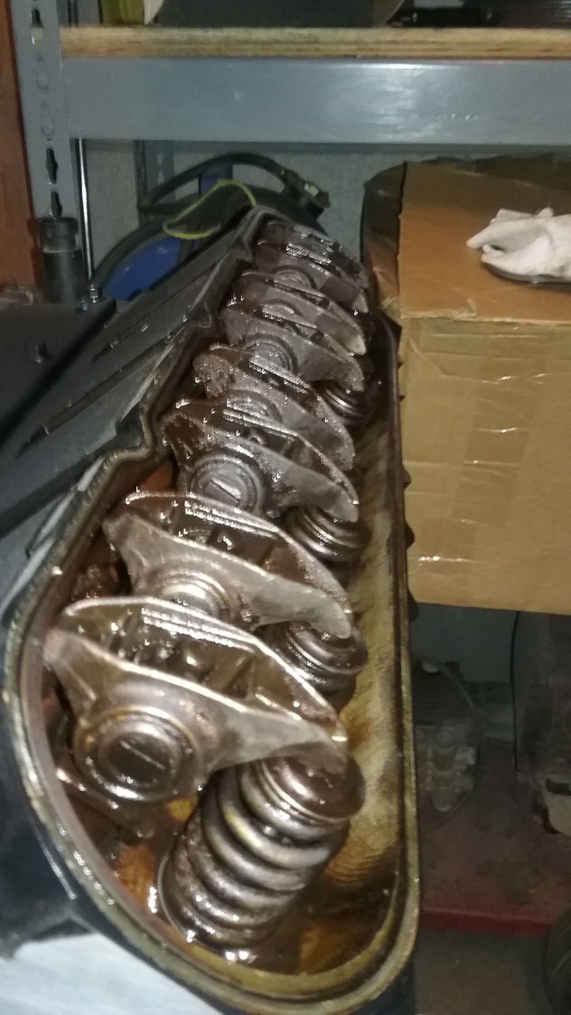

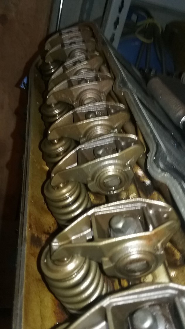

Heres what it looks like. Over reacting? Deffenitly coolant .what do you think? Thanks
Other head looks much better

Are they castech heads? If you pull the rocker assembly off of the head with the coolant in it, there may be a casting mark shaped like a AA battery. I believe they leak around the area where the head bolt boss is cast. Worth looking. If it were me and they are castechs, pitch em.

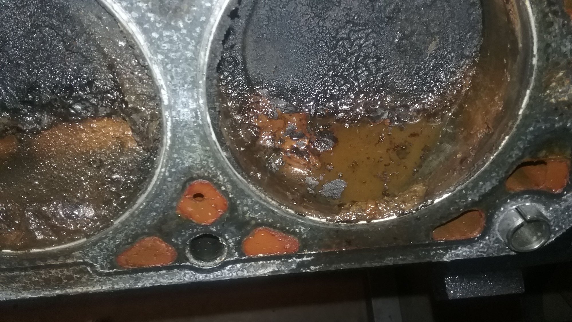

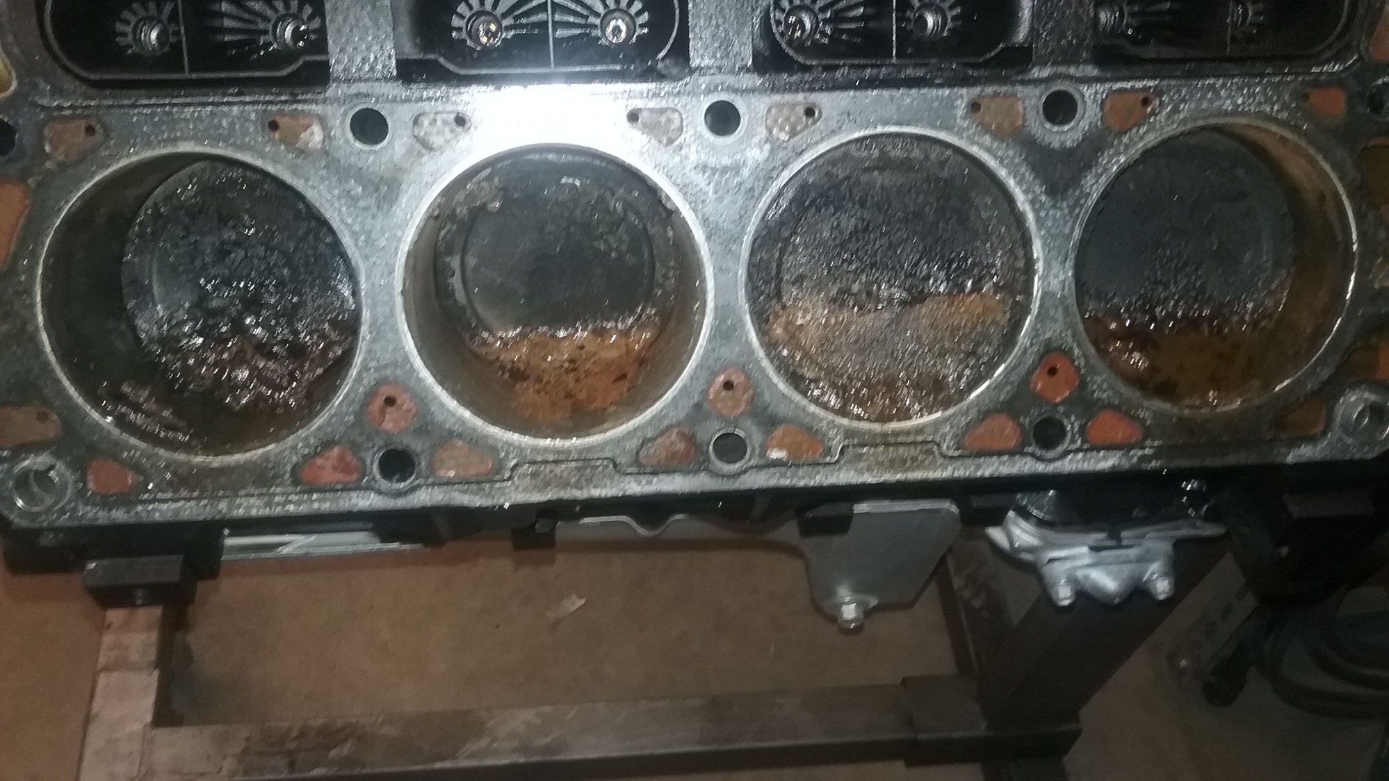

Nevermind! I freaking hate liars and thirds! How could you do all this to deceive someone into a wreck? A-holes!!!!!! Looks like my plans have changed **** goddamn can't catch a break this life, maybe next.

Similar to one of my experiences. Bought an LM7 from a guy on here and when I got it and looked it over it was junk. Guy said it had 100k on it. the block on the outside was rusted to ****, and when I pulled the heads it looked similar to what you've got going on there. 4 of the cylinders were covered in rust and had a pool of water in them. Thank god I didn't run it. Guy never returned any of my messages. Learned my lesson though. Next time pull the heads to inspect before you do anything.

yikes. you might be able to save the block. if that much water was in the oil the bearings are probably beat

how far over can these bores go? If this was a gen1 it would clean up at.040 if it's not cracked somewhere from heat. That's the thing the lower end looks ok, it got real hot you can tell and smells like a dead superstock motor and I'm sure it need bearings but it doesn't look as bad as the cylinders. I got a quote of 2200 for a stock partsrebuilt long block locally. Is it worth it? Nice to know at least it was actually done. Any other advice on reputable machine shops or used engine shops. Ism about ready to just buy something I can trust.
if you got the dough, sure. my next step would be to put that thing through the living room window of whoever sold it to me and then buy another pullout. just make sure it spins over easy. you can also peek in the bore through the plug hole with a pen light.
people take them the ~.100 with sonic checking so .040 is probably fine.
