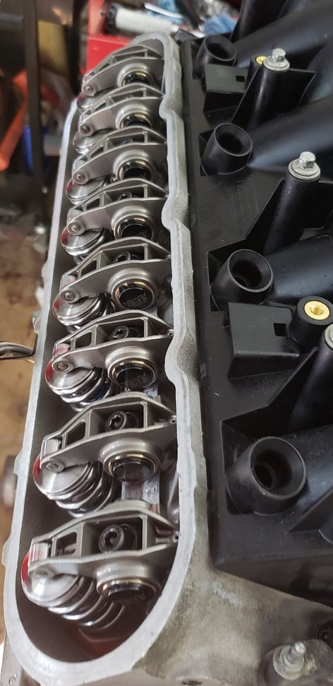

Old Nov 21, 2020 | 09:56 PM
Jalopy Nation's Avatar
Joined: Nov 2020
Posts: 15
Default Must do trunnion upgrade
LS3, 68 camaro trunnion upgrade
