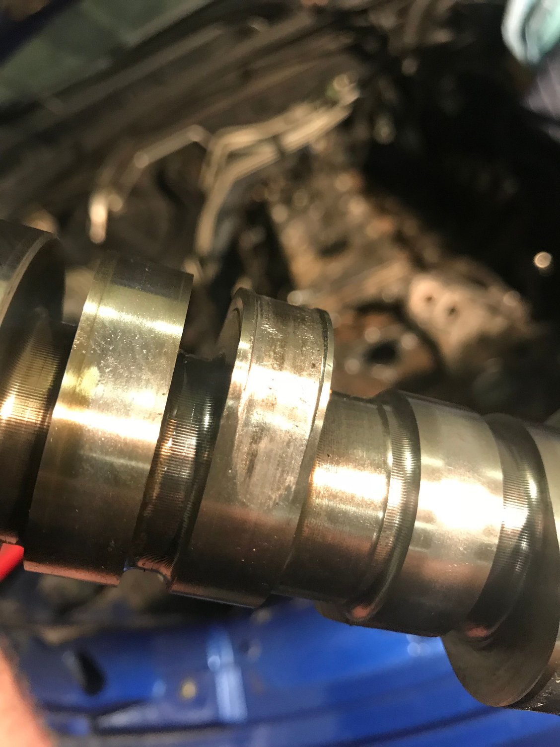

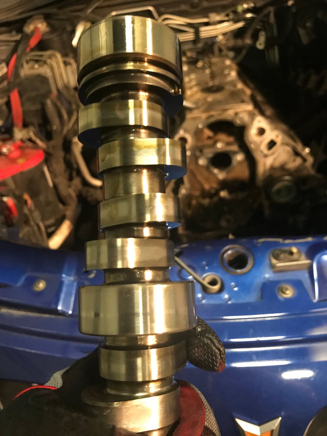

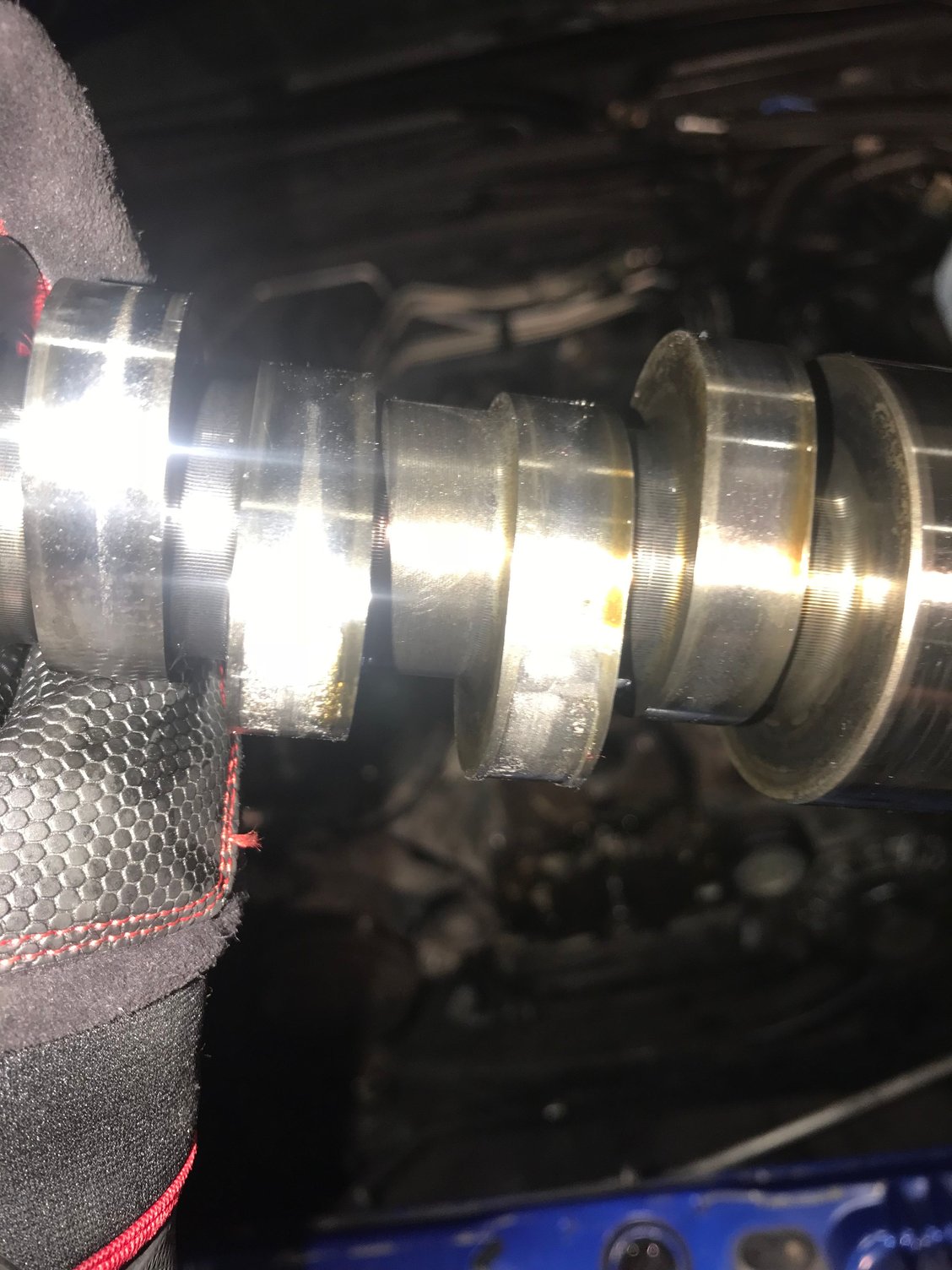

Finally got around to tearing it down. Looks like some lobes got chewed up. I guess 10 years of high lift will do that. Bearing surfaces seem ok though... thoughts?

That looks bad! Bummer!
Do the lifter rollers roll smooth? You have to put a little pressure on them with your thumb when you roll them to see if they feel smooth or if they are rough. What we found on our high lift cam issues were the needle bearing would go bad and the roller would skid on the cam lobe causing a squeak the sounds like a belt squeak.

all but 4... the lifters associated with the damaged lobes had pitted rollers, they rolled but squeeled when I ran them across my arm.
Talked to some friends and we are thinking replace oil pump, timing chain, lifters, cam, oil, oil filter, and inspect and possibly replace rockers when I pull engine out to put clutch on. Bearing surfaces seemed good and I’m looking into your products as well

Ya, all that hardened metal particles will be in the lifter needle bearings. Need to replace all of the lifters with the new cam. The timing chain to since it would be hard to thoroughly clean it. The pump could be cleaned if it looks good when you open it up. Make sure you clean the pressure relief valve in it.
