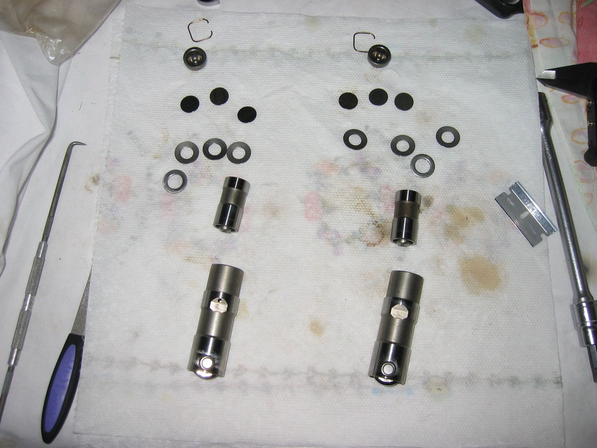

Do you have your old lifters that were in the motor from before? You can make a solid lifter to do the job, I have some photos if you have the lifters.

Pull the snap rings on a couple of the old lifters and get some washers to fit inside. Just add enough washers to make the old lifter solid. I seem to recall that a couple of washers had to be filed thinner to get a good tight fit of the snap ring so there was no slop in the lifter. You might be able to use shim stock as well, goal is the reassemble the lifter so the lifter cup doesn't move.
This shows the washers I added along with the lifter internals.
View down the throat of the disassembled lifter.

That is a great idea for a testing lifter! Thank you for posting that!
Are there washers inside of the lifters?
No, those are washers I added to keep the plunger from moving and thereby making the lifter solid so I could check PTV, degree the cam, etc.
