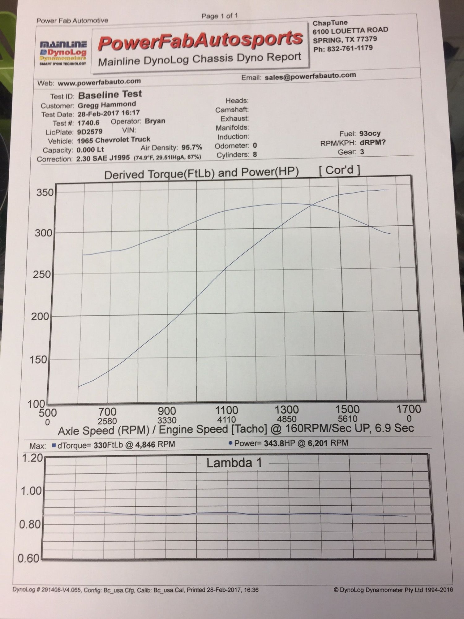

I have one of the Summit blocks and have no complaints. Mine is what I consider mild. L33 internals, 243 heads, TSP 218/218 550-550 111, Speed Engineering’s long tubes and Circle D 278 converter. Makes 343 rwhp.

Old Feb 22, 2019 | 09:51 PM
gregg.....do you know what your compression ratio is at?....l33 that's flat tops yeah?......awesome engine bay....I did a lm7 with 4.8 flat tops...and 64cc heads with asa cam in a 68 c10 and I'm really pleased with the outcome as opposed to the 220 cammed lm7 that I have in my nova.....the truck with the flat tops and asa cam just seem so much more powerful. .....hard to think that that the flat tops and asa cam are really that much of a difference, but my butt dyno seems to think so....
