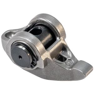

Has anyone used these rockers? I saw them on rock auto.
Melling also has one listed as well.
MR1341
both about the same price.
Upgraded trunnions in them and hardened pivots.

I'd stay away from the bearing rockers and go with the bushing type like this. I've used both and will not use the bearing rockers again. This is what I used

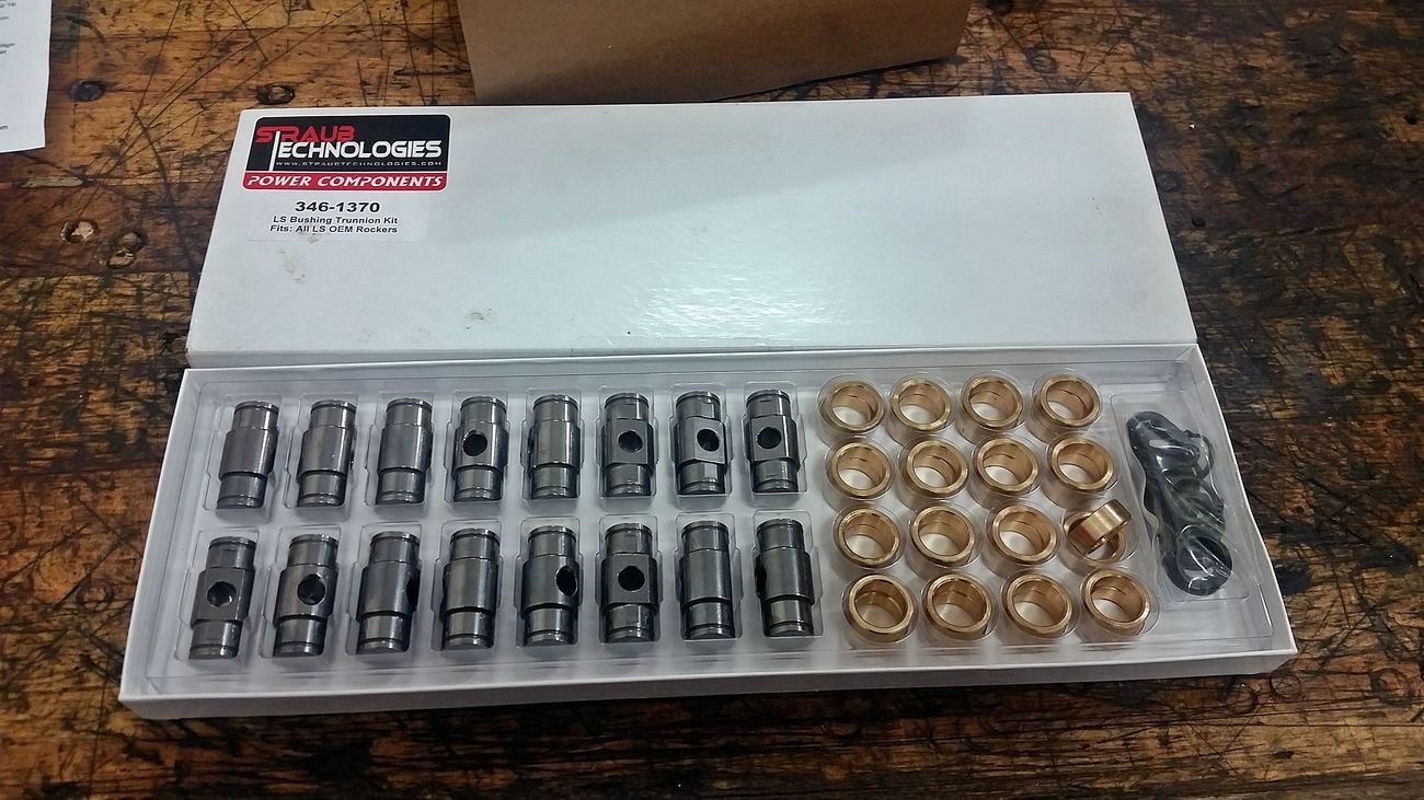

I have 1.....ONE, that I bought to replace 1 that overheated from a lifter failure. It looks just as good as the stocker and seems to have a slightly larger body. I am doing the straub upgrade to all the rockers so as long as the housing is good I should be set.

You can buy a full set of new GM for around $90 - 100. The Straub kit is around $200 with the bolts. You can get a set of new GM with the kit already installed for under $300... think of that as buying the parts and getting free labor.

Just did the CHE trunion upgrade on a set of stock rockers. I would look around for a set of used stock rockers. It took me about 2 hours to press out the old bearings and install the CHE trunions. I think it was worth the money and time.

straub will test the rockers before rebuilding the rockers with their trunions and bushings. i would get a good used set and send them in. worth the extra piece of mind, imho.
