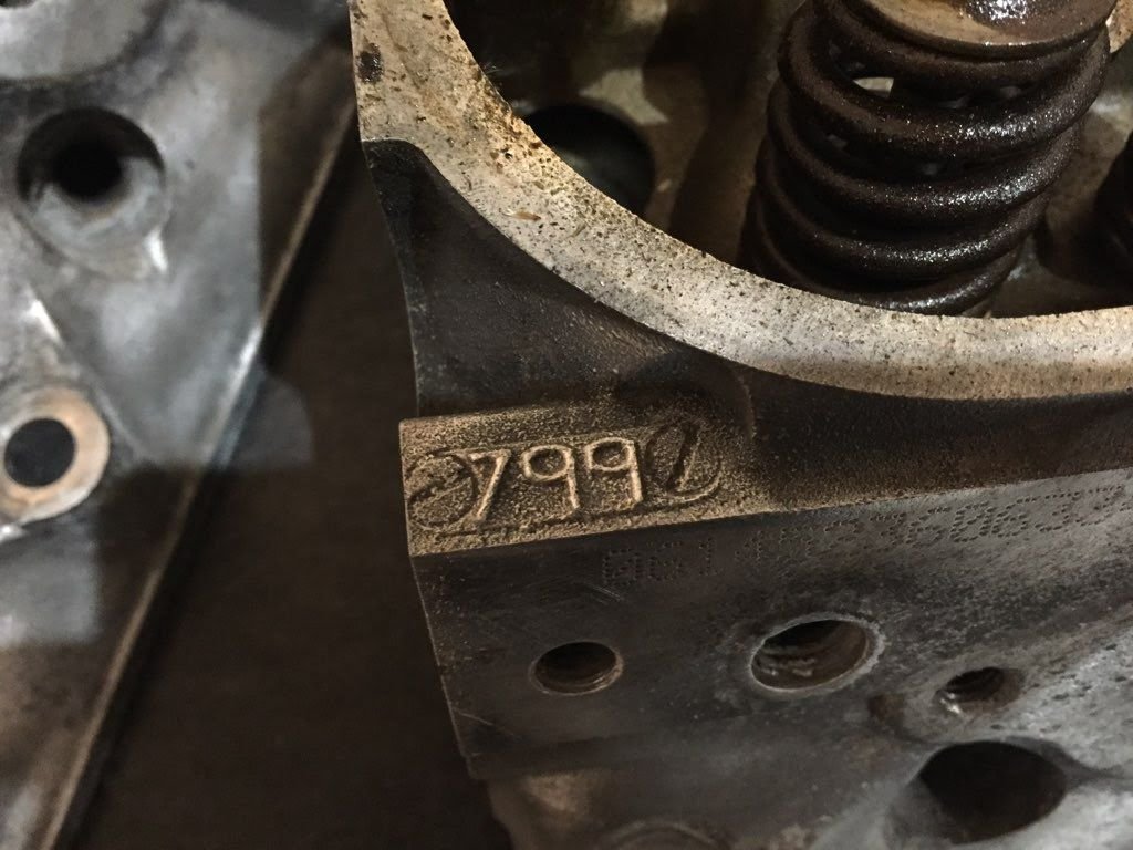

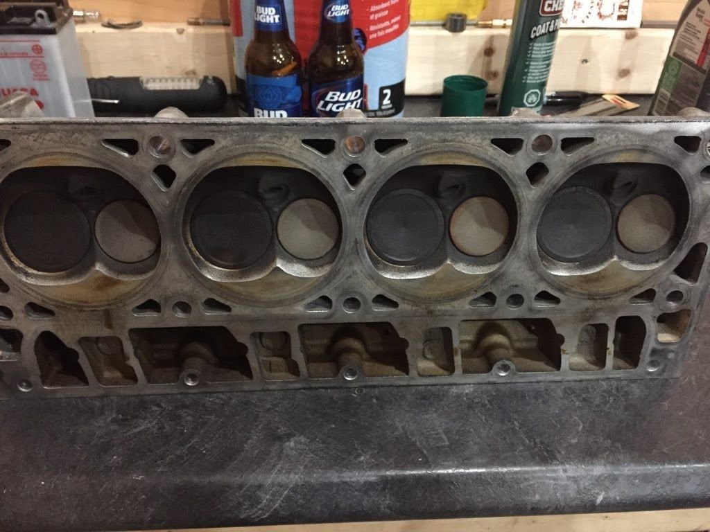

Good morning. Finally getting around to finishing my parts list/install (can't get headers to slip in worth s*** lol) but its coming along well. I took a set of 799 heads I purchased off of here up to TEA (in tallmadge, OH. local...) to be resurfaced, no porting, and check the valve seals. Wanted them stock but cleaned. Long story short... after about 1.5 weeks, I get a call stating that I need to buy another set... They said that they are corroded beyond their repair and appear as if they have soaked in water for weeks. Stated I should either find another set or figure out what I want regarding the head swap...
When I received the heads, I cleaned them with simple green and dish soap with a bottle brush to clean the ports as best as I could, there was oil residue in there. Is TEA giving me a fresh line of B.S. or am I holding onto $400 worth of scrap metal?

Tough to tell from your pictures, but if there is too much pitting on the sealing surfaces then that might be why they are no good. TEA is well respected on here, I'd talk to them and get more details.
What specifically is corroded beyond repair???
If it's the valve surface sealing area, They would have to replace all the seat's. That's not cost effective Vs. another good set.

Are you sure he said seals ........ and not seats ? Your going to replace the seals anyway . Now I can understand all the seats be corroded to point they can not be regrind .

I doubt he said the seats were corroded. All of the aluminum would be gone before the seats would begin to corrode, especially to a unusable condition. The valve stem seal area is most likely pitted badly where the I.D. of the valve seal contacts the head.

The seats are replaceable, but you’d be in those heads pretty deep money wise.
