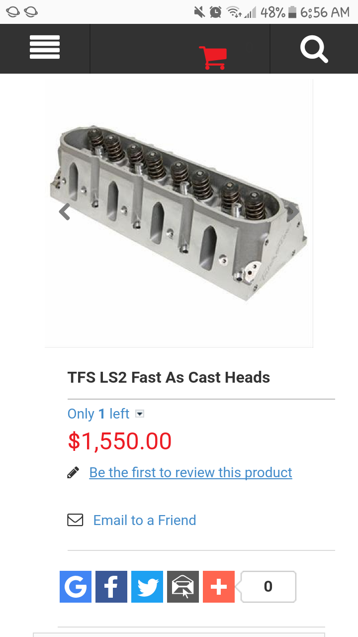

Listen to Navy.... you can just about buy a set of TFS as cast heads for 1600 dollars.
you mind sending a link cuz I cant find any less then 2k lol. I have the springs rockers and seats and i have a set of Manley 2.02 and 1.57 valves already
Old Apr 9, 2018 | 06:55 AM
Tuskyz28's Avatar
Joined: Sep 2014
Posts: 4,893
Likes: 706
From: Mississippi
Old Apr 9, 2018 | 06:57 AM
Tuskyz28's Avatar
Joined: Sep 2014
Posts: 4,893
Likes: 706
From: Mississippi
Briantooleyracing.com
Old Apr 9, 2018 | 08:12 AM
Philhippy45's Avatar
Joined: Mar 2016
Posts: 458
ok great found them. But if I want to use ls1 rockers with the trunion upgrade dont i have to have the powdered valve stuff or will the stock bronze be ok?. And what cc would you recommend?

Your CC size choice your pistons of choice, head gasket thickness, your desired compression ratio, etc...
