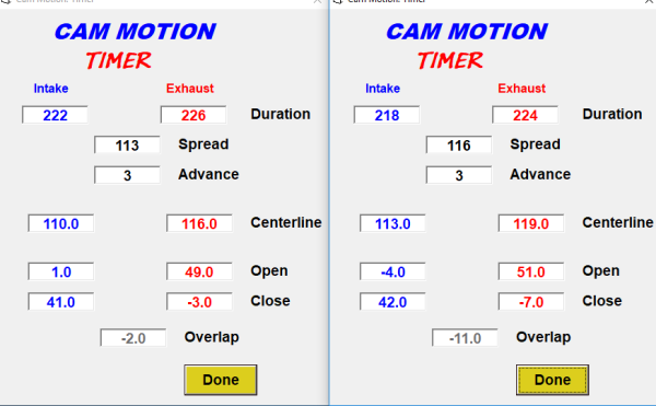

Originally Posted by kbronSS
222/226 597-598 113 vs 218/224 553-553 116+3
Far from a cam expert. I’m basically looking for a DD cam that I can drive without needing a stall. Drive Traffic, be able to go on trips also. I might do a small stall later on but I don’t want to be forced into one. I was looking into the 228r but not sure if that would be too big. All I’m gonna do to the car is ls6 intake/lt’s/lid/243’s and a tb(don’t know which one yet).
Hello KbronSS,
Those two cams are both very mild. The difference between them is what we call "overlap". This is the period of time that both the intake valve and the exhaust valve are open at the same time.
What that means for you is that the 222/226 on 113 camshaft will make more power, but have less idle vacuum and will require a more expensive valve spring.
The 218/224 on 116 camshaft will make less power, but drivability and idle will be just like stock. It will have near stock idle vacuum and use an inexpensive GM performance valve spring.
So, it just depends on what you want. The 218/224 on 116 camshaft is typically used by those who are doing a rebuild or repairing a failure as a nice step up. It is only about 20HP stronger than stock, so not sure if it is worth all that work for just that much power gain.
For guys who want to maximize the stock torque converter, I have ground a 220/226 on 114+4 with .595" lift for them. It makes good power and does not fight the stock torque converter at idle.
But, like a lot of guys have said, a higher stall torque converter opens up more possibilities. It just depends on what YOU want for your car.
