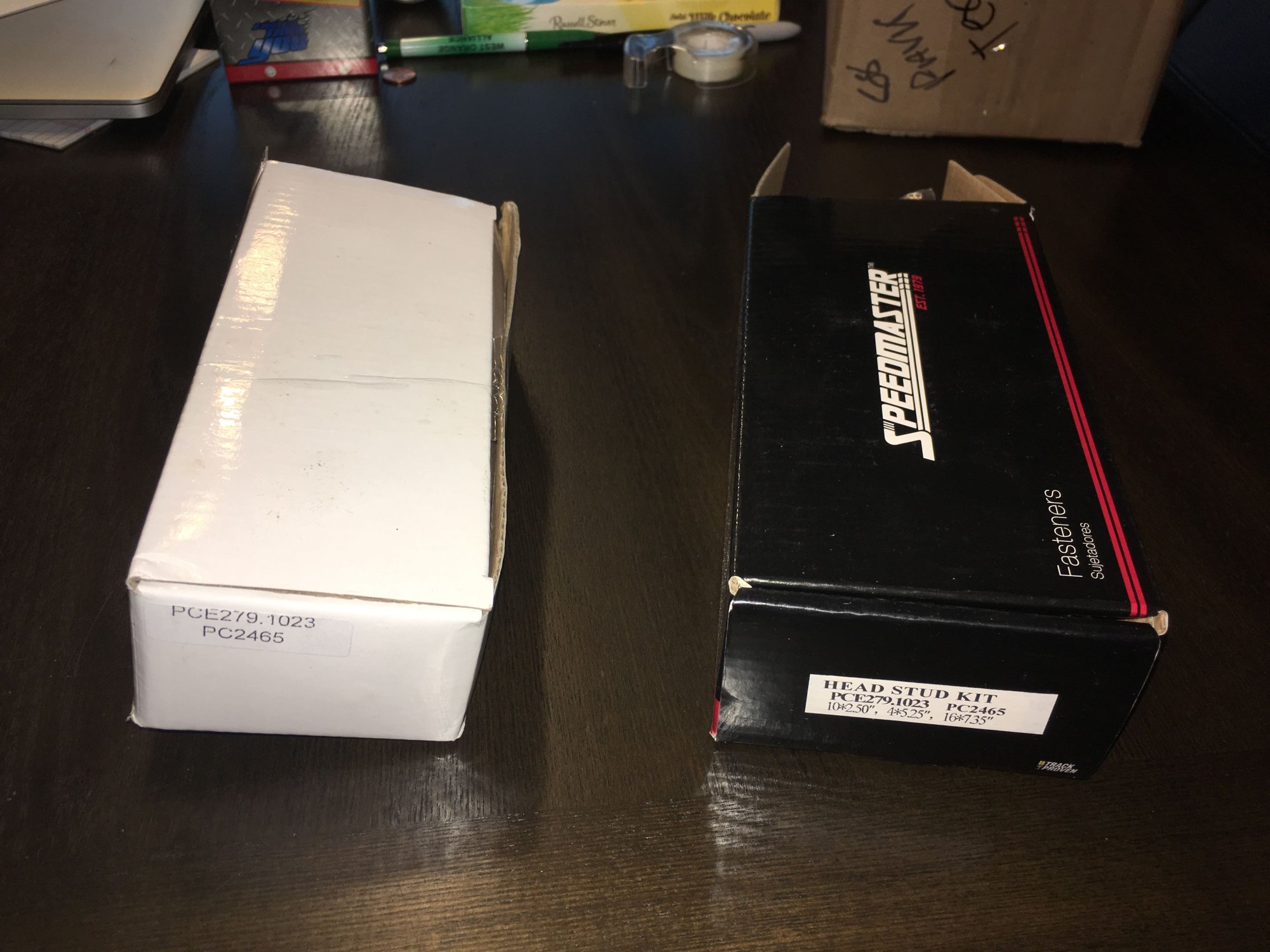

Well I got the replacement studs today and there is a huge change in packaging and what looks like quality. I opened up the new studs and threaded one in the block and it threaded right in by hand. Verified they are all straight and all the studs, nuts and washers accounted for. Only a few of the medium length studs have rust on partial threads that I will clean up with a wire brush.
Im only going to tq these to 65ftlbs final and do it in 3 equal steps.
Here are a few pics for proof. Original box is plain white vs new box. New stud is on the left, original incorrect thread on the right.

Hi BB, I find it VERY ODD that a "white box" packaging was sold/shipped by Speedmaster !
This is WHY I started the Counterfeit remarks as Speedmaster ALWAYS uses their own Branded Boxes.
The White Box does not break a law.
YOU stated a DIRECT PURCHASE from ???
NOW I agree with that "OLD Geezer" remark, "cheep junk" in the right stud pictured.
MY OBSERVATION is an E-BAY purchase, then a BAD RAP about a Smeedmaster product due the the Part # on the WHITE Box !
Lance
