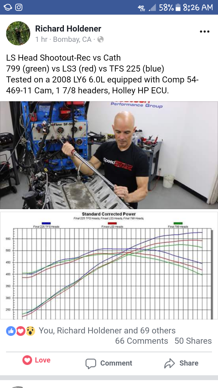

If you can go TFS heads.... do so.
Absolutely agree.
Thanks for posting that, I knew those heads kicked absolute ***, but I didn't expect them to embarrass the LS3's that bad. I knew the LS3's would likely drop some on the low end but I figured they would at least compete on the big end or be close. Those TFS kill right out of the gate and just keep pulling away. And compared to the 799 head, ho-ly-****.
Old May 31, 2018 | 01:24 PM
Posts: 22,298
Likes: 3,619
WHOA! Them TFS heads flat ROCK!
Old May 31, 2018 | 01:37 PM
Tuskyz28's Avatar
Joined: Sep 2014
Posts: 4,893
Likes: 703
From: Mississippi
You welcome guys.
The cam tested really hurt the true potential of those TFS heads as well and helped the LS3 heads.
Cam used in the test was a 231/247 duration. That's too much exhaust for a good proper cathedral head.
I love my LS3 heads on my top of my LS2 motor but if I could do it over again i would do TFS up front.
You welcome guys.
I went and did some reading and saw a lot of what you just mentioned. The LS3 stomped all over the stock cathedral head, and the TFS stomped on that lol. However, the LS3 heads were like $700 vs I believe it said $2500 for the TFS. The as cast would fall nicely in the middle price wise and give a majority of the power increases those fully finished ones did.
Would be nice to see the TFS truly shine with the proper cam, but damn it still did really good with the wrong one.
Old May 31, 2018 | 02:26 PM
Tuskyz28's Avatar
Joined: Sep 2014
Posts: 4,893
Likes: 703
From: Mississippi
The LS3 heads are the BEST BUDGET heads period but not the BEST PEEFORMING heads. Pooter, I have also seen TFS heads do well on a single pattern duration cam that no one used no more. Something to think about on that vs the wrong cam for those tfs heads used in the comparison.
Old May 31, 2018 | 02:42 PM
Posts: 22,298
Likes: 3,619
Yeah, I think a lot of guys forget that while LS3 heads need more duration "spread", cathedrals do NOT. LS3 intake ports are so big that the I/E ratio is more lopsided than with cathedrals. So Yeah Tusky, the TFS heads should have had a more cathedral-friendly cam to fully exploit its potential .
