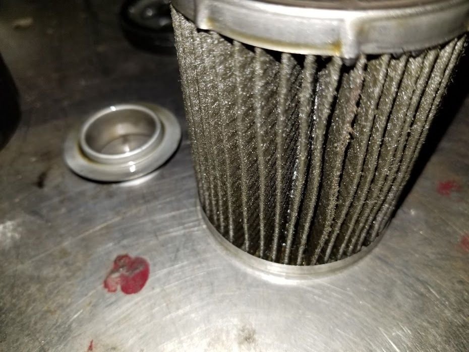

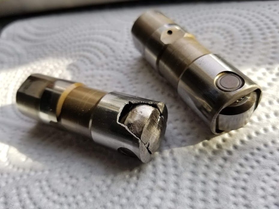

Had something similar just happen to my LQ4. I was able to find the broken parts of the lifter in the pan, there was hardly any flakes in the bottom of the filter, I didn't see any in the element, the pan had the majority of the trash. The cam bearings were very clean, the oil galleys were spotless. I may have lucked out.
The lifter on the left looks just like my #7 EXH. But, I had all lopes damaged to a decree. I also found a piece of the roller in the pan. The rest of metal suspended in the oil and was taken out by the filter or when the oil was drained. I had no bearing damage too. :-) I changed the oil after 300 hundred miles and found a few shavings in the filter. It looked similar to yours.
On the second oil change, I stopped in a gas station and when I restarted the motor the pressure fell to 21. I carefully restarted the motor and the pressure retuned to normal. Assuming that the bypass opened, I drove home and changed the oil the next day. I opened the filter and found nothing unusual. On the third oil change, I noticed the pressure needle pulsing at idle. It pulsed for about 100 miles and I decided to change the oil again.
On the fourth change, I switched to my usual oil, Delo 400 15-40. Its holding good pressure but has only about 100 miles on the change. In total I drove about 1500 miles on four changes. The motor is clean and I hope this will be the last change until I hit 3000 miles. The motor runs great, with only the usual sewing machine sound.
