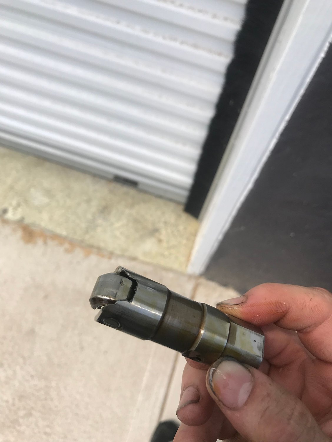

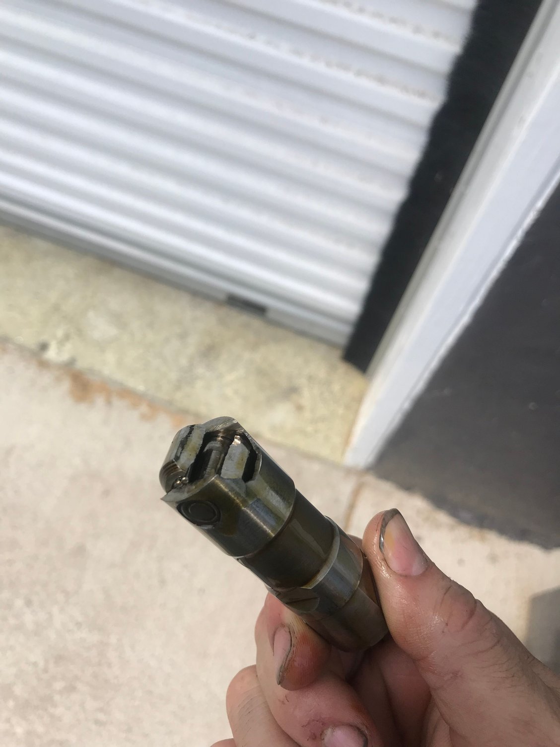

Old Jun 9, 2018 | 11:14 AM
Lt1slowerbird's Avatar
Joined: Aug 2013
Posts: 139

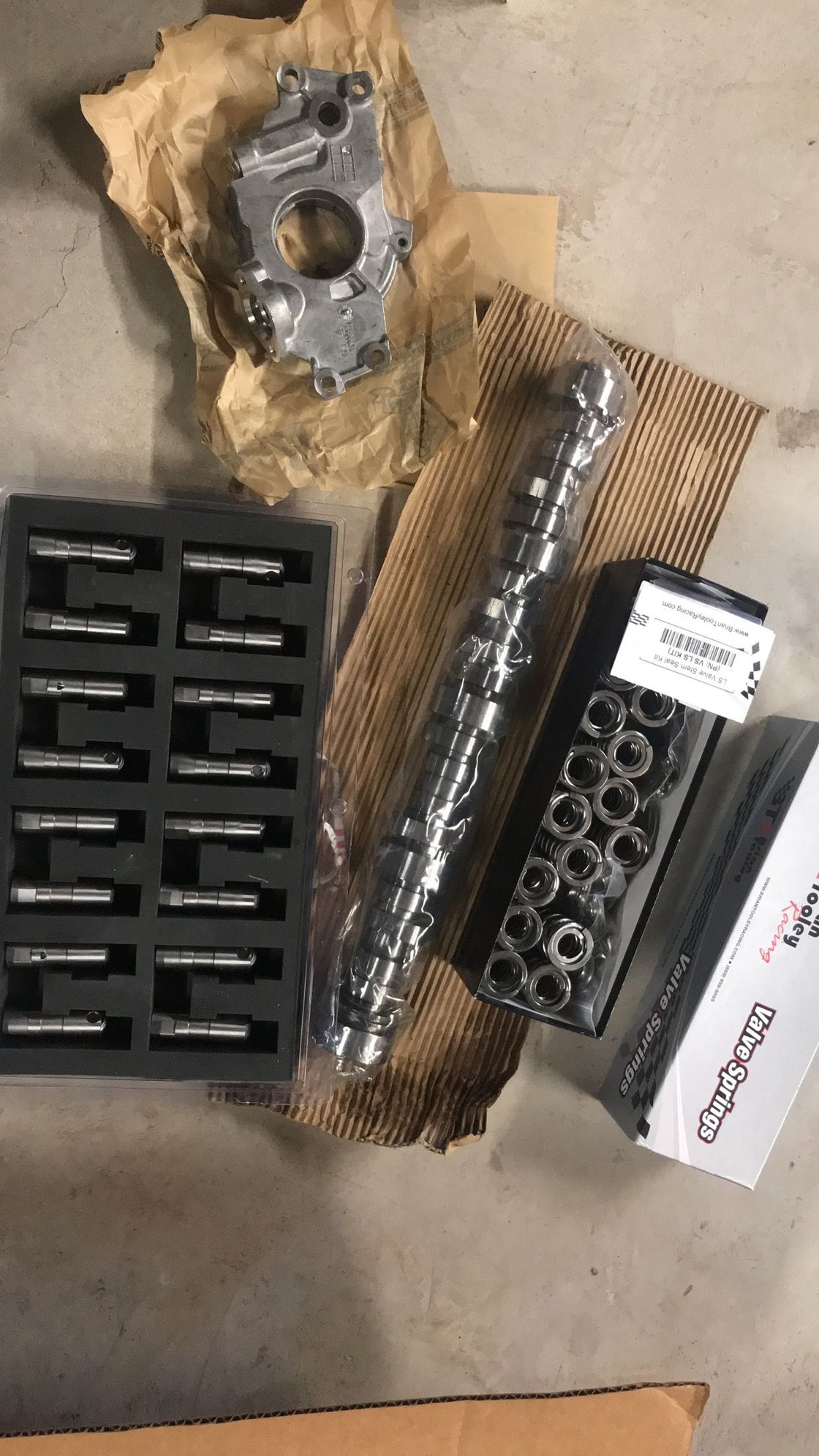

Had to fish this lifter out of cam hole. Wouldnt come up through the bore. Bores all looked good and inspecting the old cam the lobes look fine. Went with a bigger cam this time which is why I just went with the aftermarkets for better ptv clearance. Also what is a good preload on 6504 morels. Been told a couple things. I think they recommend .030 to .050 but Jw what people run it at. Lucky for me the old cam only has about 20,000 on it. Block is still clean. Putting new cam in today. Lifters are in oil in the sun. That condenser is a pita to get out of the way for me for some reason

I’ve come up with 13 turns and some 12 5/8 & 12 3/4 turns. This comes up to about a 7.500 pushrods. Is this okay on the morels? Been told by tick that they set the morels to all around .060 preload. So I’m in or around that range since the 7.475s would put me light on the preload on a few of the short ones.
