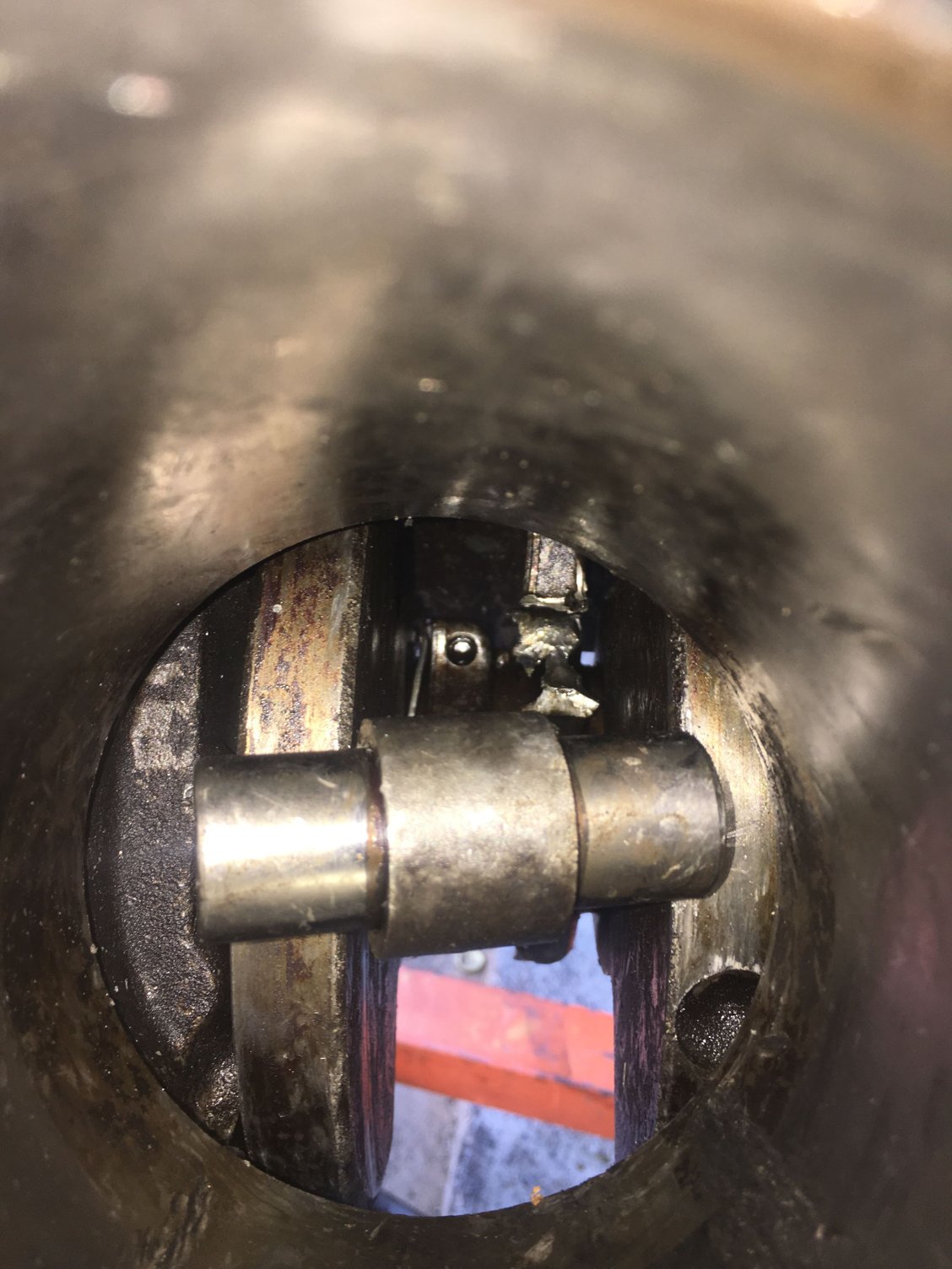

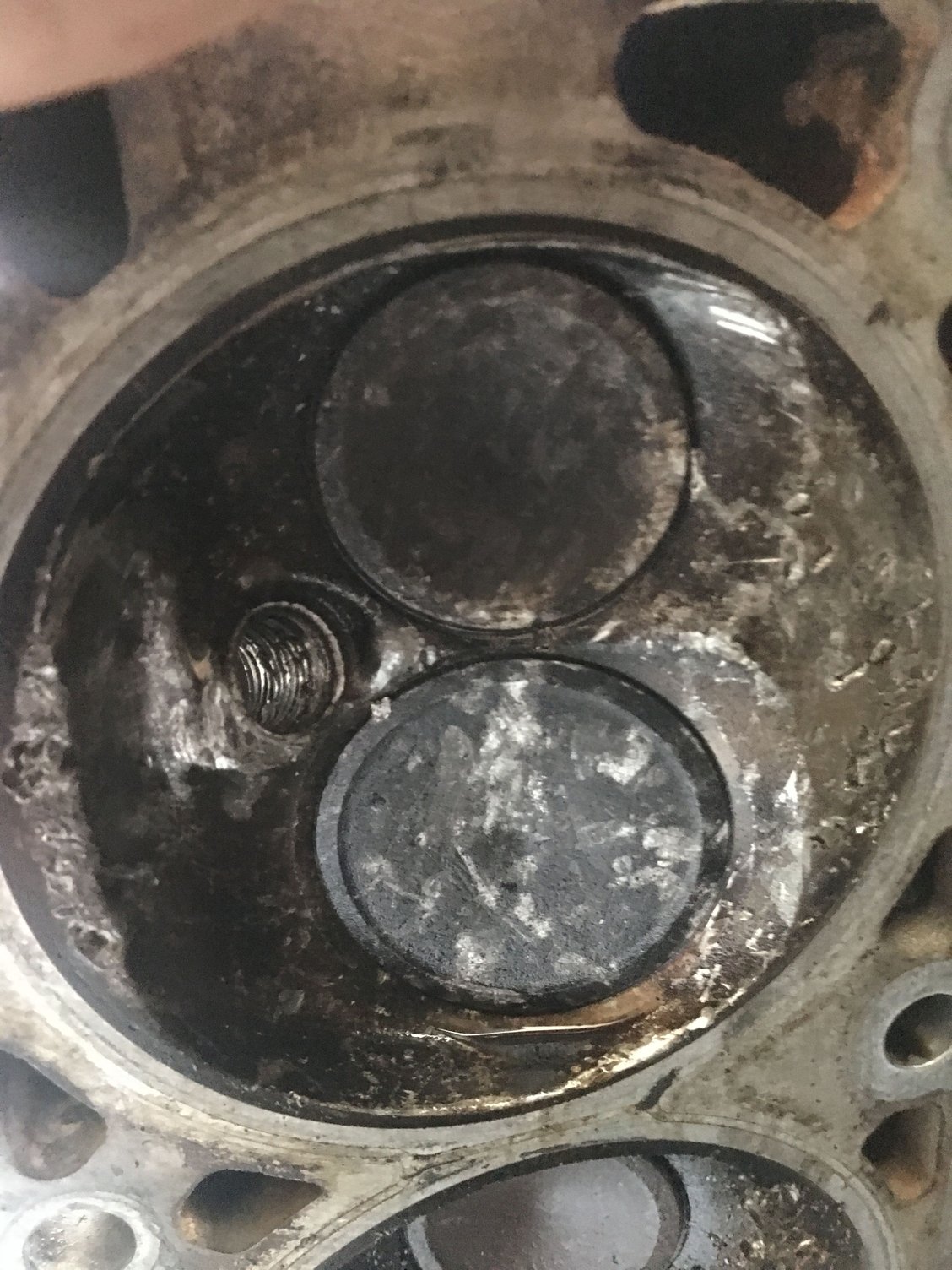

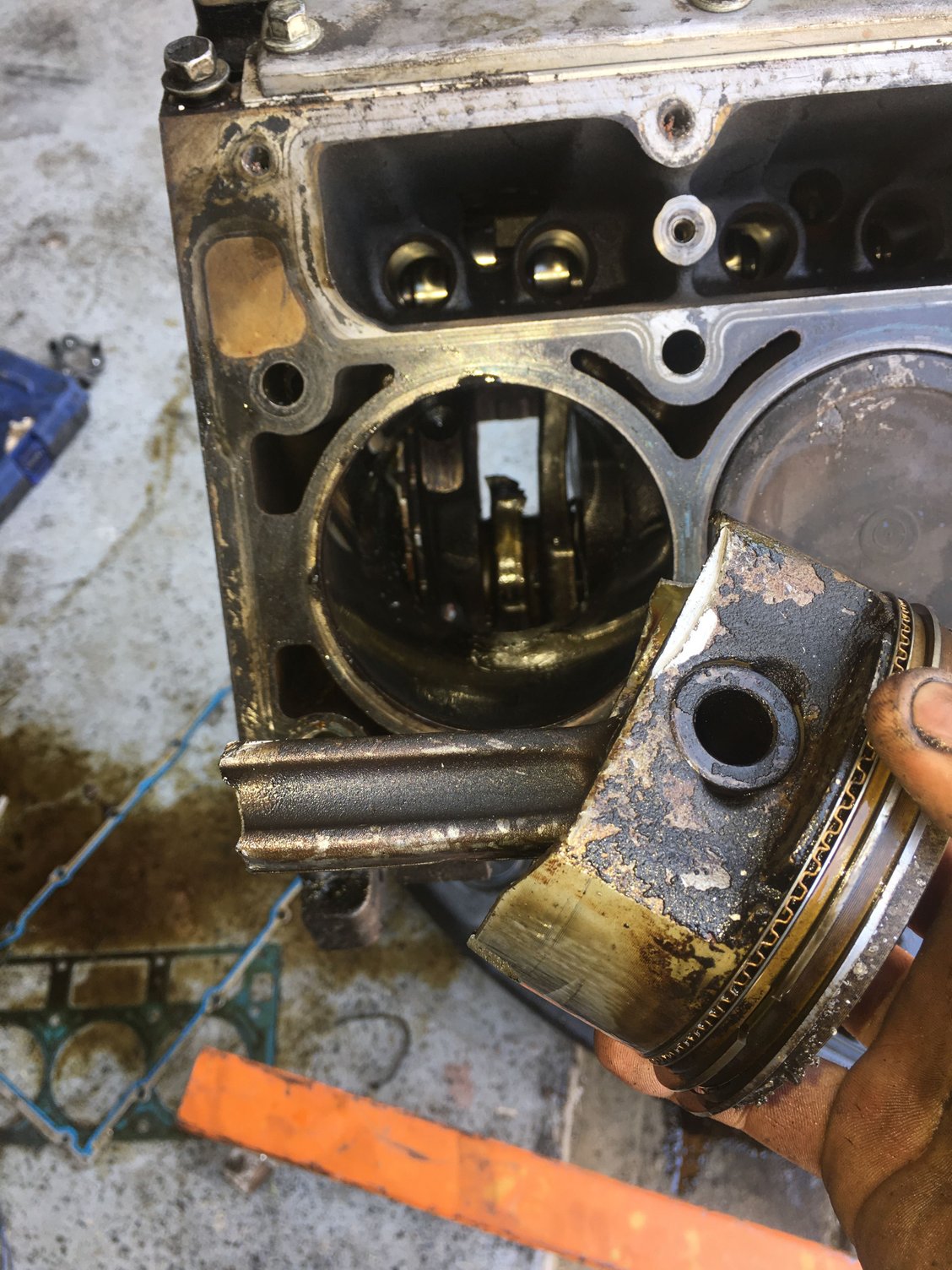

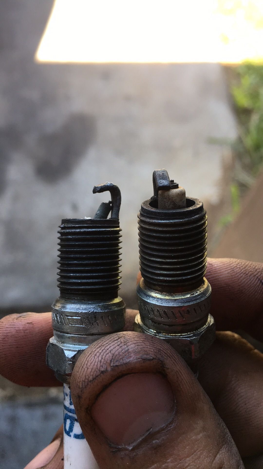

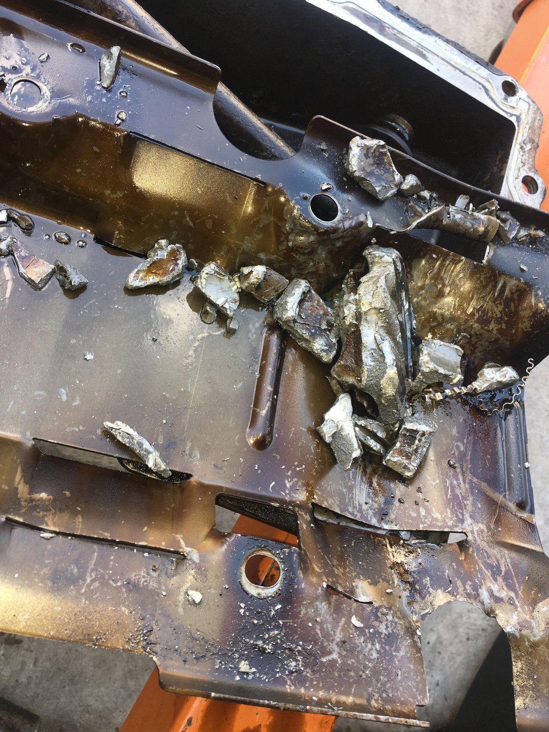

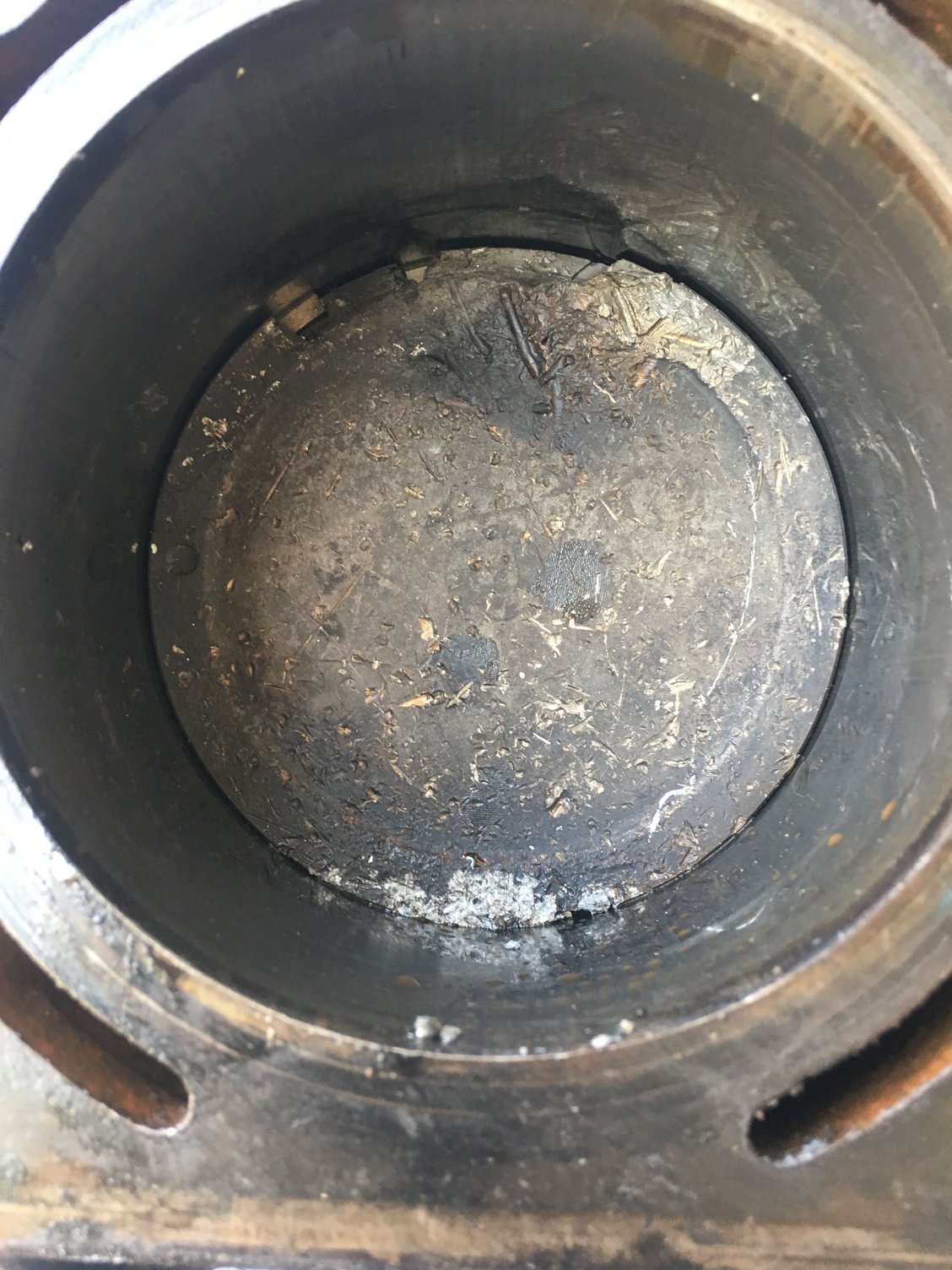

i have a lq4 with 243 heads along with a 228r cam, long tube headers along with a nubs intake with ls7 throttle body. I drove with it for almost a year with no issues until recently. I added a stall and built trans in it and under wide open throttle would break the spark plugs. Never have had this issue before. Well after I got back home and drove the truck it died and locked up. Tore it apart and cylinder 7 piston was destroyed, #5 piston was deteriorating and #8rod snapped. Any ideas what would cause this?

no valves dropped. Only damaged due to prices of piston hitting the head and valves

Could be many many scenarios, stretched rod, worn rod bearings, broken piston. I'm gonna guess it went something like this.........WOT piece of a piston breaks off and whacks the spark plug-plugs. You replace plug-plugs continue running it hard WOT next time more piston breaks off jams piston against the head breaks rod. Could go a few other ways too. Moral of this story is GAP THE RINGS LOOSE if you are going to flog the crap outta it. Especially the top ring, the top ring got hot didn't have enough end gap and had to go someplace so it broke the piston ring land.<very bad
I've done the same thing BUT when it broke the piston I stopped driving it. You my friend made sure there was no doubt where this was going. When EVER you have a broken mashed spark plug you know big trouble is lurking.

Looks to me like the bottom end went dry, the bearings went to **** which allowed the pistons to hit the heads.
It's also why you have a rod snapped, if the bearing seized it'll grab and snap the rod
Or you were revving it too high and the rod bolts stretched and caused all of the same scenario from bearings getting wiped out and seizing.

Had launched it and it was at 6k about to shift into second. The first time it happened I used a scope inside cylinders and nothing out of order. And it was at full line.

Engine still rotated freely

Sounds like I guessed wrong. A ring land breaking is a possibility but you usually don't see that on NA motors.

It's possible you broke a ring land and pieces went into the intake and went into other cylinders.

Just missfiring due to messed up plugs. Only happened on wot. Driving it normally drove fine

Detonation.

Messed up plugs wouldn't only misfire at WOT so I agree with 1Fastbrick
Detonation would hammer the pistons, rods, and bearings

The factory ring gaps are set too tight, its so common to have that top ring land come off. Plus number 7 cylinder runs hot to start with. If it were me I'd be adding quite a bit to the ring gaps if you are going to run hard WOT all the time. Happened to me number 7 broke the land and it happened fast. Of course I didn't run it after I seen the plug was mashed. Once the piston looses a ring land its not long till the piston fails<see results above>
