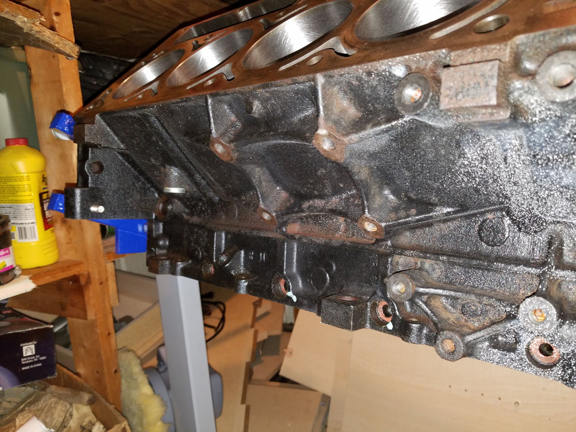

Hi everyone I am new here. My name is Jay an I have some questions. I bought a block off of a friend of mine and I am looking for some direction on what to do here. I am pretty mechanically inclined however this is going to be my very first engine build ever from ground zero.
Like I said I bought a block off of a friend of mine. It is a 4.8/5.3 Gen III LS Iron Block manufactured May13th 2004 from what I can gather from the codes it.
I'll post up some pictures at the end of the thread here. I currently have a Y87 Performance package V6 Firebird that I am turning into a WS6, I bought it earlier this year and it's my project car. Mainly because I have always wanted a WS6 and can't seem to find them around here. I'll post some pictures up of that on here too at the end.
With that being said, back to the engine. I want to bore it out to a 5.7L However like I said this is my first engine build. My question is, what size do I bore it out to? The machine shops I have talked to around here seem to think that it can't be bored out to a 5.7 because none of them have ever done it. They are asking if it just gets bored out 10-20 thousandths with a different crank to make up the difference in the cubic inches or take it out the full 220 thousandths to a 3.905 bore.
That is why I am turning to this forum and looking for some expert/seasoned advice. I originally thought I might want to do a 383 stroker motor but when I seen the prices of such I think that's going to be pretty expensive and I might just build a normal 5.7. The issue lies with this block I bought, it has a few scoring marks on the cylinder wall of number 7.

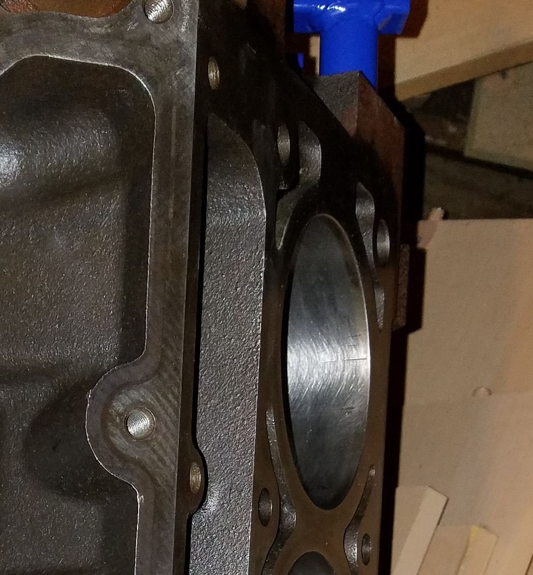

If I absolutely have to keep it a 5.3 how much should it be bored out to in order to get rid of the scoring on cylinder 7 and to also keep it a 5.3 and what would that bore size and pistons be? I can feel the marks ever so slightly with my finger and i can catch them with my fingernail ever so slightly, however the person I bought it from said it ran great and had no issues with oil pressure.
So a few different opportunities with this block but my main goal is to make it a 5.7 most likely without doing a 383 stroker. I feel Id be happy with a normal 5.7. coming from a V6.
Thanks for giving my thread a look and I look forward to becoming part of the community here. Thank you again!

Scoring on cylinder 7

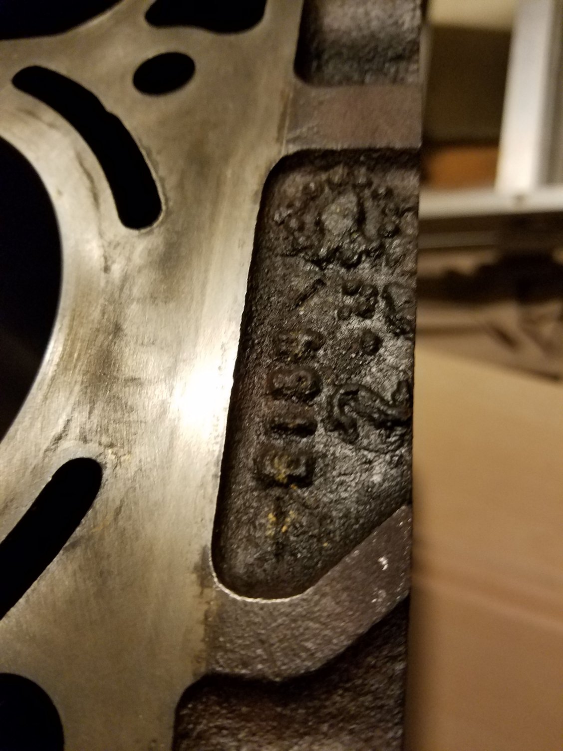

Forgot to mention, casting number on the side of the block reads 12567393.

Boring it to a 5.7 is not an issue. I would suggest finding a machine shop that is familiar with LS engines. Hard to say what those scratches would need to clean up if you stayed in the 5.3 range.

SVSlow, I think I have found a good shop, they explained that cleaning boring, honing, new galley plugs, new cam bearings, testing and checking the block was just a little under $500 out the door, I feel like this is a pretty good price. I found out some more info on the block and found out it is a LM7 iron block when I checked the codes on the side of it. My question now is, do I do a bore of 3.89 or take it out to the 3.905? An if I go to a 3.905 is that safe?

It depends on what you want to spend on pistons. If you know of a good set, or are able to find a good set of factory ls1 pistons, then I would mic them and bore appropriately. The cheapest set of aftermarket pistons you will find will be about 750 bucks for pistons and rings. Always remember, the larger bore you go, the less cylinder wall you have, the less safe it is to make big power.
What power level are you trying to reach? If you're shooting for 400-450 naturally aspirated, that is VERY doable on the 5.3.
If it were me, i'd see if those scratches could be honed out and keep factory pistons with new rings, then spend the left-over cash you would've spent on pistons and spend it on a set of 799 heads and a good camshaft.

I have read many people recommend finding a stock LS1 rotating assembly and making your
5.3 a 5.7.
Just take those pistons to the machinest and have them bore to fit the pistons. Iron LS1

You usually want to bore the block to about .005" less than the final bore diameter. That .005" will be taken out with honing.
If you're not building anything too wild, just use a stock ls1 rotating assembly. The machinists can measure the pistons and decided what to bore and hone the block to. Honing should be done with a torque plate, and if the machine shop is not very familiar with LS1 engines, then they may not have an LS torque plate. In that case, I'd look elsewhere.
