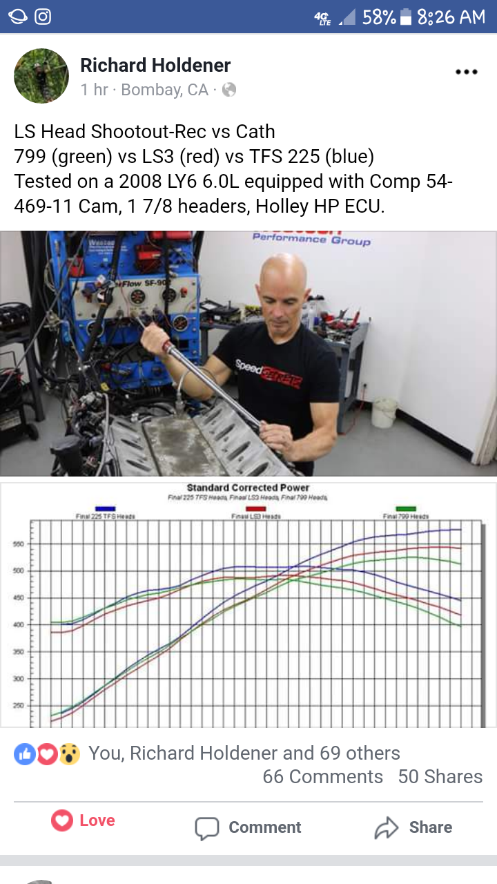

Thought about this thread and thought about your cylinder head choice. You might find this interesting.
