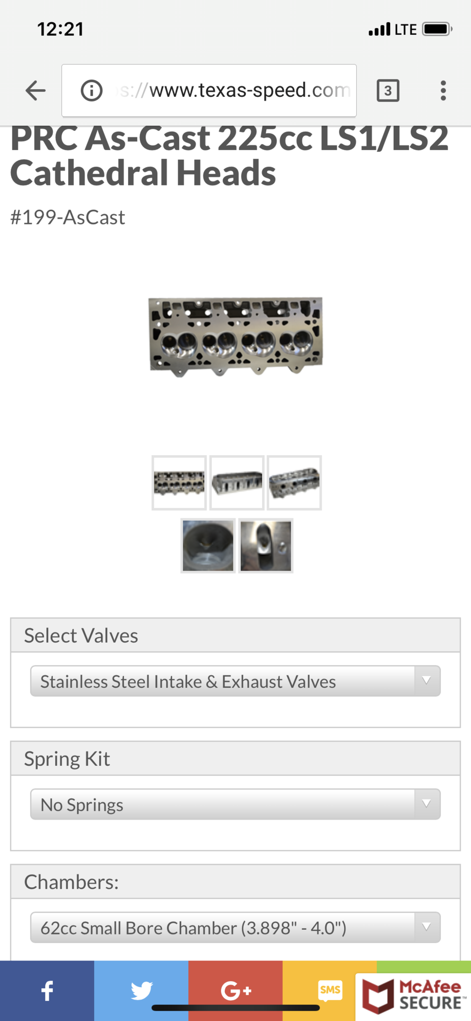

would these be a good setup to gain more horsepower instead of porting and polishing the 243’s?
I found a TBSS intake I’m going to go pickup tonight at Great Lakes dragway.
Save some coin and use yours. https://www.texas-speed.com/p-1172-p...-castings.aspx
Just be aware your probably won't be pushing 500 whp with a TBSS and stage 2.5 heads. More like low 400s. Still a solid improvement.
