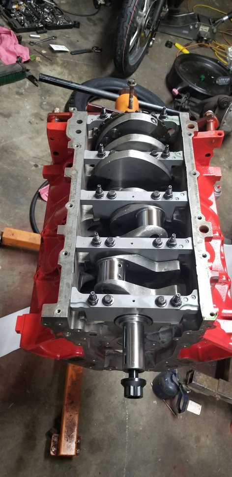

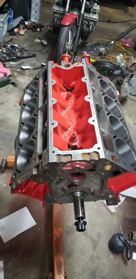

Crankshaft went in rather smoothly.

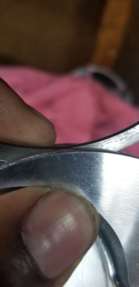

Hit a snag installing the pistons. The top ring won't go flush with the ring land. Gave the seller a call and they are sending me a set of total seal rings.. So if you purchase this kit just go ahead and buy a different brand of rings.. And even still if you add the price of the rings, the extra charge for balance, and a set of bearings it is stil hundreds of dollars cheaper. If these are the only hurdles, totally worth it.. Will update when new rings come in.

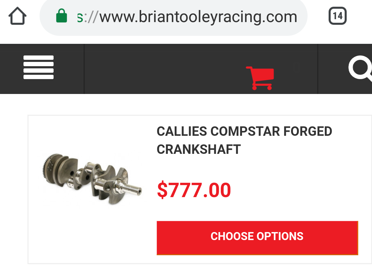

AlexJ, I appreciate you sharing the details of the Speedmaster cast crank 408 build. I've always wanted more details from someone using it. The actual cost to balance was a key question.
293LSX,
BTR has Callies Compstar ​​​4 inch cranks for $777, it also requires adding the reluctor of your choice. KSC mentioned while back sometime vendors can have Callies balance the crank when it's ordered for no charge.
The $750 forged Speedmaster (questionable quality based on reputation) plus $250 to $500 to balance will end up being more expensive on average by $200-$400.

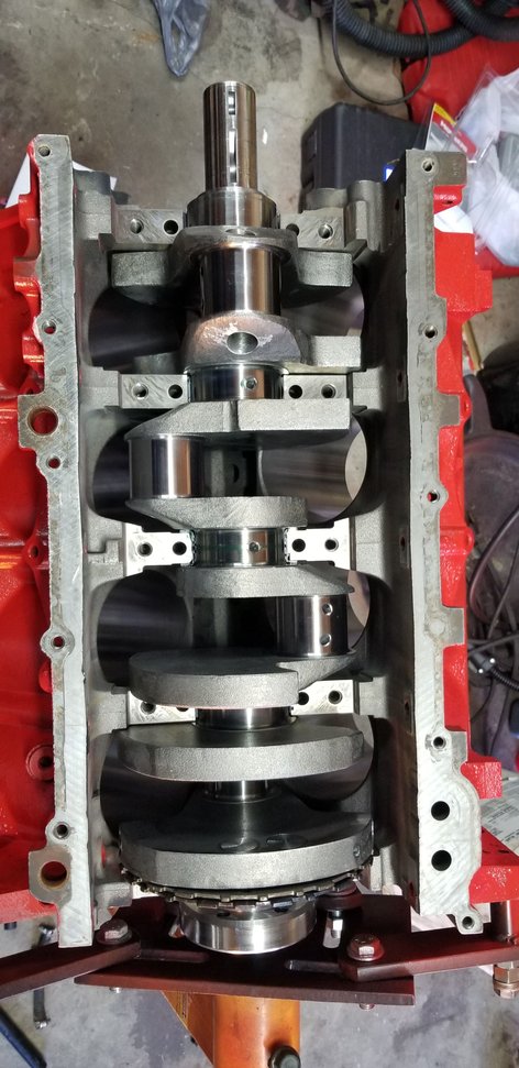

Threw the procomp crank in the trash.. the rods wouldn't fit..

Didn't take any weight and my machine looked out on the balance..

Going Together nicely. now.... still using procomp rods and pistons.
