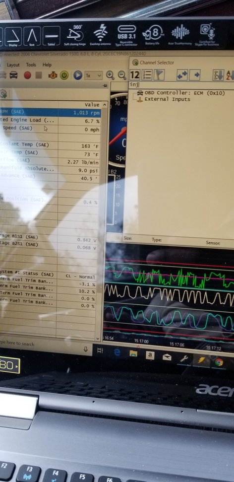

All the tuners were back logged so I took the plunge. I've learned a lot the last couple of days getting idle, and drivability issues sorted.. was able to tune in my 50# flex injectors, and finally get my vss and speedometer calibrated properly.
Going to get my exhaust sealed up, and tucked in properly, then i can precisely log and dial in my wot, and stoich.

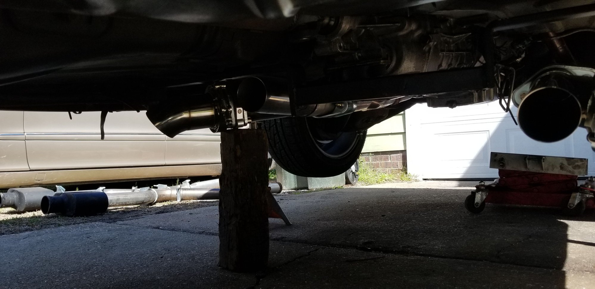

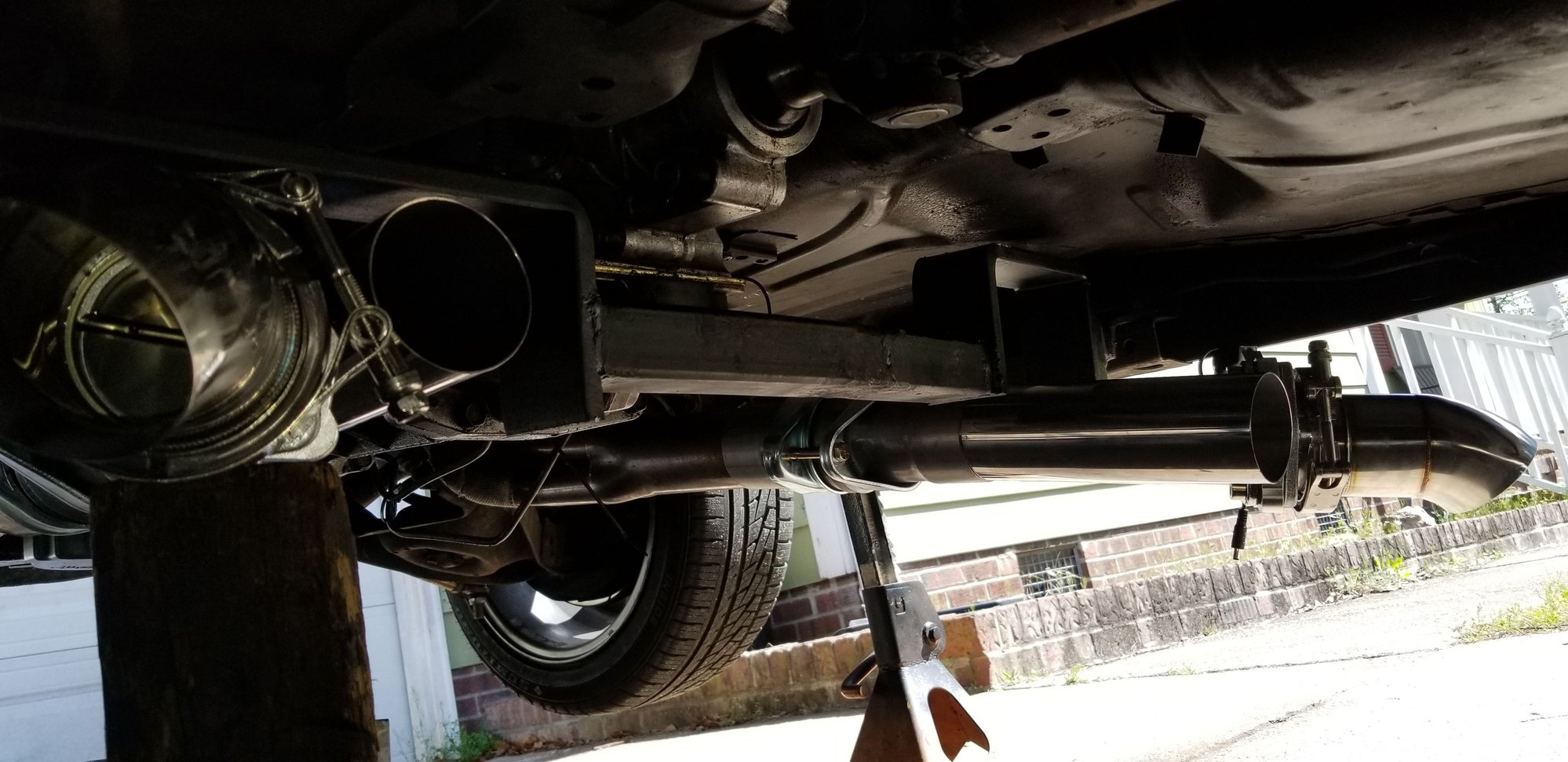

fabricated a crossmember up so it woul clear my cutouts, and get my exhaust tucked out the way.
