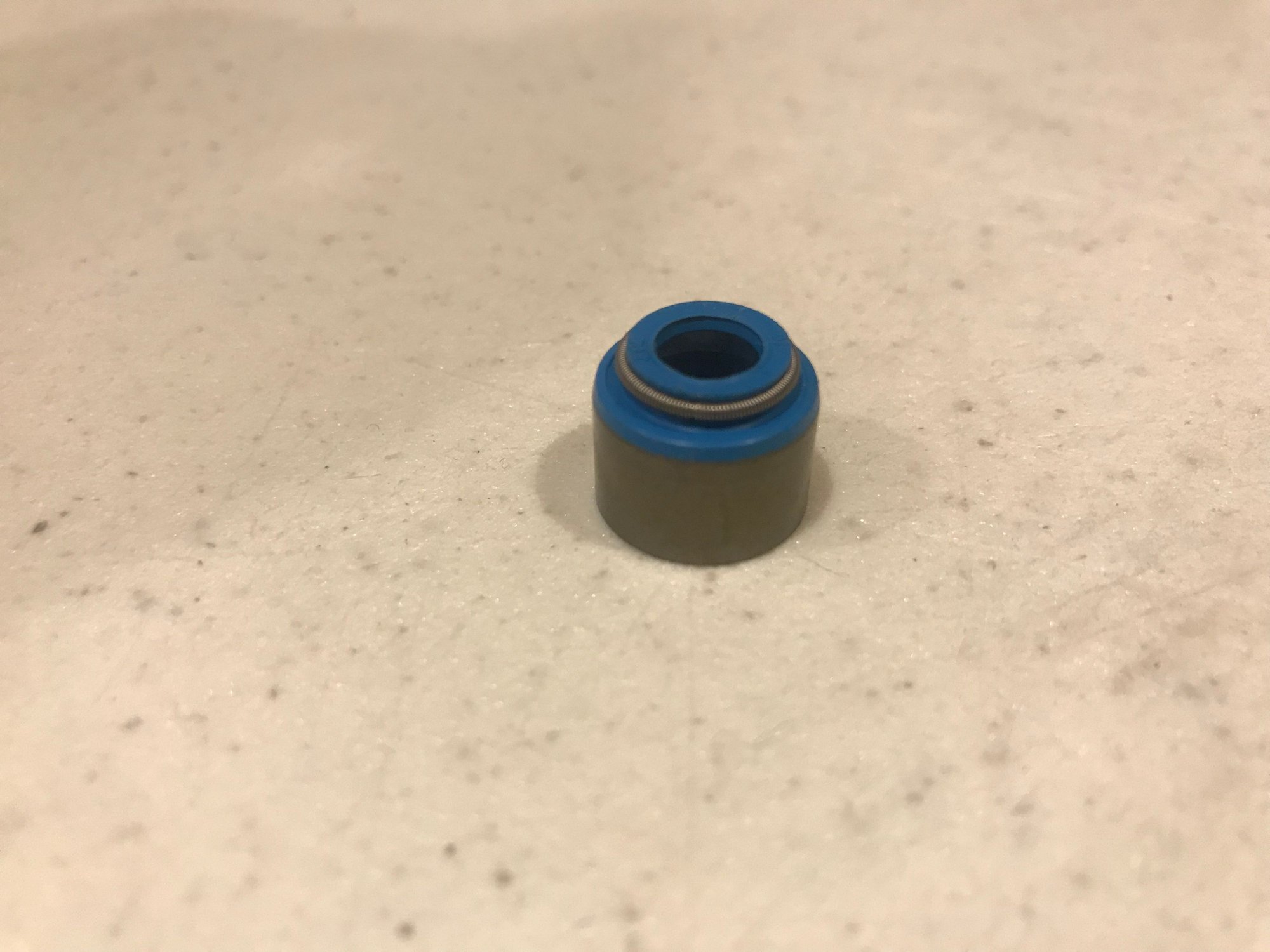

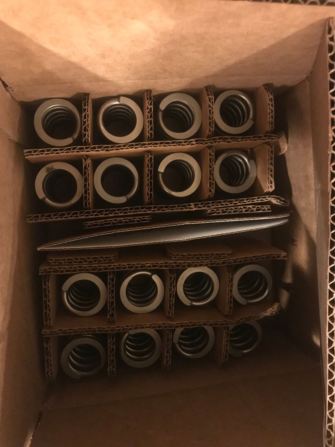

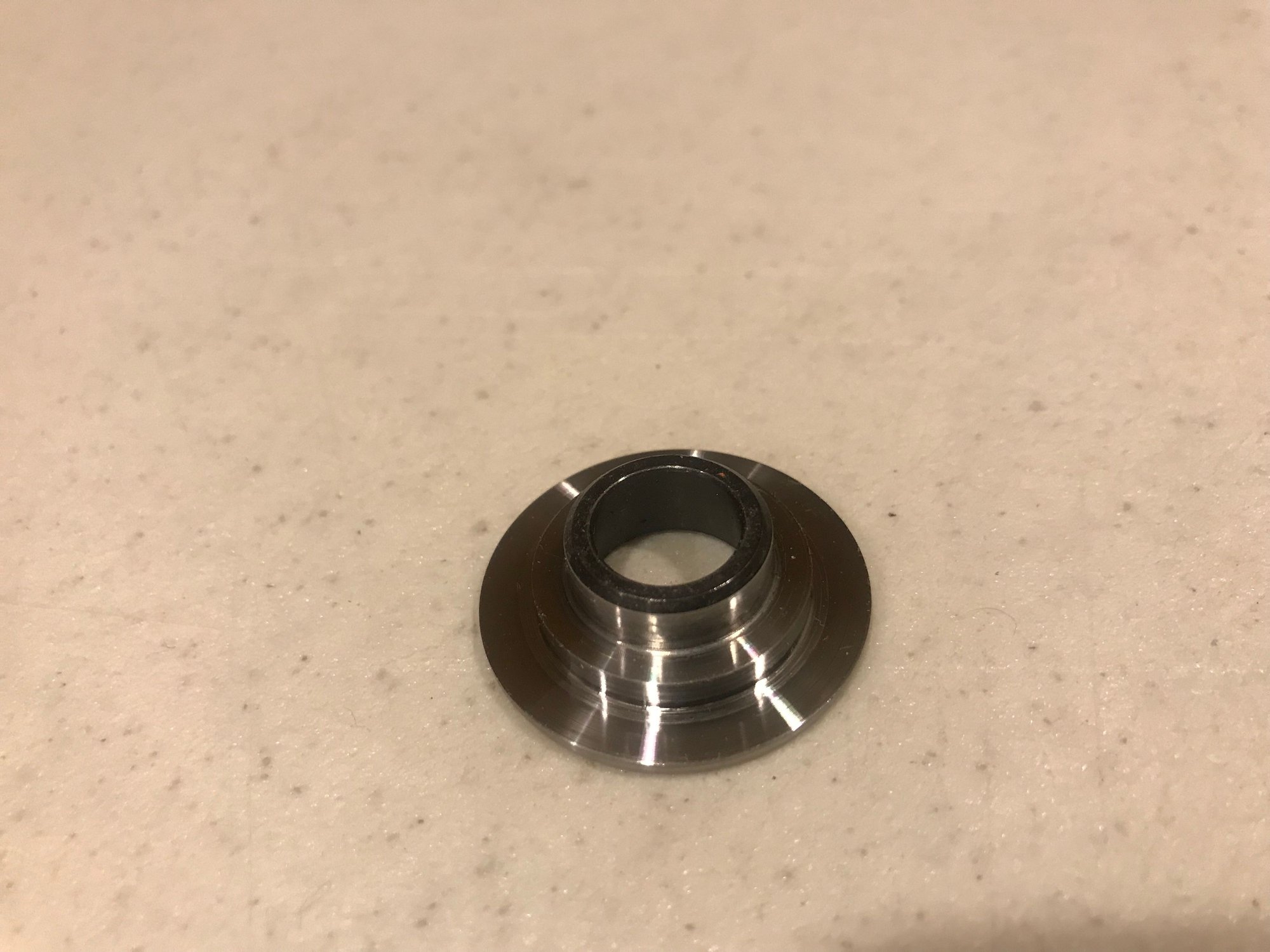

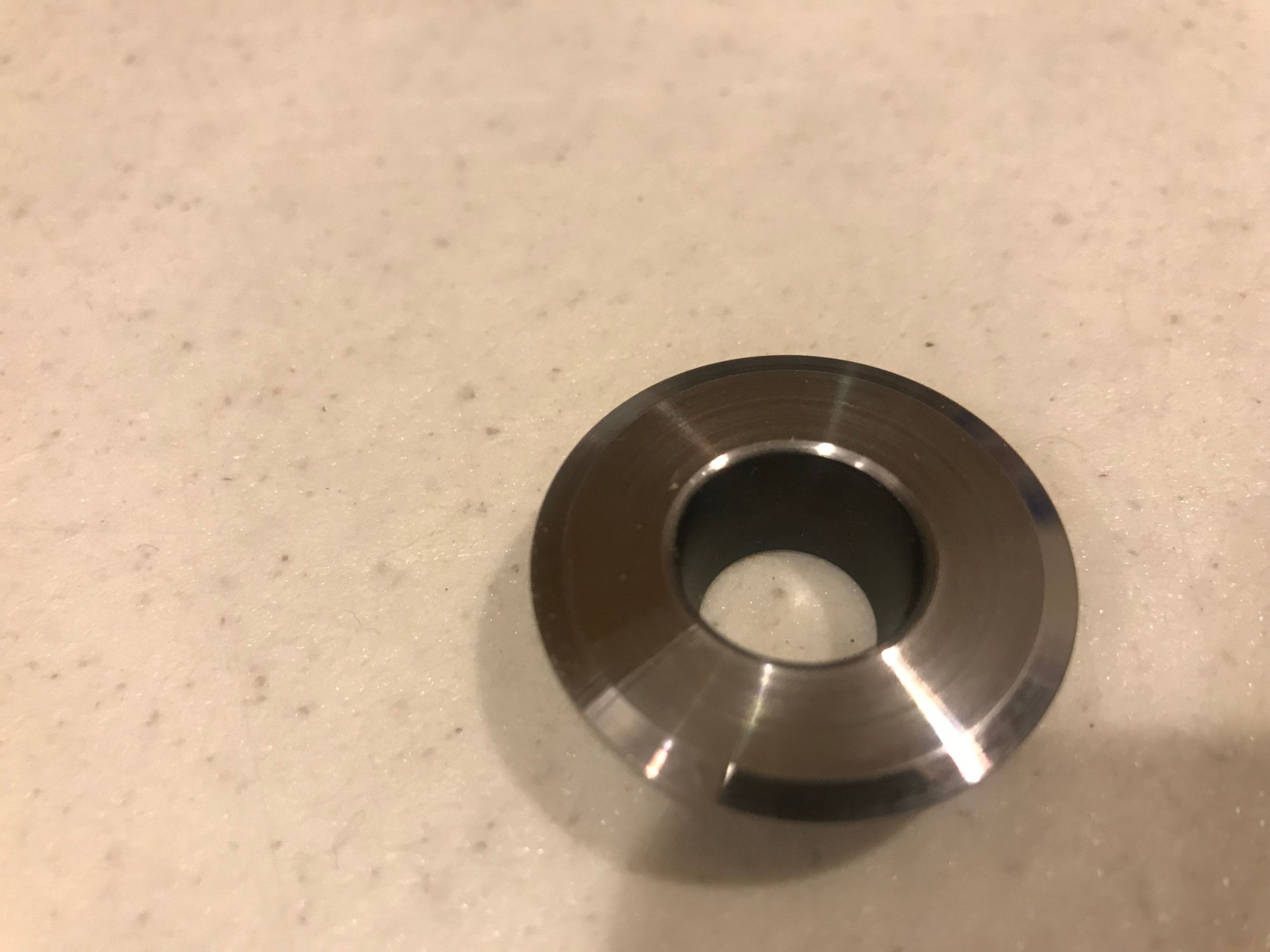

Some Pics
Old Mar 26, 2019 | 09:07 PM
redbird555's Avatar
Joined: Mar 2009
Posts: 4,444
Likes: 9
From: Pompano Beach FL
Those aren't even beehive springs. Likely they're some nascar spec springs that psi makes and are commonly found on Ebay when they're taken off engines and this guy is selling them
