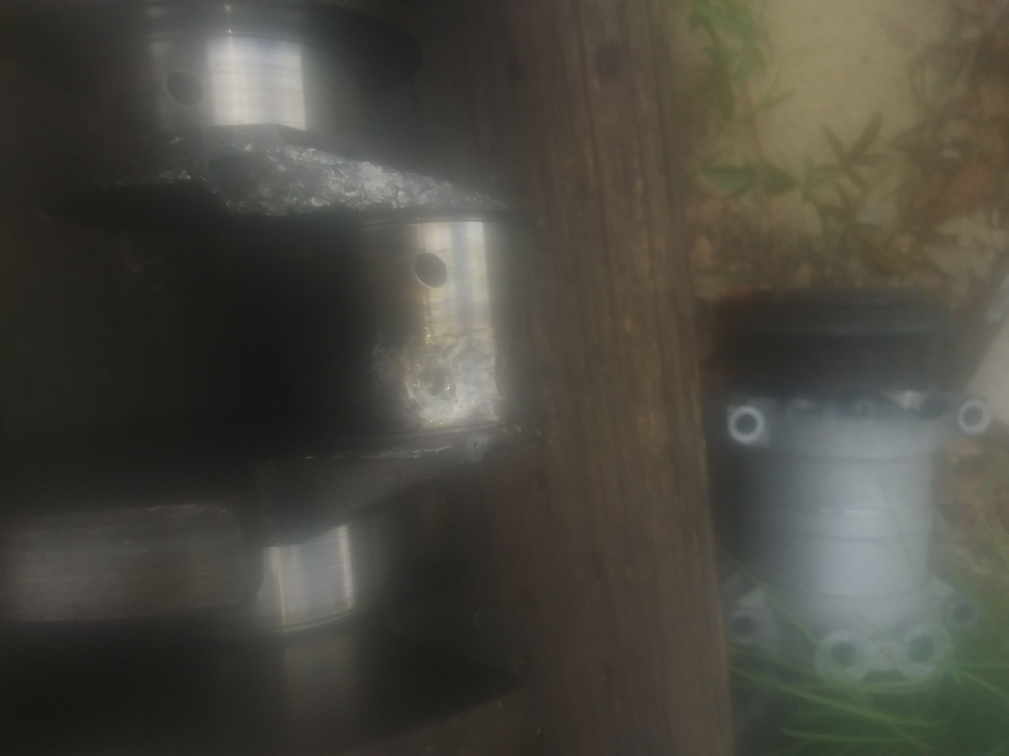

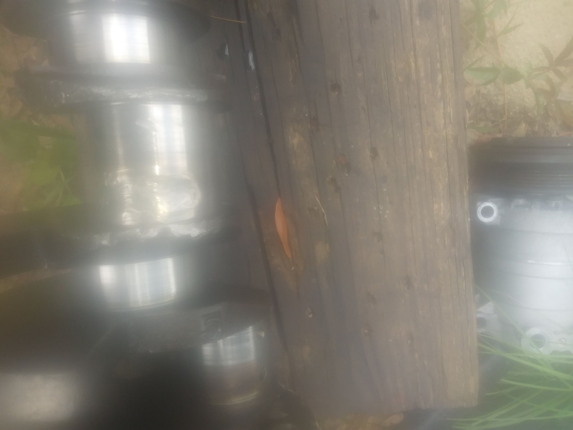

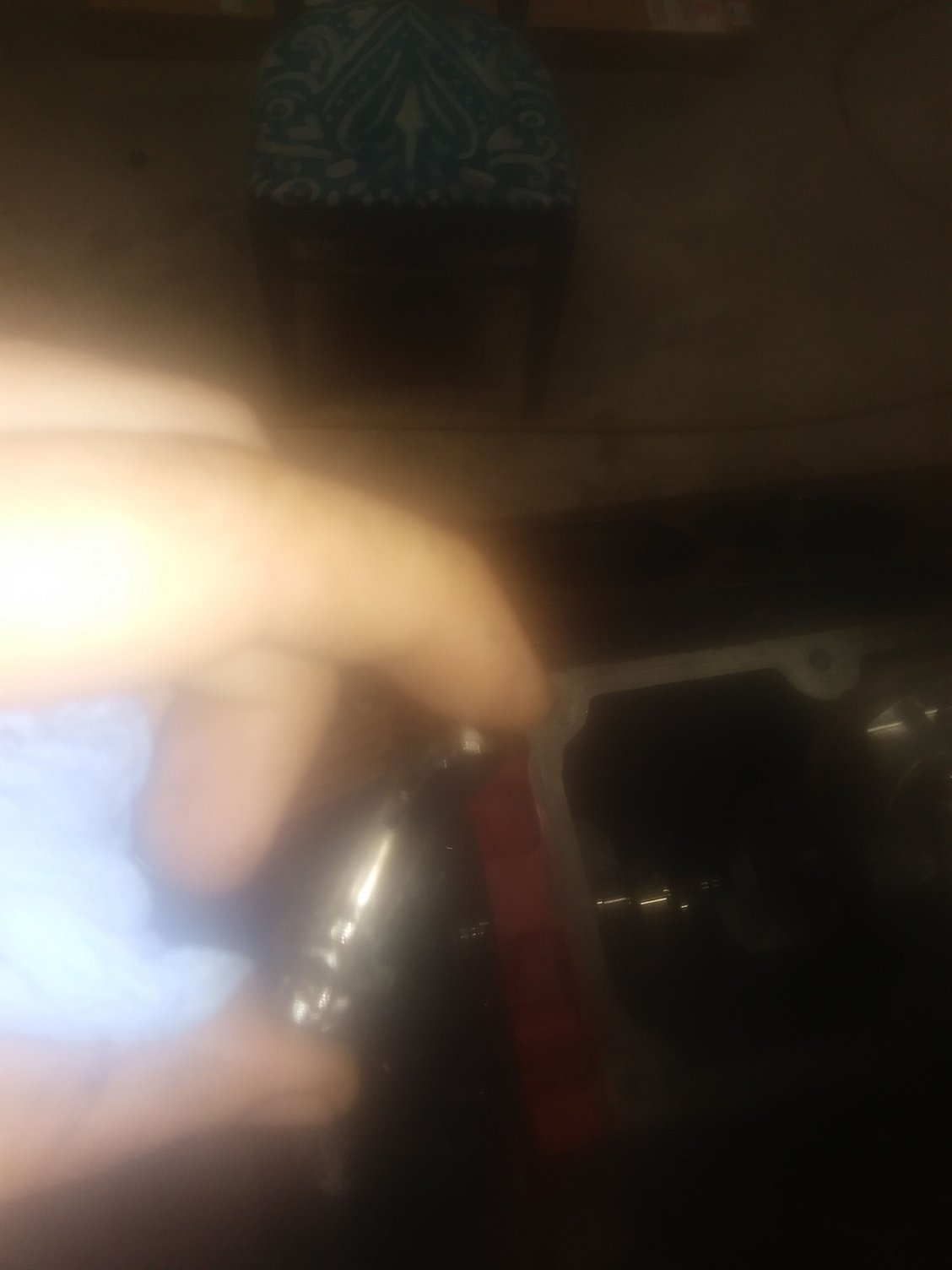

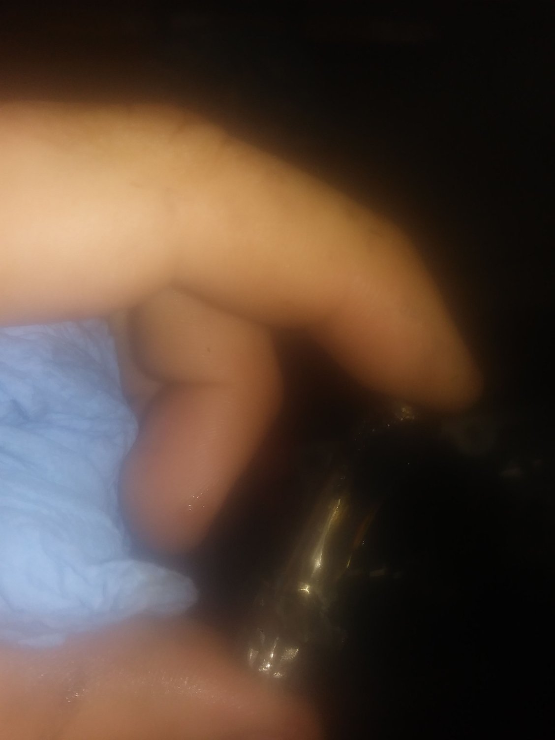

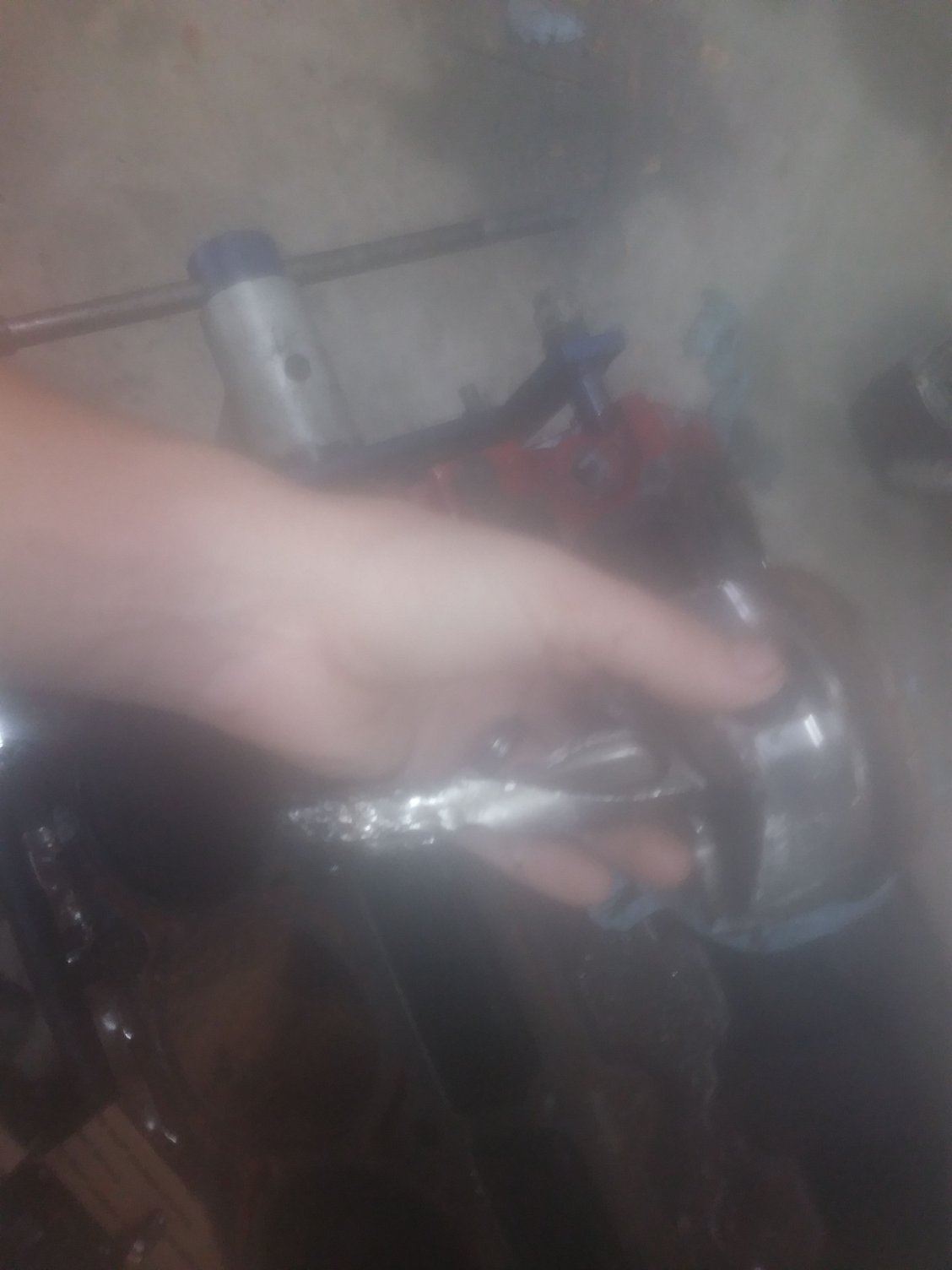

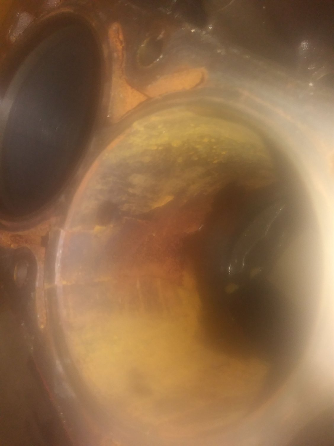

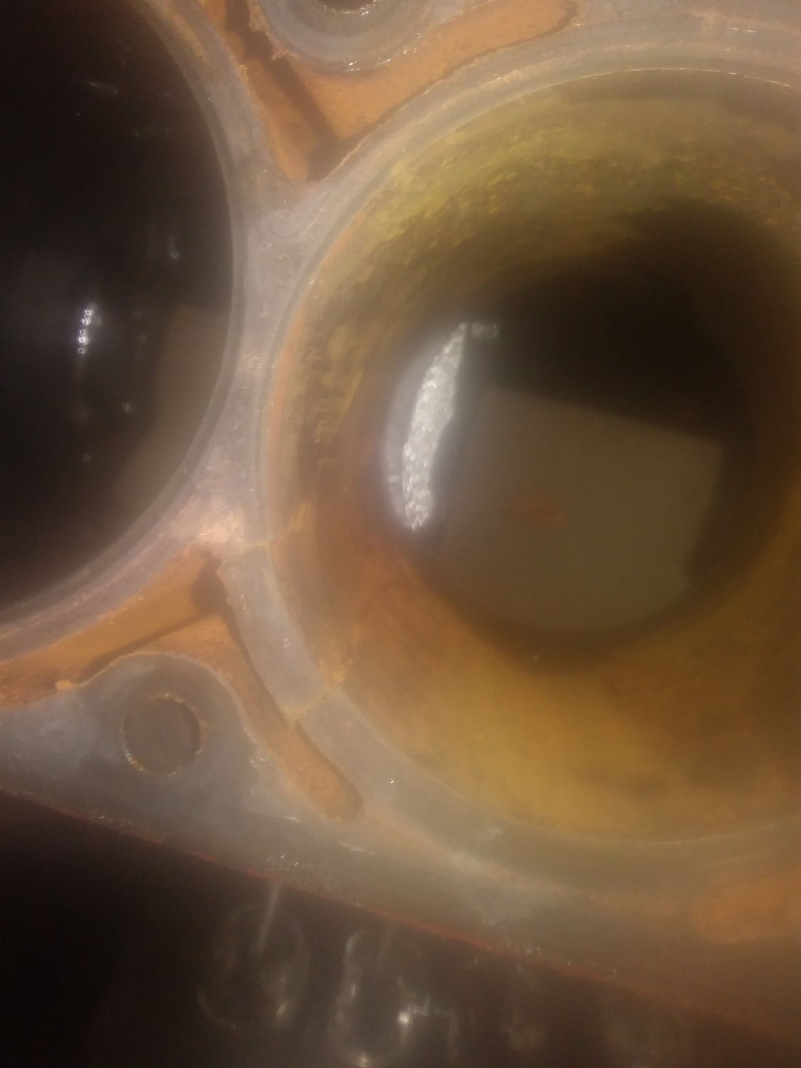

Yea i think thts what happined. Im about to post up some carnage pics. Pretty bad!

Pics look like crap. My phones camera lens is scratched up pretty bad. Kinda get the idea tho.
