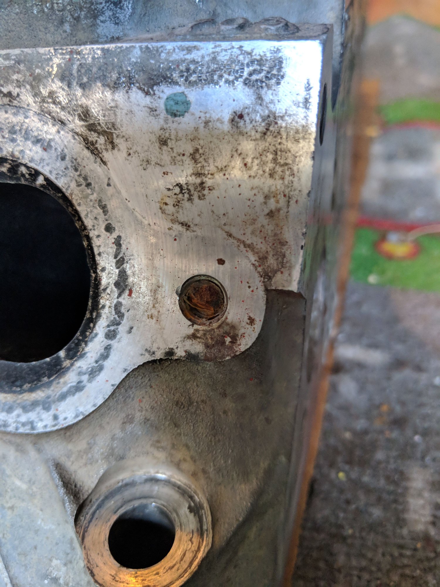

How does this porting job look?This porting was done by my local machine shop which gets great reviews. It was done on a Rottler P69 CNC machine if it helps

What if I just keep the stock cam in and send the 243 heads off to Texas speed to get ported and milled to 60cc... ls6 intake.
The ported and milled heads would be a gain of 60cfm from stock cfm

The ls6 intake is a great intake for the 4.8L no worries there.
Those heads look incredible as well and I'm sure they can flow some serious air but that's the issue with the 4.8L. The 4.8 is simply smaller than the other ls engines and it doesn't demand as much air (or push as much) until very high rpm. This is why that ls6 intake, which is considered by some to be merely adequate on a 5.7L is plenty good for the 4.8. this is also why even with other mods in place the gains from long tube headers are much less dramatic than they often are on the larger engines. The most important thing for the little 4.8L to make decent power at lower engine speeds is compression and cylinder pressure. You've got to make the most of what displacement you have. Even if those heads we're milled down enough to get your compression higher than stock, the additional flow they are capable of still wouldn't offer any benefit until maybe the very top of the RPM band. It would be a waste to use them on an engine so small, they will with the larger ports and valves, in all likelihood hurt low speed power by reducing port velocity. This is why I keep suggesting you save them for a larger engine and get a set of 862/706 castings with the smaller 1.89" intake valve which is exactly half the size of the 4.8/5.3 bore size and have them milled down to about 57-58cc for about a 10.1-10.2 compression ratio. This way you can increase your horsepower at higher RPM with more agressive valvetiming (cam) and yet the additional compression will help maintain or even improve the engines lower speed power and response if done right.
We aren't going to talk said cam anymore though until we know what the rest of the setup looks like, gearing, converter, ect. The cam should compliment the rest of the combo.
