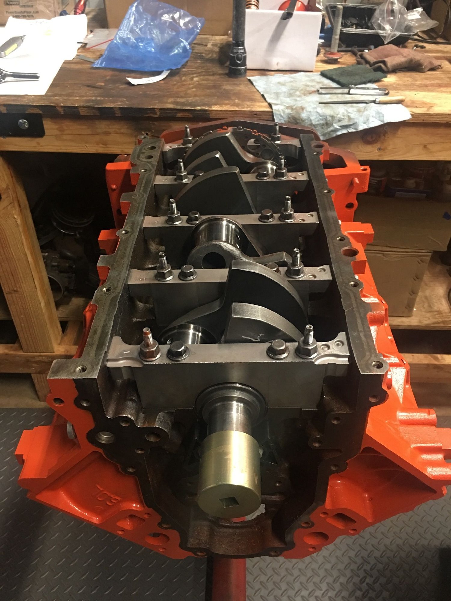

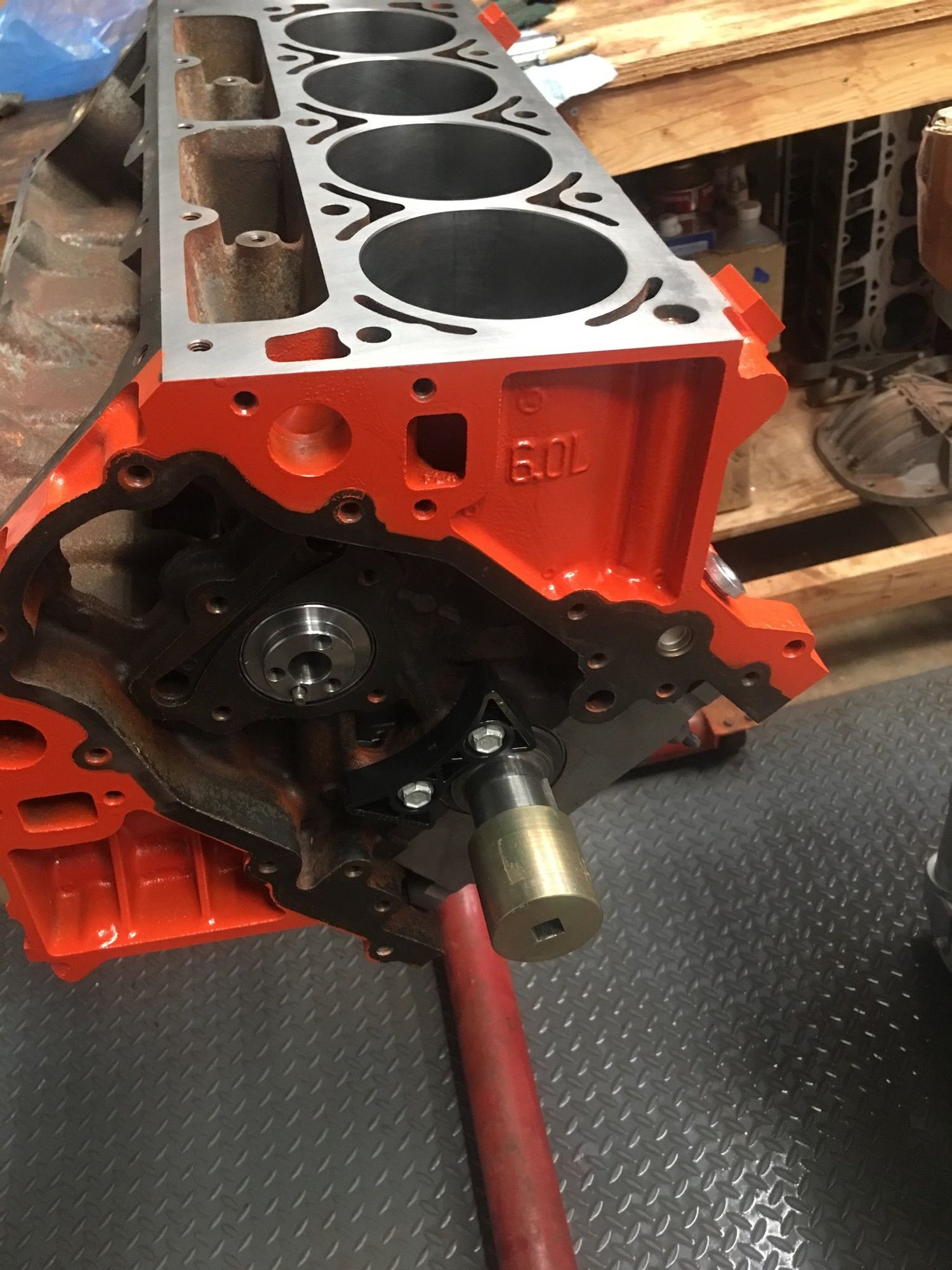

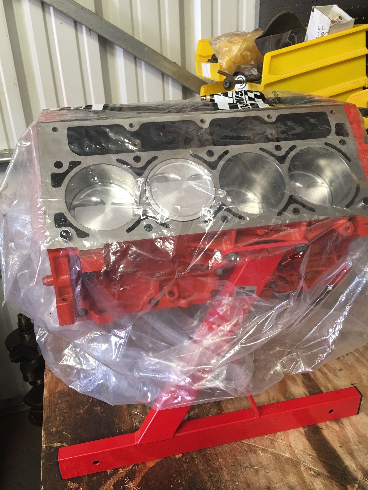

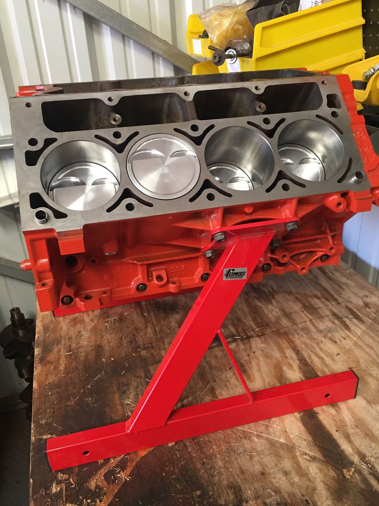

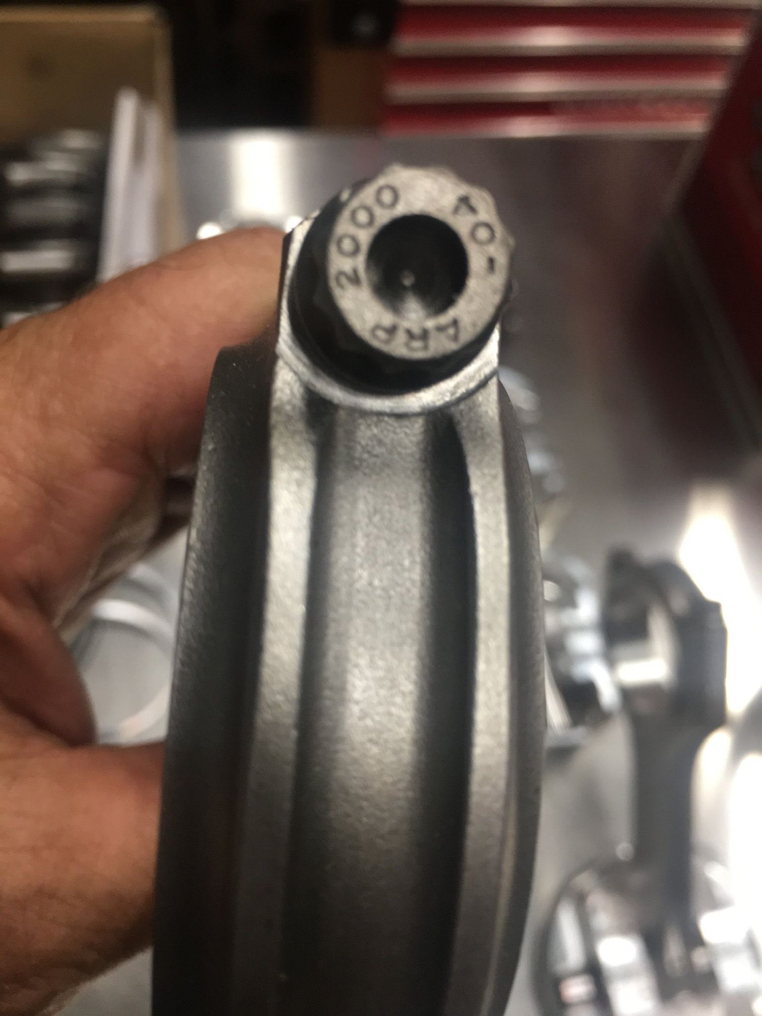

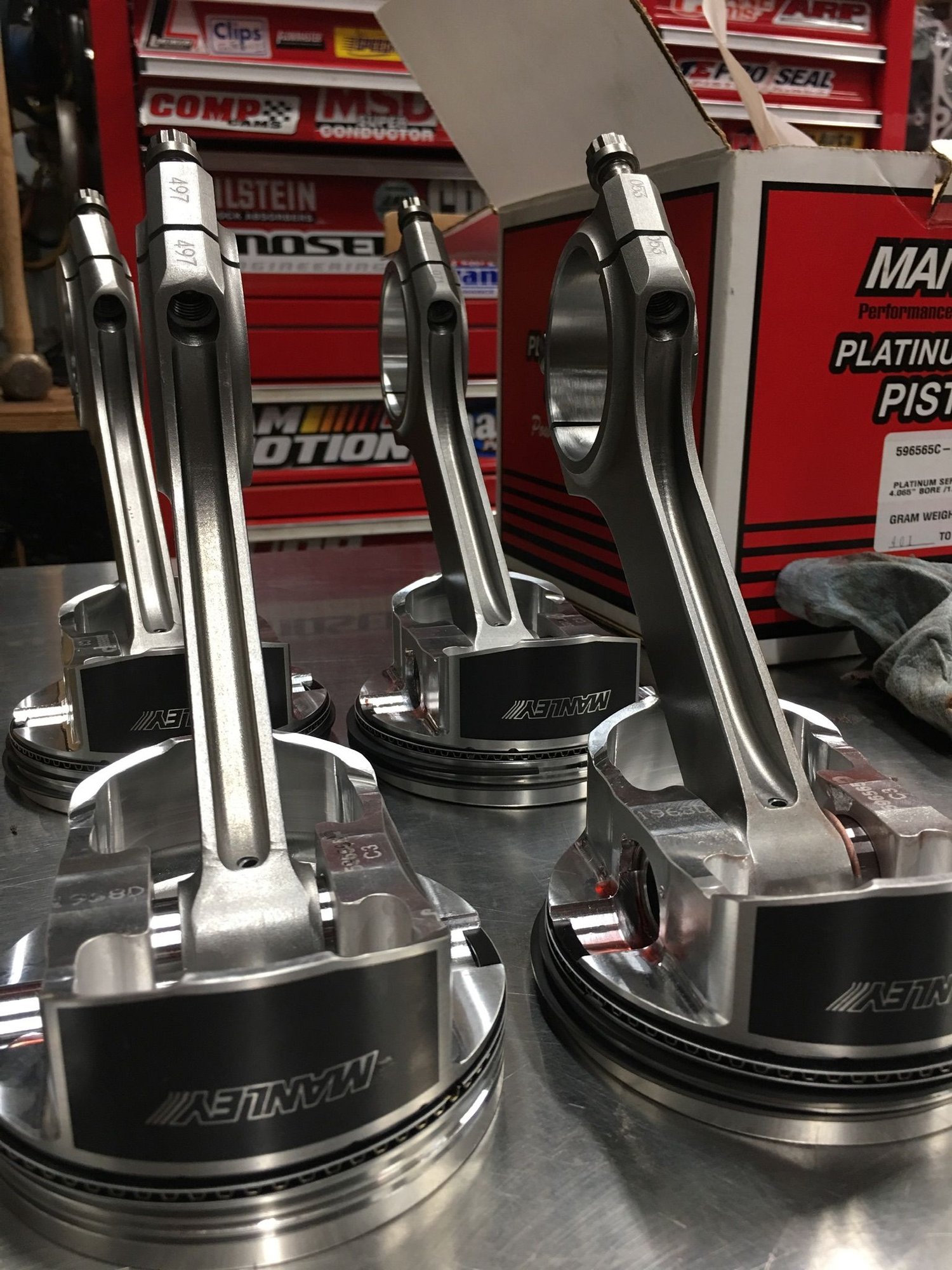

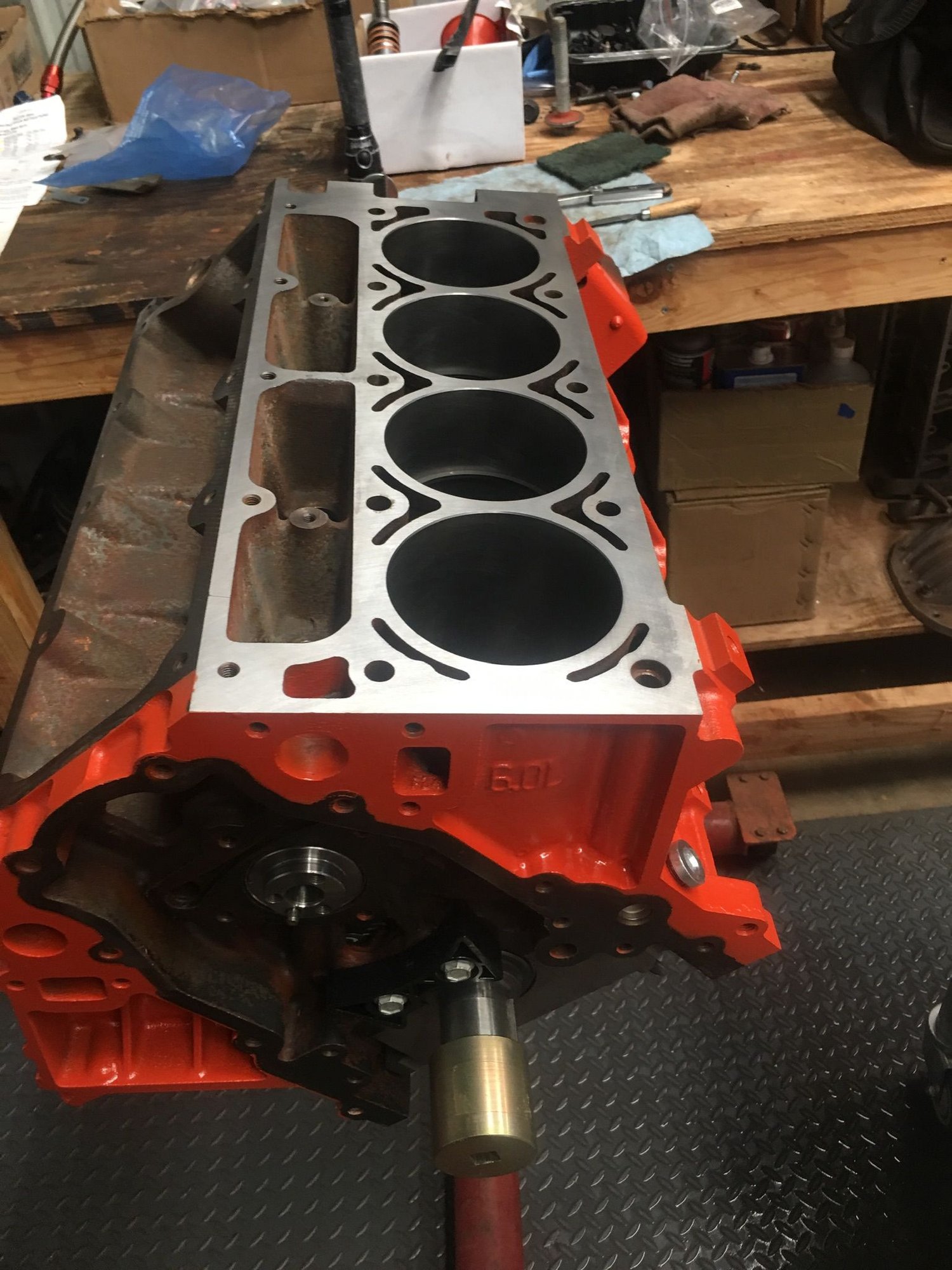

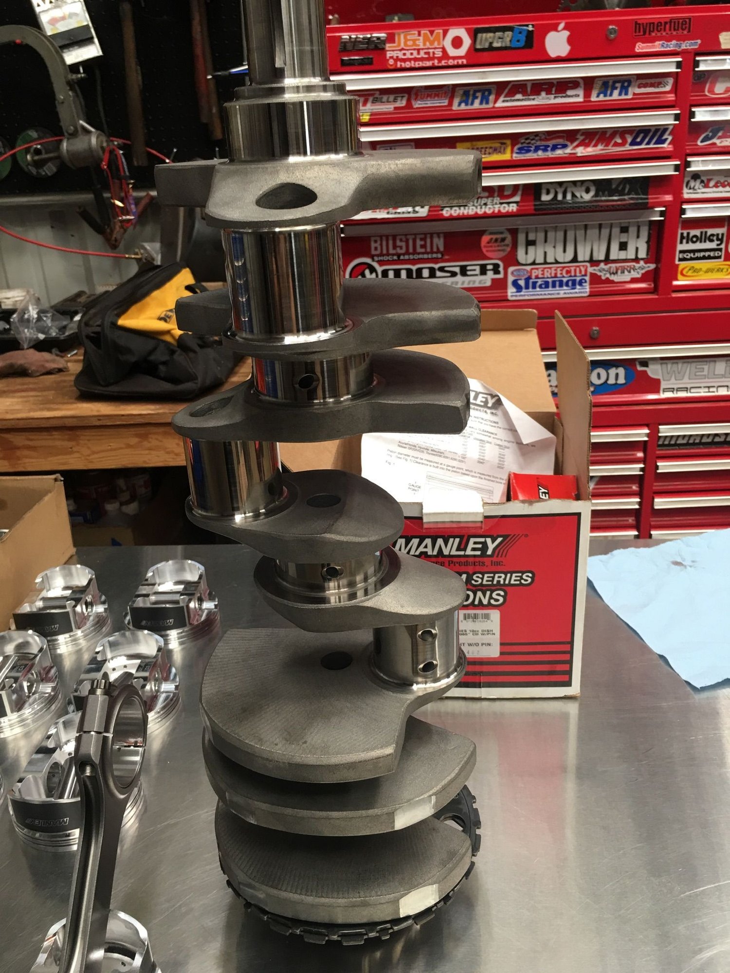

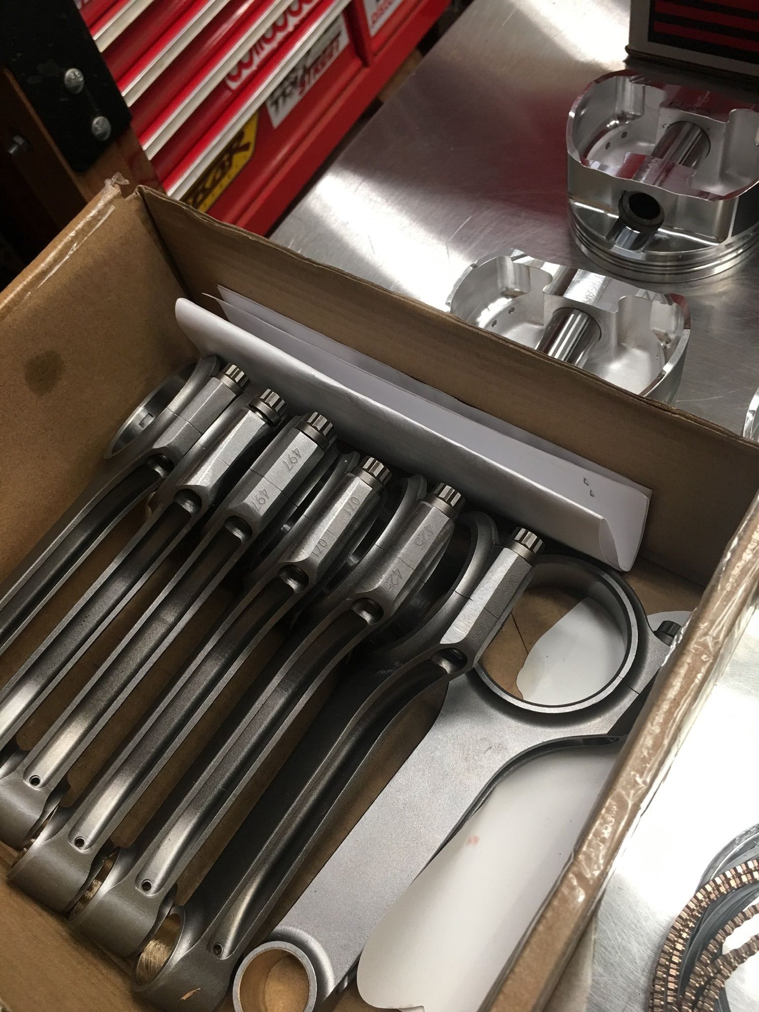

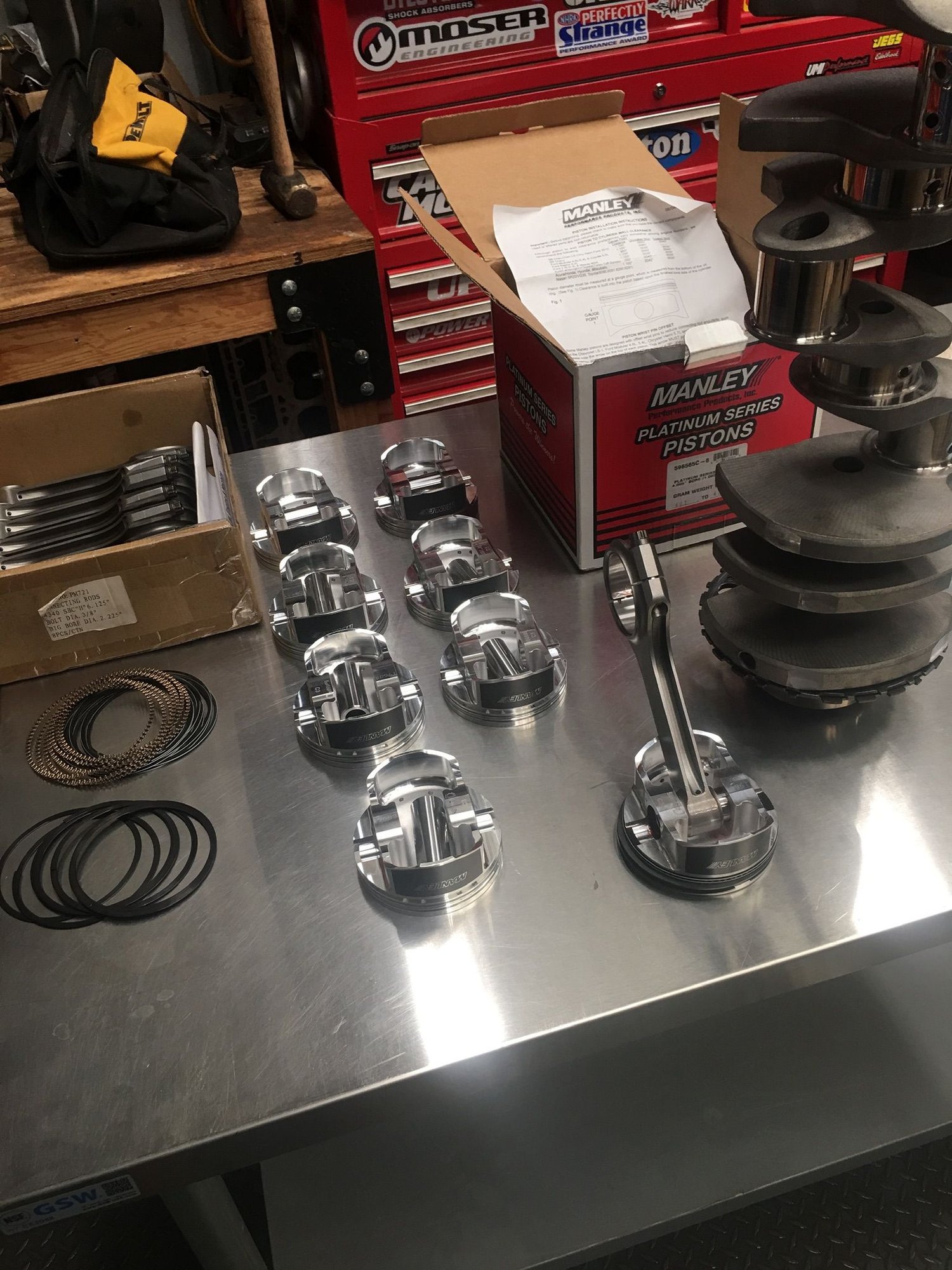

This was one of the LQ4 blocks laying around that became a stroker after it was discovered that the LS3 block that was going to be used wouldn’t work with stock bore pistons, it needed to go .005” over to clean up. So, we bored this block .065” over. Manley 4.100 stroke crank, Manley 10cc pistons with 1.065 CD, 6.125 H beam rods with ARP 2000 bolt upgrade.
. Surprisingly it didn’t need a bit of clearance grinding I at the base of the cylinders for rotating assembly. Maybe I’ll slap a set of unsellable LS7 heads modified for smaller bore on this in the future, not sure yet. The cam pictured in the block was set in just to be sure it turns free without binding issues. If it does get the LS7 heads then it’ll get a specced camshaft.

Interesting build!
Would like to hear more about the pistons. What material are the Manley pistons 4032 or 2618? Coatings? Trick features? Weight?
2618, coated skirt, 408 grams bare, oil rail support, typical stroker piston, .004” piston to wall clearance, .004” out at TDC.
