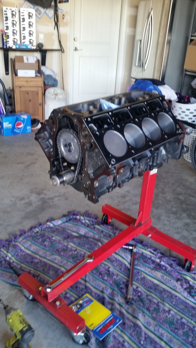

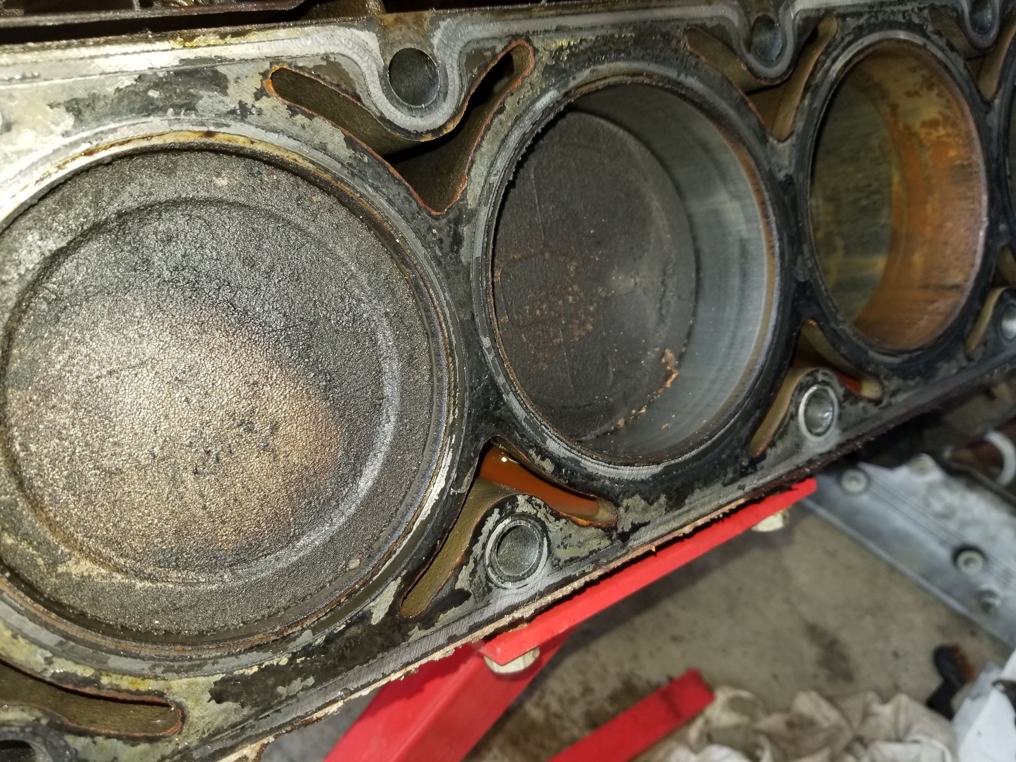

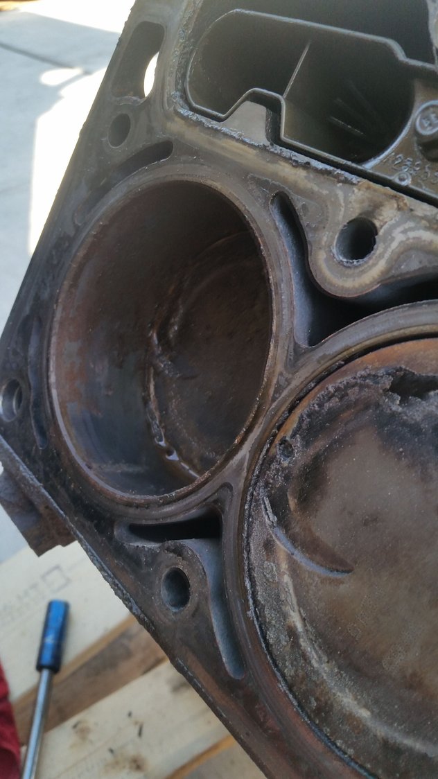

So I knew I had bad compression in cylinders 5 and 7, I also knew there was a little surface rust on the valves on those cylinders. I pulled the head off to assess the damage and this is what I found. I'm very experienced in working on cars, but this is my first deep dive inside of an engine.
This is a stock junkyard 5.3 L59 that is going to get put in my K5 Blazer. I got it for pocket change compared to most. Am I looking at something I could fix with a ball hone and a re-tube or is this full on send it to a machine shop? Or am I just better off just buying another one?

If you’re on a tight budget, a ball hone and rings would get you by. The rust doesn’t look deep except in a few small spots. If you want it done right, and to last, have it honed .005” at a shop and get new pistons. Really depends on long term goals here. I’d go ahead and tear it all the way apart and have a looksey first at everything.

I would clean the surface rust off with a fine scotch bright and then see what you have for pits. I've seen worse run just fine and regain some compression after it's had a chance to wear back in if the pit's aren't deep. That looks more like surface rust from condensation rather than water leaking in. You'll have to decide if it's worth taking the time and money to drop it in and run it to see how it performs. You have the cost of gaskets/bolts/oil and your time.

After you clean the rust off it should feel fairly smooth everywhere unless it's pitted, A few pits aren't a deal killer. If you have a decent amount that feels like orange peel or worse when you run your fingers across it you may have some blow-by when you run it. From the pictures it doesn't look that bad.

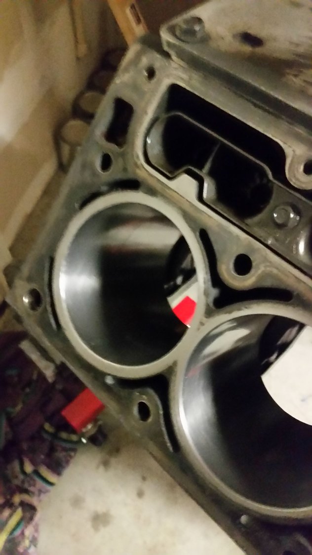

My l96 before the dingleberries. .....
After.....youd be surprised! !!!!

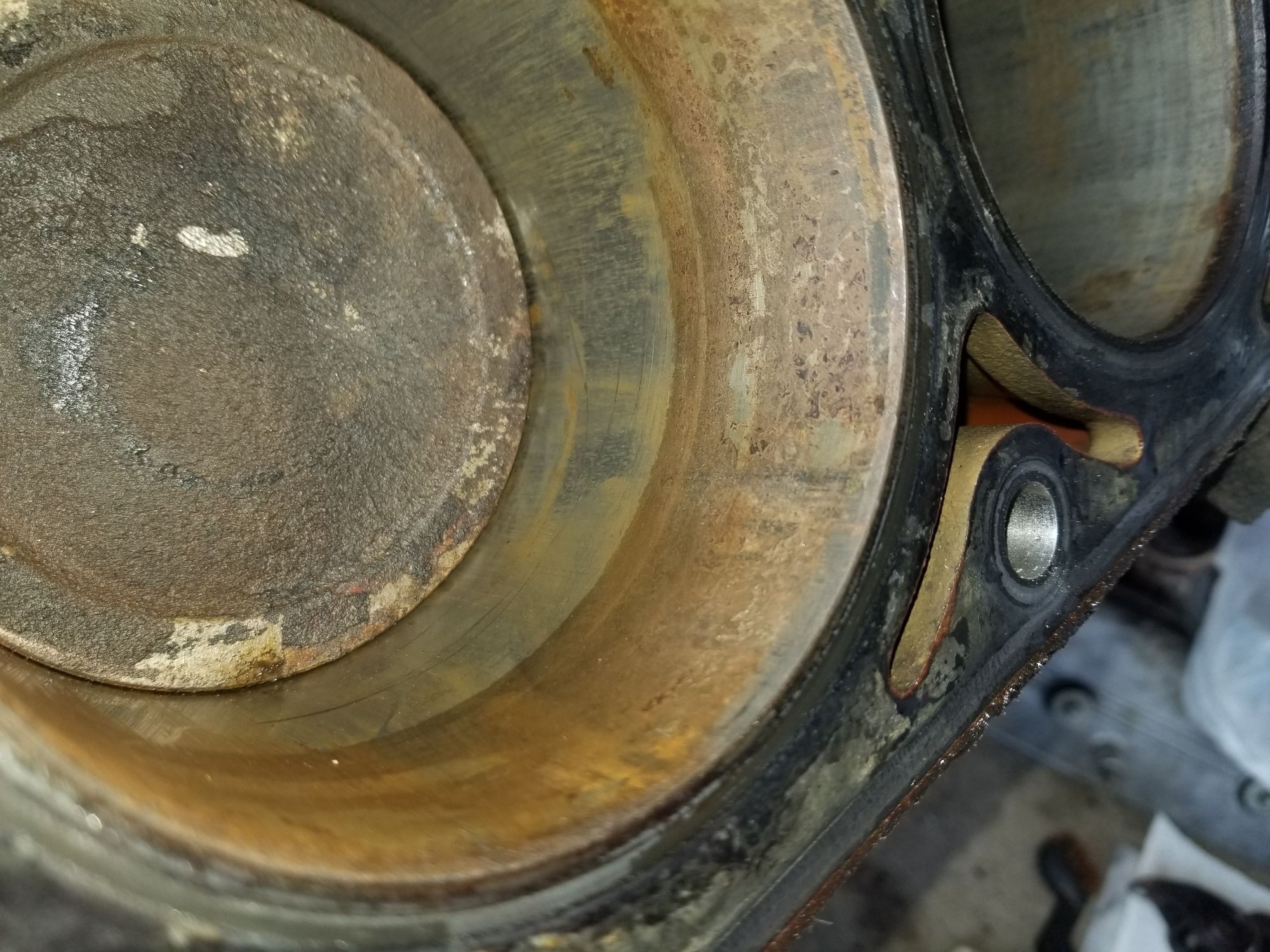

The engine above looks like that from a valve being open on that cylinder and sitting in a humid/wet environment for an extended period of time, not from a head gasket leak

Bingo. This was sitting in a back yard in South Carolina for about 2 years. Tahoe still had a hood, but no fenders.

In my case (the engine above) the oil was "clean", it had no water in it, the entire passenger side bank has good compression and so did cylinders 1 and 3. That pretty much confirms it's not a head gasket. I'm pretty sure my bad compression on 5 and 7 are a combination of what you see above in cylinder 5, and surface rust on the valves for 5 and 7, which is what I pulled the heads apart to fix in the first place.
