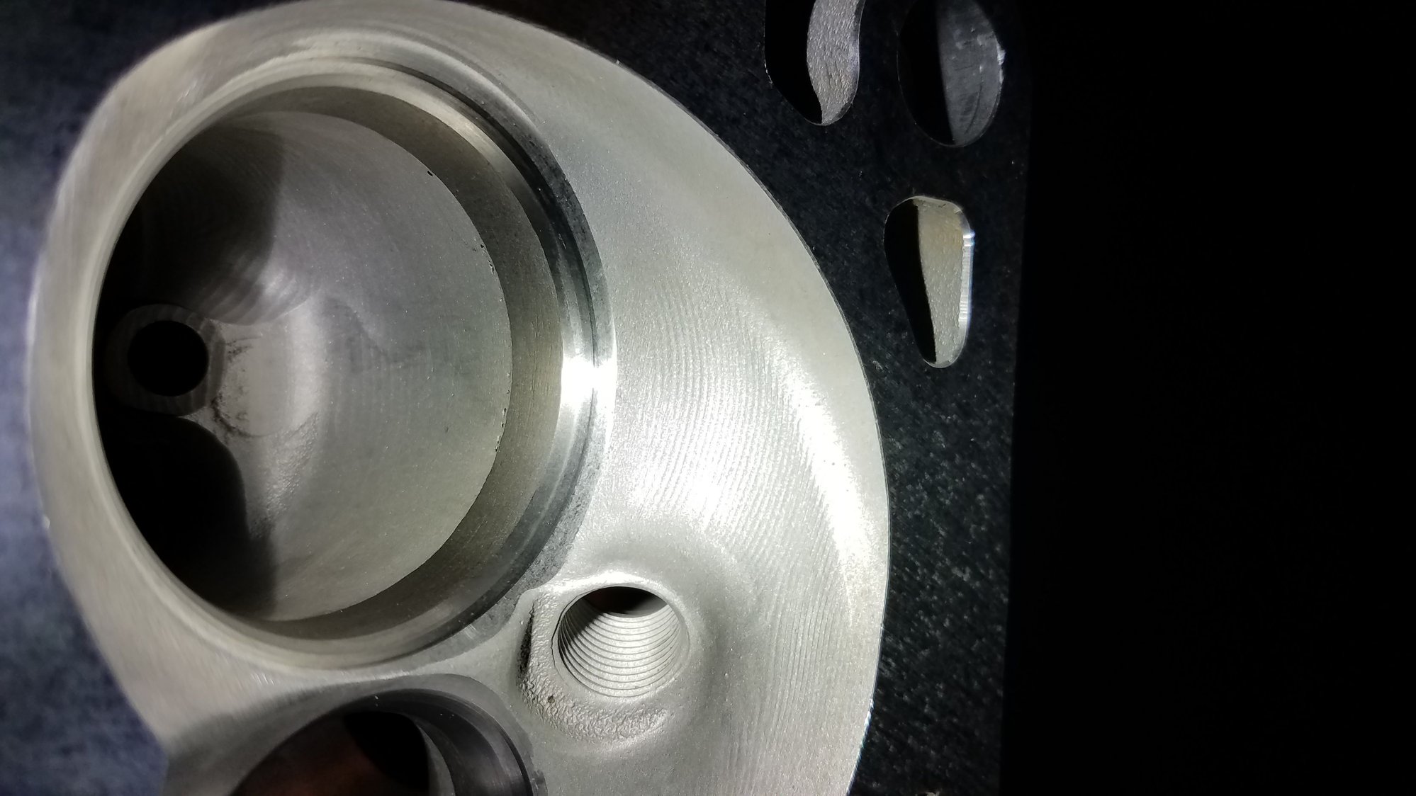

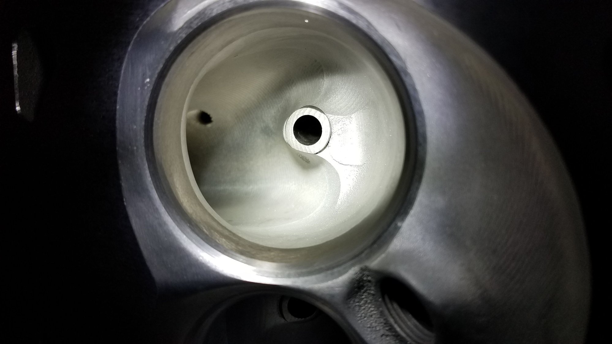

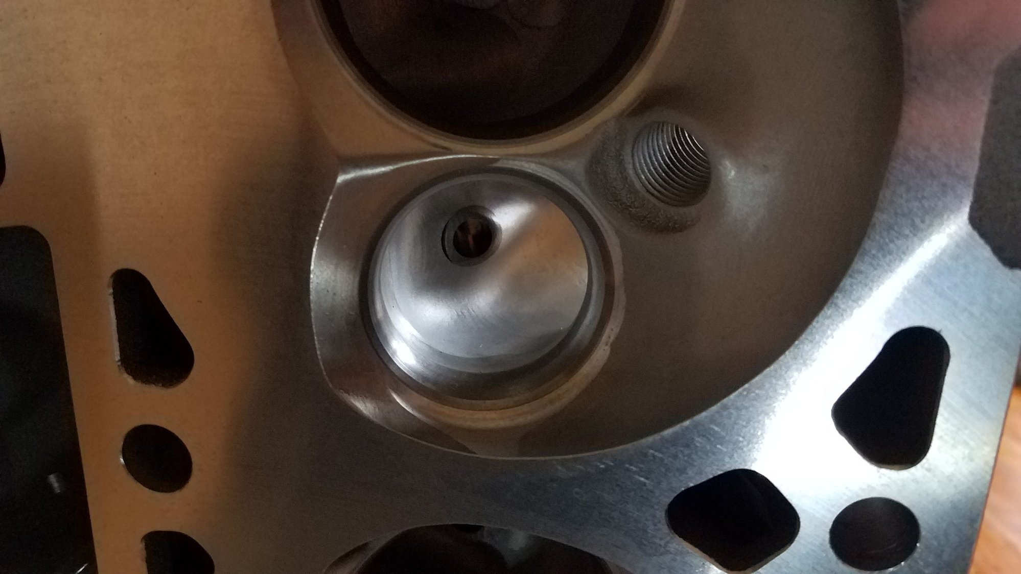

Long time ago i bought a set of used 5.3 stage 1.5 TEA heads from a respected board member.
Ran them for a while, had a Comp Cam fail on me. Found a bunch of caked on oil in the exhaust ports.
Ended up putting the car back to stock at the time for money reasons. I finally decided to do something with the car again. Sent the heads back to TEA for a valve job, which ever one BTR likes, I think the exhaust is cut different and all new guides and have them flowed.
Greg calls me when they were done and gives me the total. It was way cheaper than what I was expecting. He said they checked all of the guides and said they were good. He said "We aren't going to do something you don't need and charge you for it."
The heads look really good. I had a cam spec'd for it a while back and looking at the flow numbers I probably should have waited to have the heads flowed before I had the custom cam cut for it, but it is what it is.
I just wanted to pass along my experience with TEA and say I would do business with them again.

The flow numbers are weaker at .600 than I expected but the heads have been cut down .030 so from little I know that can hurt flow.
Regardless it's going together and see what happens.
