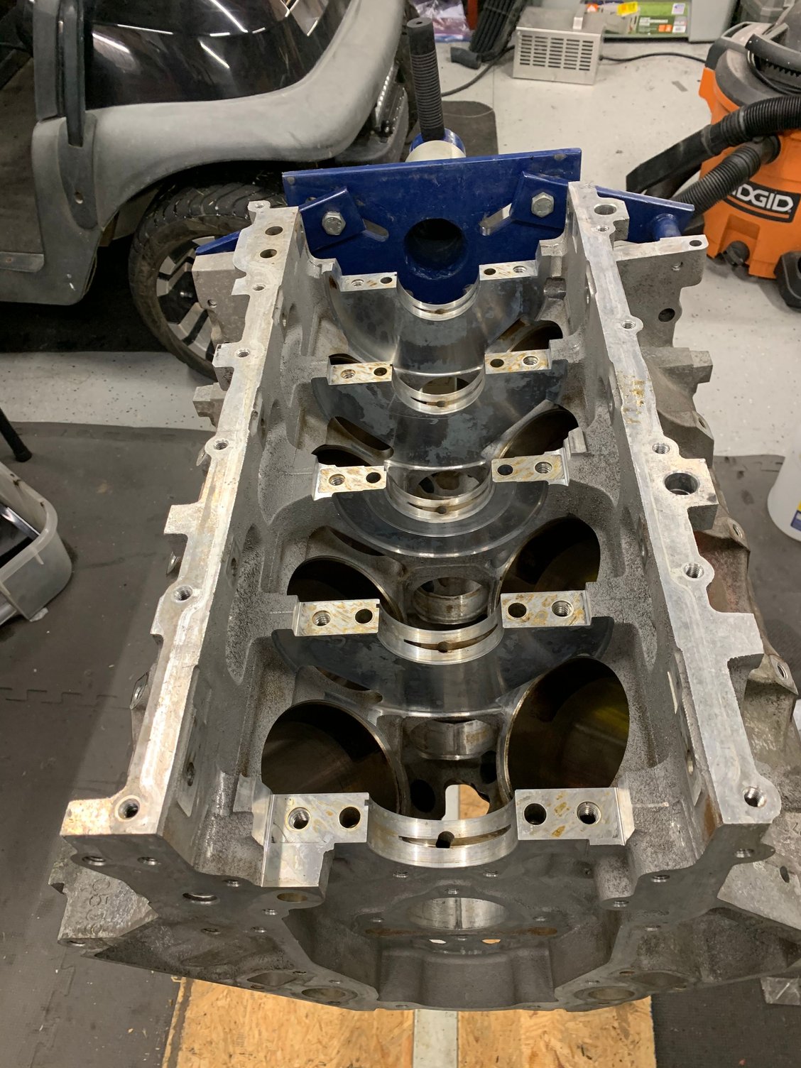

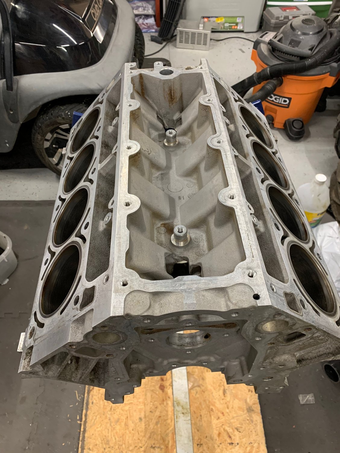

I stripped the engine down. Removed the cam bearings. Had to make a to for that. Then I Soaked the block a few times in purple power. Pressure washed it. Ran long brushes through all the oil passages and cleaned everything out. Rinsed. Hoses the cylinder walls down with oil. Then blew it all out with compressed air and let it sit in front of my shop heater for a while.

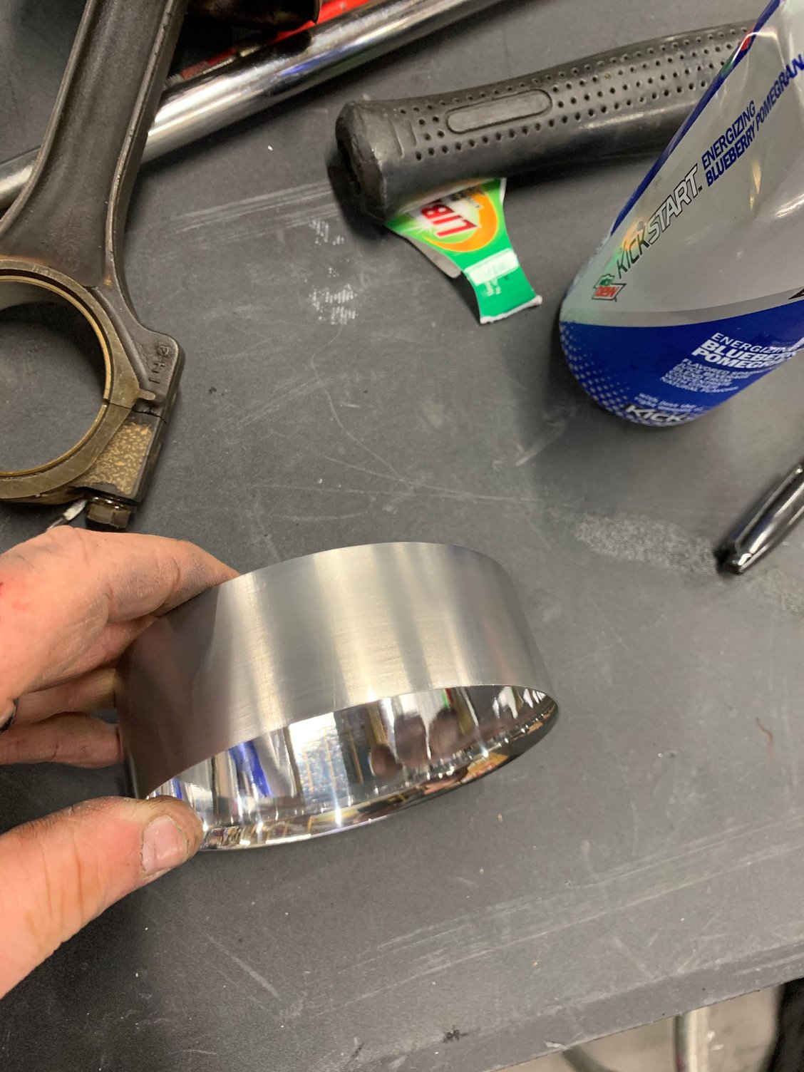

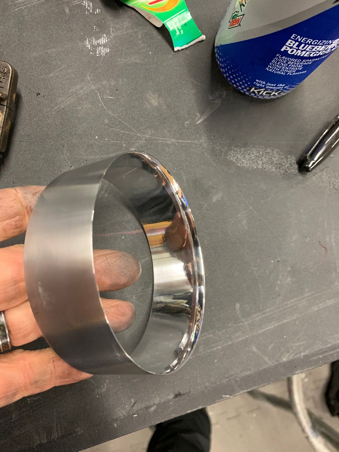

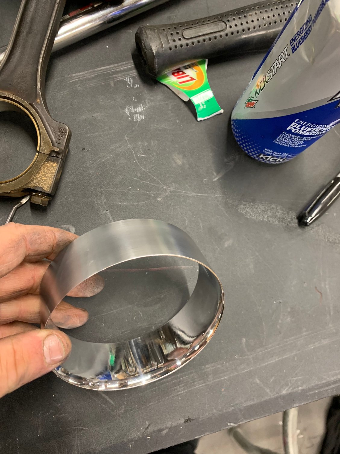

Them I made a much needed tool. A piston ring compressor. I looked online first to see how much one was. $40 and up. The cheap ones didn’t look tapered. So I decided I have material to make one, why the heck not. It’s probably better than what you buy. I tested it when I was done and made it worlds easier than those stupid ones that are like a band that you compress around it, and cut yourself on. Ugh.

no one in town line hones, I called around and no dice. So, one place said they Line BORE for $350 (ouch). I was told by that same machine shop to just check it and they usually dont need it. I was also told by two close friends the same thing. One of those friends is the ONLY other person besides myself, that I would trust to build me a motor. He builds dozens of LS engines a year.....he does it for a living. I may bring him my bottom end and have him check it for me to make sure.
Another option is I see PRO Comp (speedmaster) sells main studs. My train of thought leads me to this:
I saw a head bolt/stud test. The pro comp studs was about as strong as stock bolts. Pretty pathetic, however, Say I decide to go back with stock bolts, I'd be better with the procomp studs because multiple torque's on the stock studs to check clearances doesnt sit well with me, because , you know....screwing bolts into aluminum. So the studs would take the wear on the aluminum out of the equation, not clamp any better than stock so it may not distort the bores. Or am I just dreaming........
