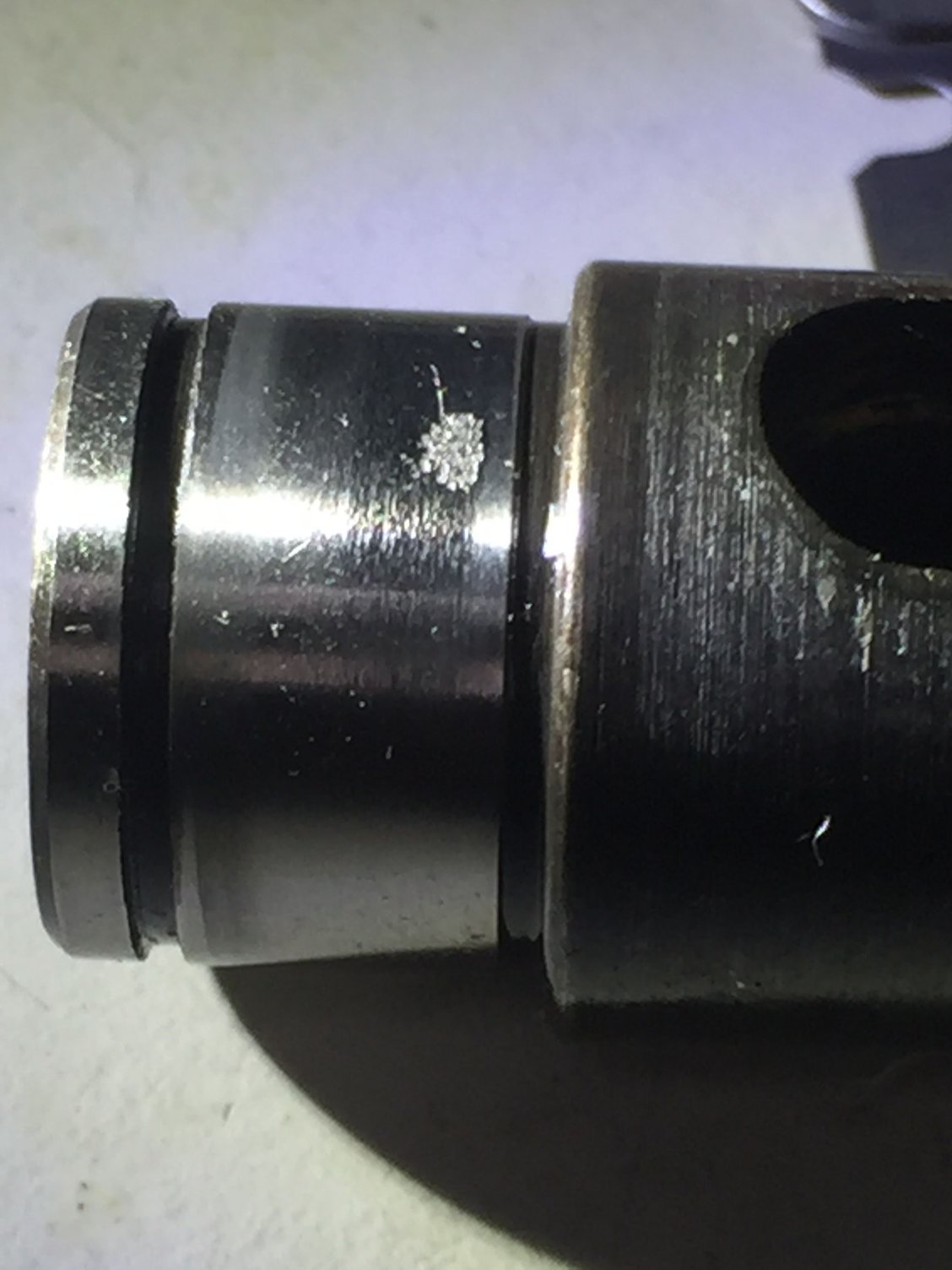

Been meaning to look at mine since the engine is apart. these are Comp's. I used Tooley's in another engine, I wonder if they are also Comp? Dunno.
Maybe 2k miles, 150 or so passes.
Just starting to fail. So won't be going back in. Obvious they just used poor material and didn't harden them good enough. Pretty frustrating.
Back to the drawing board I guess.

Not trying to derail from the original posting. but I'm glad I've read this thread. I've got this Comp trunnion upgrade kit that I purchased from someone. Doesn't look like I'll be using it after reading all the issues with all the trunnion wear. The box is dated 08/14/17.
Could the wear be attributed to and or because of ZZDP(Zinc & Phosphate) wasn't added to the engine oil?
The original GM rockers I have are used but from a working LS3 engine, maybe I'll just leave them alone? Camshaft I'm going to be using has .568" lift.

The issue was with Comp trunnions themselves, due to bad metallurgy that caused premature wear and flaking of the surface metal.
EXACTLY!
I bought mine in 2014. I just don't street drive the car all that much.
The real question is, did they correct the issue? I've never read anything to that effect.
I think they should replace them for free.
If your used rockers are in good shape, ie good pushrod cups (I've seen failures there) and the tip isn't worn where it contacts the valve stem, I'd use them no issue.
