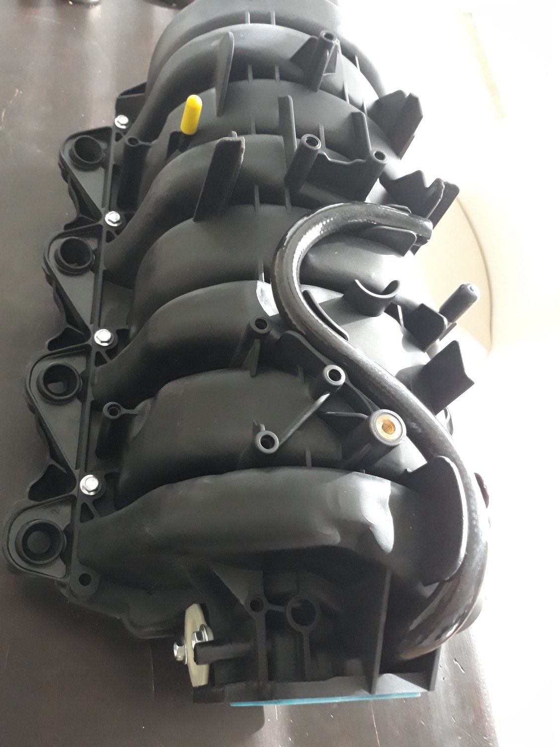

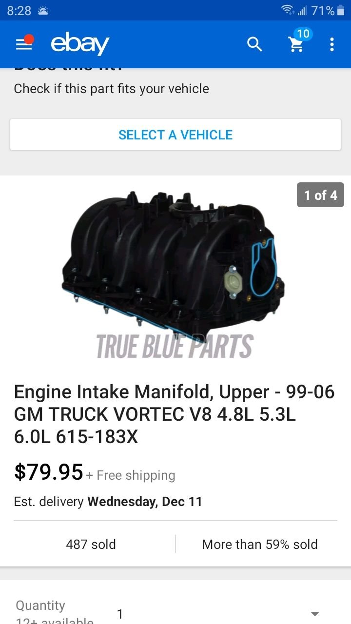

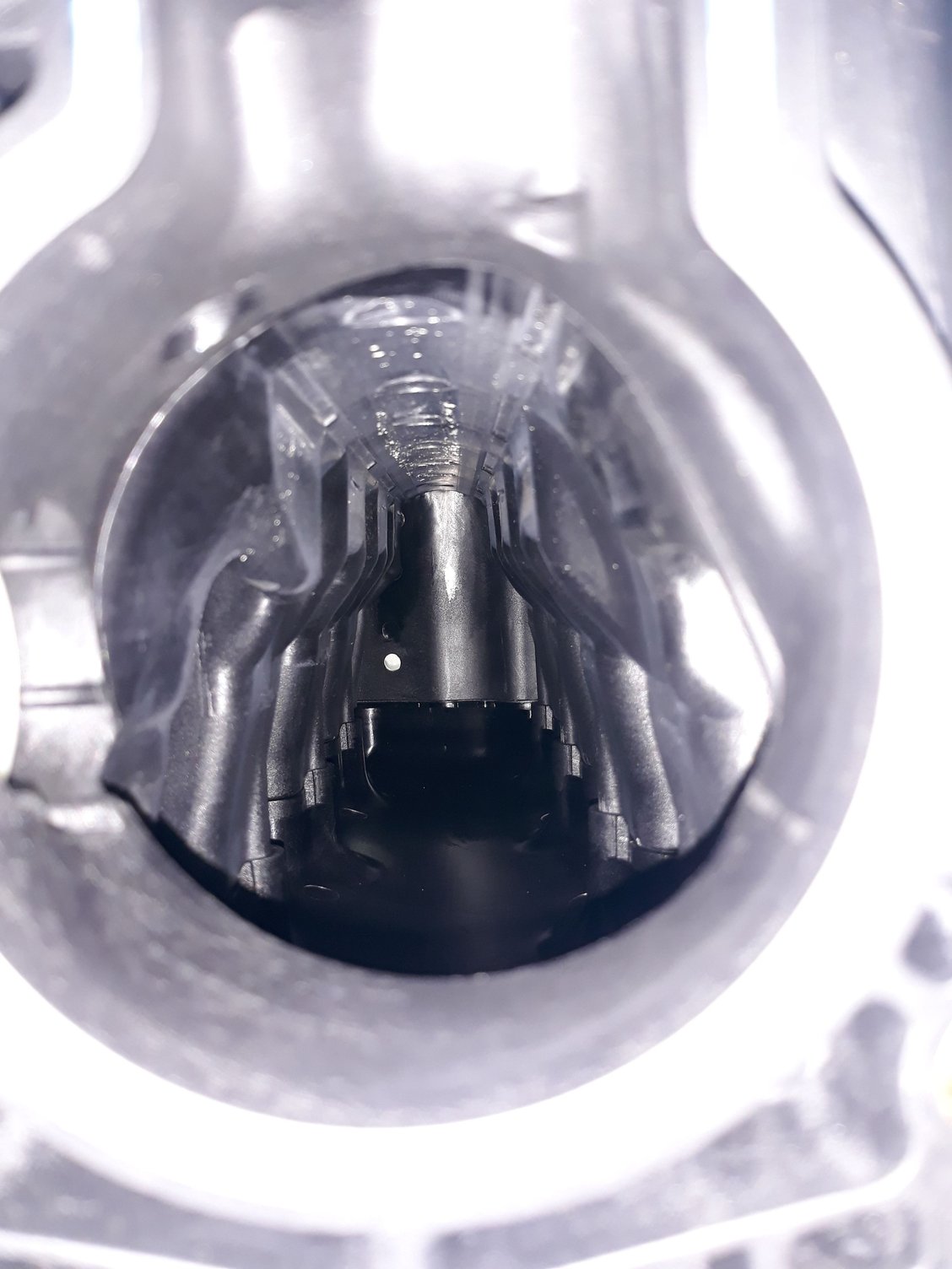

Adding another intake to the "game" the dorman or dorman replica 615-183 truck intake.
I have a comple old style truck intake with rails inj. And dbc tb. thus parts would fit right on.
this intake is a 3 piece and as far as i understand comes close to the tbss performance.
+ you can port it easily.
Now.. would a102 mm tb work on this guy IF ported?
It would flow well, but I wouldn't try to put a102 TB on it. I doubt there is that much meat to port out to fit it.

615-183x intake came.
I can definitely see why it is a tbss competitor lol.
Some portwork will be needed but who can complain at 79$ shipped?
Old Dec 6, 2019 | 11:32 PM
  #56
wannafbody's Avatar
Posts: 5,589
Likes: 1,140
From: Pittsburgh
Might not be too ugly if shaved down on top.
Old Dec 7, 2019 | 10:44 AM
  #57
Sebambam's Avatar
Joined: Nov 2015
Posts: 384
Likes: 53
exactly, And as far as i know it will clear the stock hood on my GM A-Body at least it did on a Cutlass lol.
