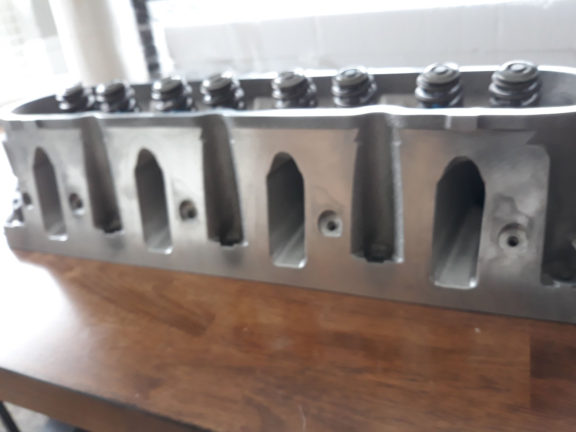

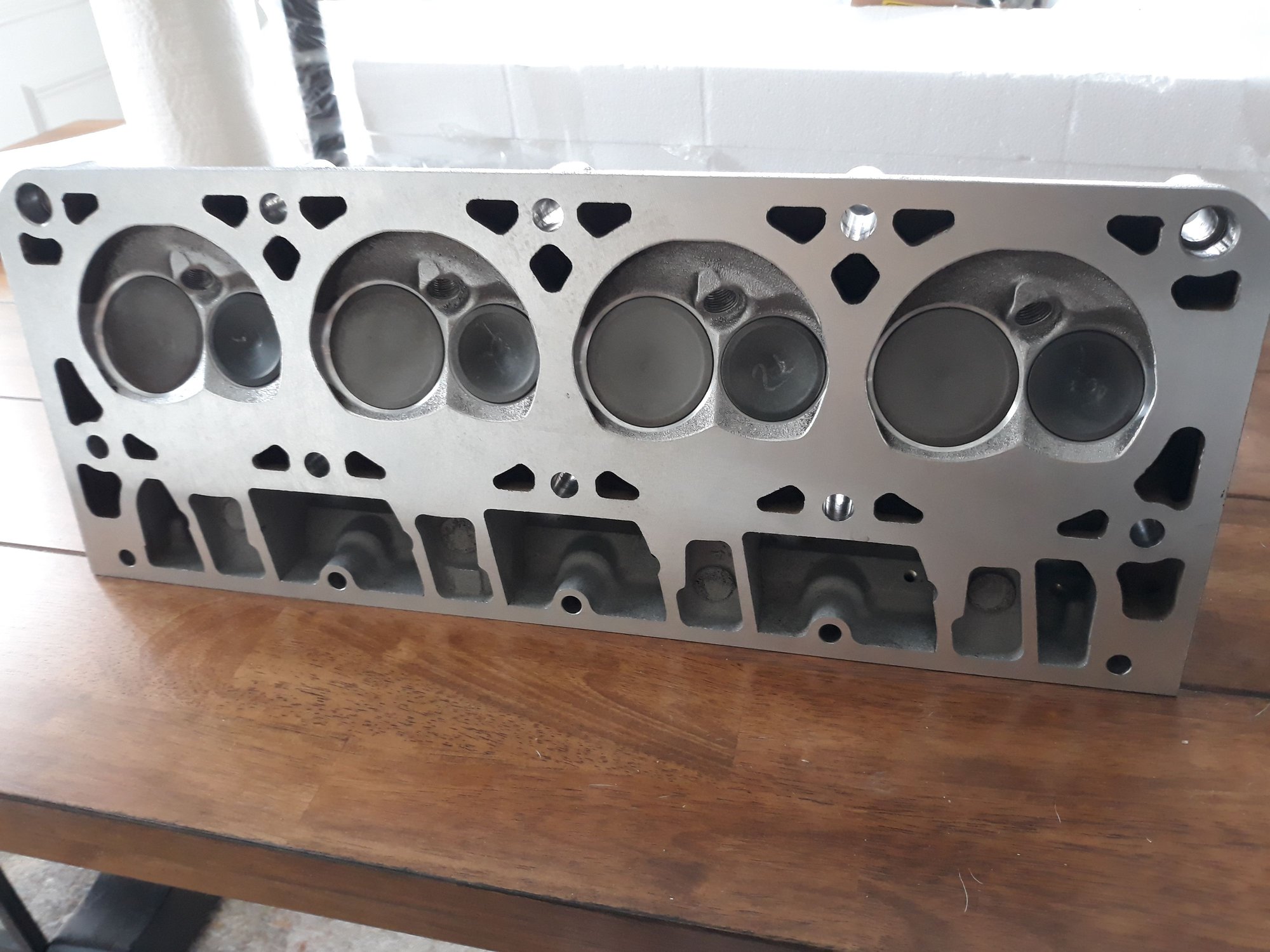

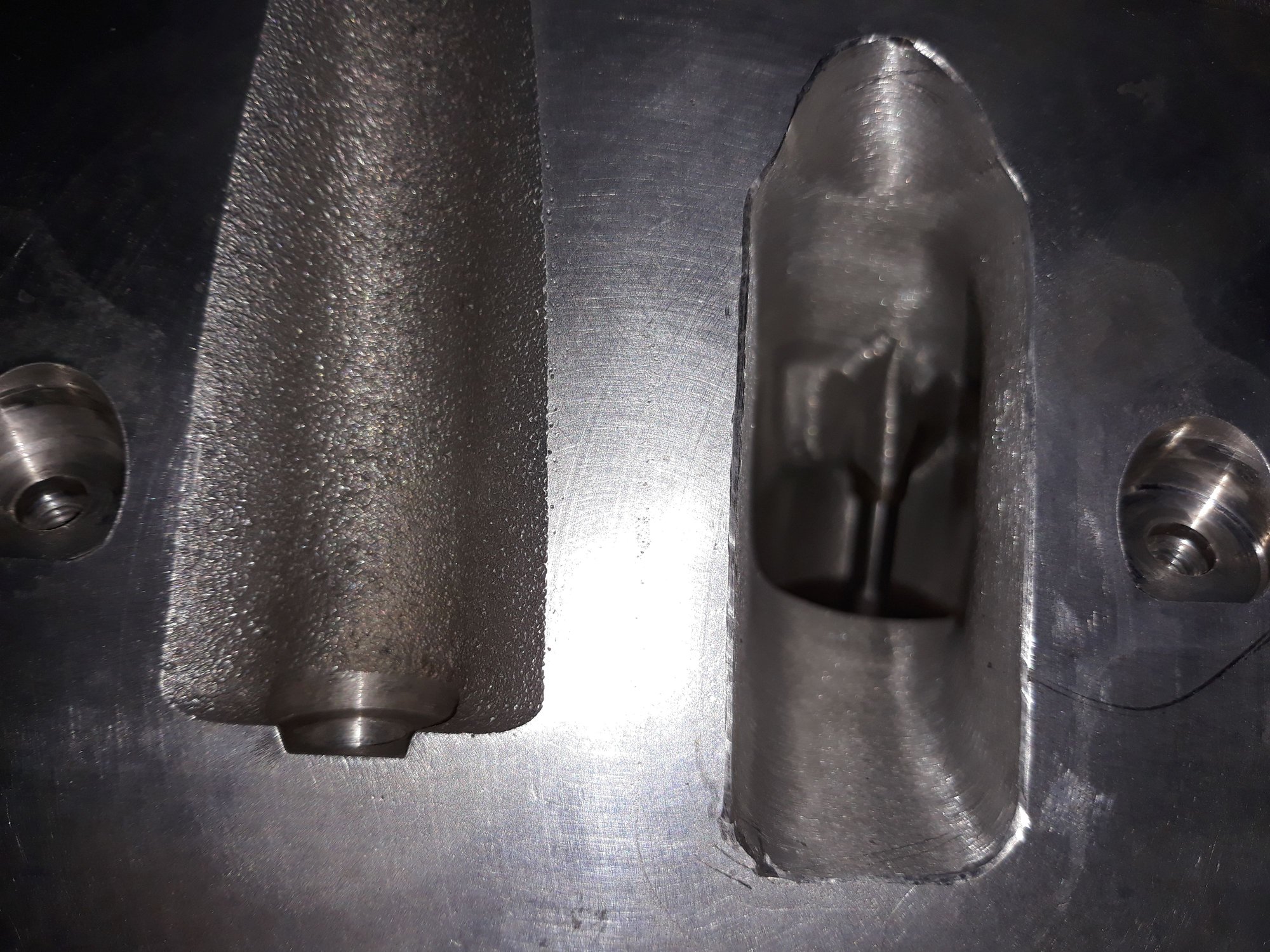

862 heads
trick flow springs .625 lift
full port job by Lloyd Elliott here in DFW.
+ 2.00 valves. 0.20 milled to bump up the compression a bit more
Should flow well and give a couple extra ponies on a stock lq4 block.
