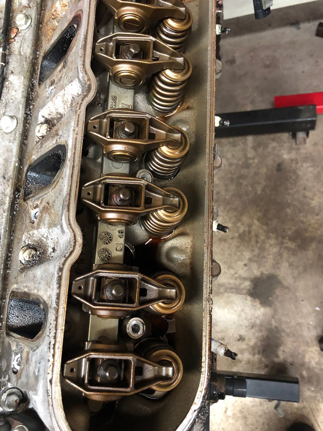

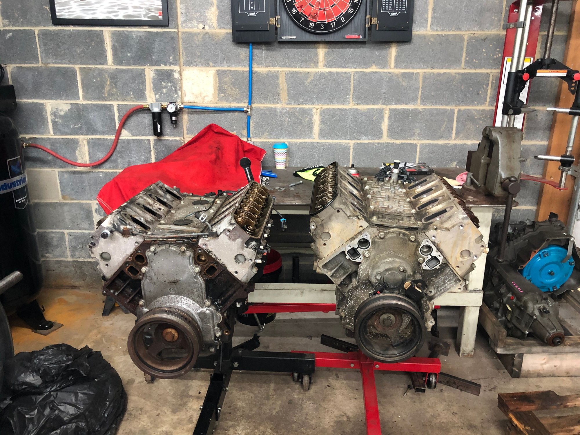

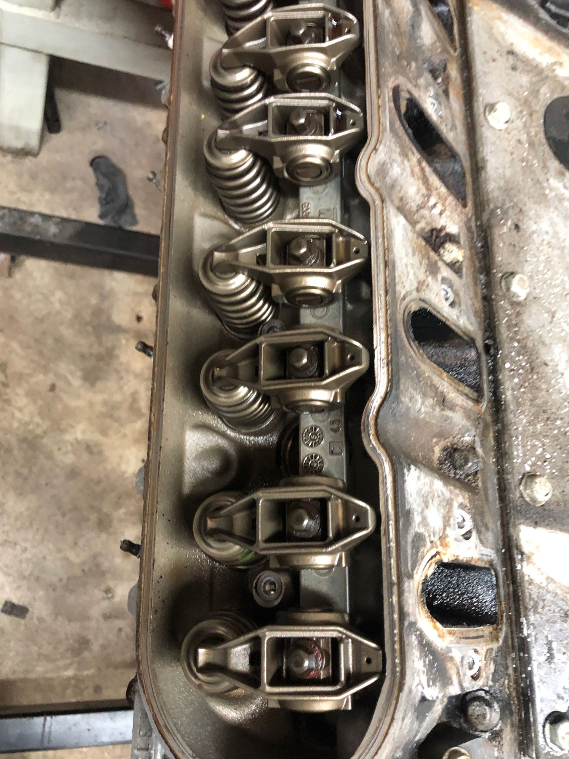

The Fun Begins!
Old Dec 10, 2019 | 04:15 PM
  #34
Speedman87's Avatar
Joined: Dec 2019
Posts: 31
Likes: 8
Old Dec 10, 2019 | 04:20 PM
  #35
Speedman87's Avatar
Joined: Dec 2019
Posts: 31
Likes: 8
Would someone know why on both engines the passenger side cylinder head and rocker assemblies are much cleaner than the drivers side???? Im guessing the way the pcv flows? One engines is a 04 lq9 and the other is a 11 LC9
Yes it’s the PVC setup. Clean side vs. dirty side. First LS I ever opened up, I thought the head/rockers/pushrods had been replaced on that side, it was so much cleaner.
