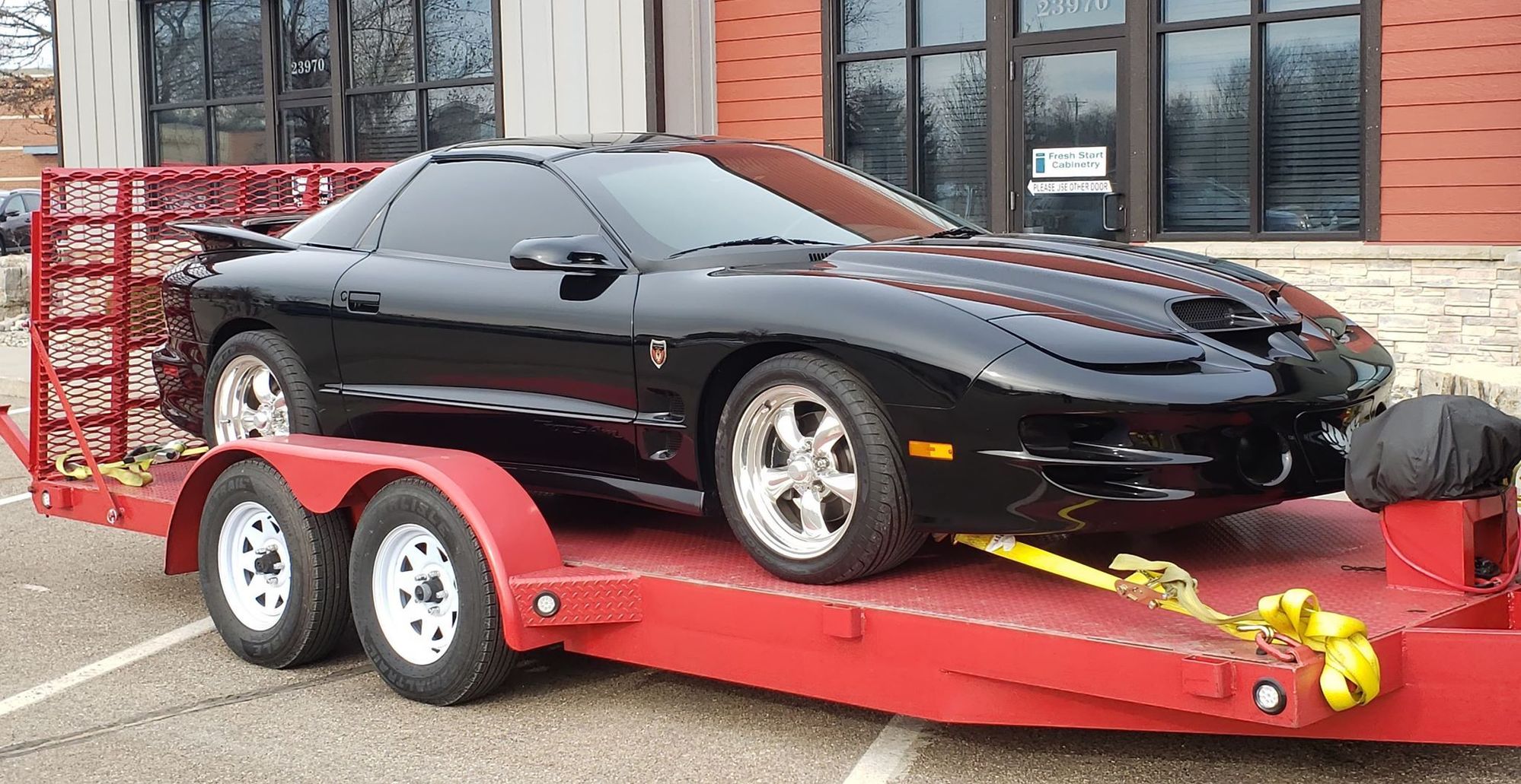

The "Eagle" has landed. 21,800 original miles and in almost new condition.

Posts: 7,802
Likes: 5,135
Un. Be. Leivable.
That’s crazy nice!
