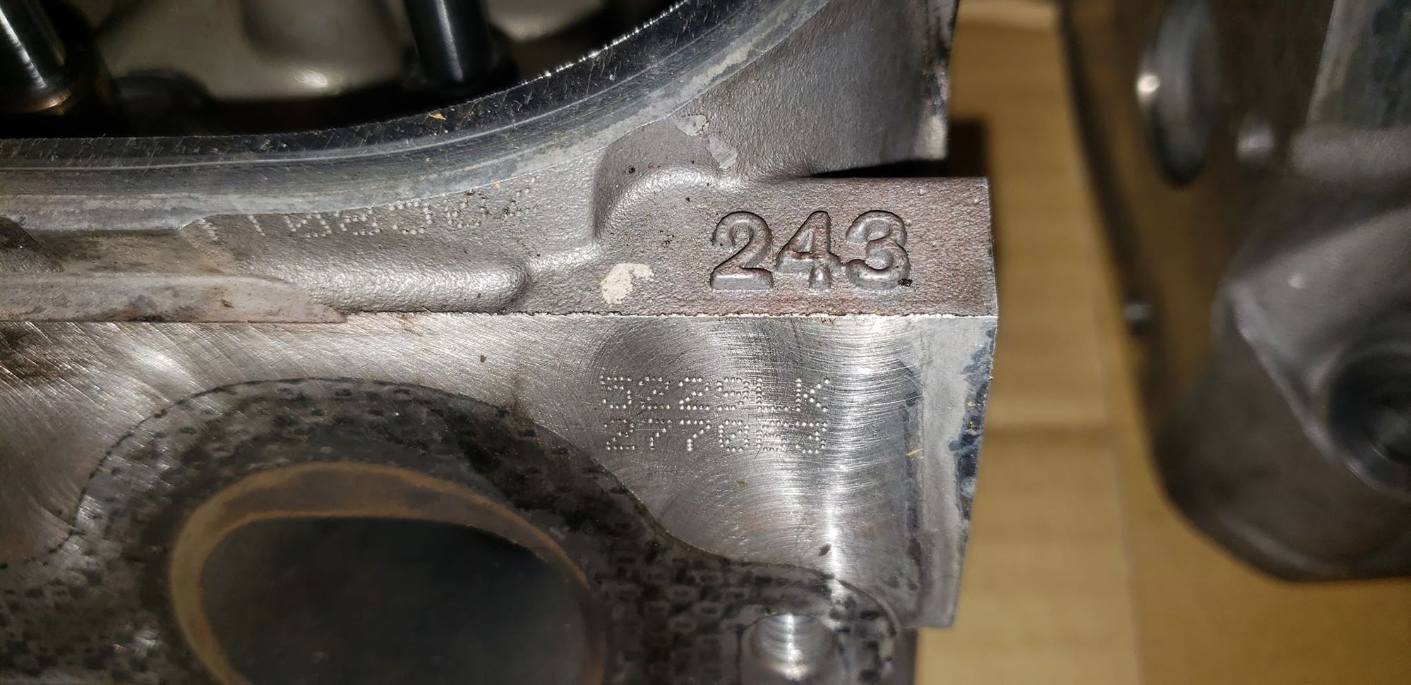

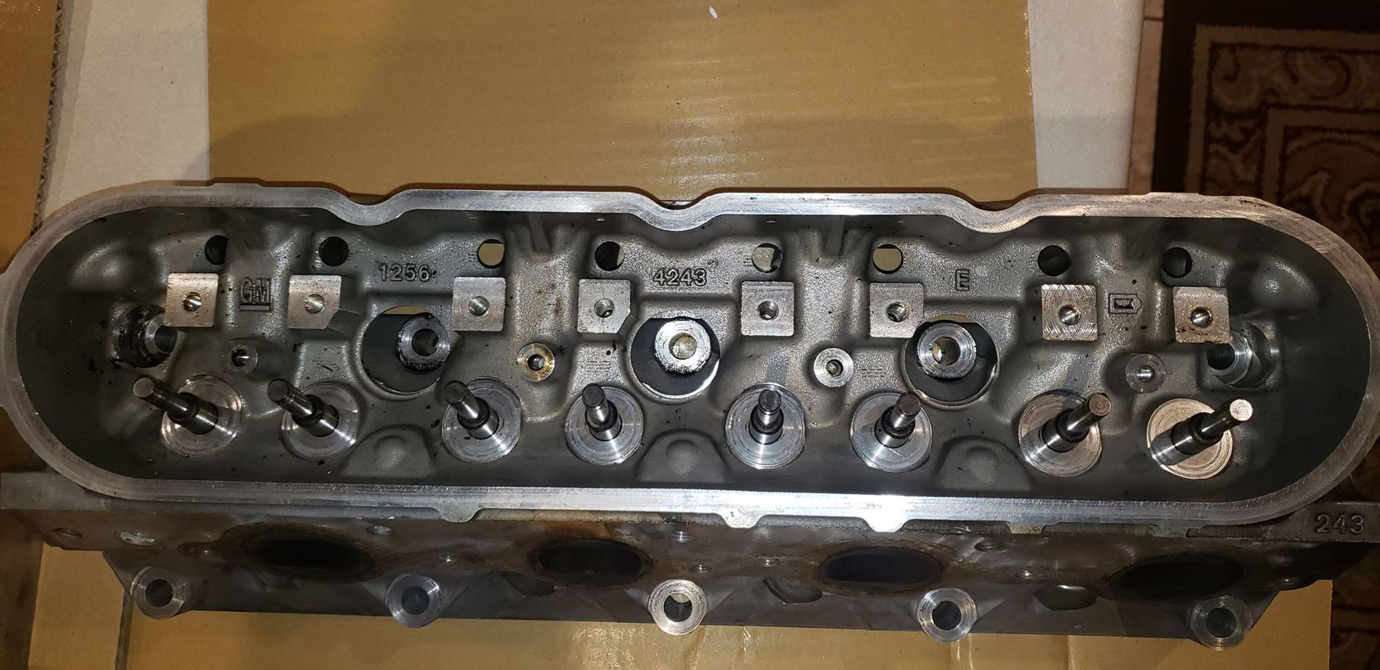

And the ball is rolling!!!
I ordered my Pat G custom speced cam this afternoon and my 243 heads showed up. These heads have 60K miles on them. They will be getting thoroughly cleaned, valves lapped, and hand ported. I'll be taking the intake bowls to 88% of valve diameter and the exhaust valves to 86%. I've bought a couple cheap valves to turn down in my lathe as go/no go gauges. I can't say that I'm looking forward to that much porting! This evening I'll be ordering the rest of the parts I need. $$$$$$$$$$$$$$$$$$$$$$$$$$
How can I tell if I got sodium filled valves?

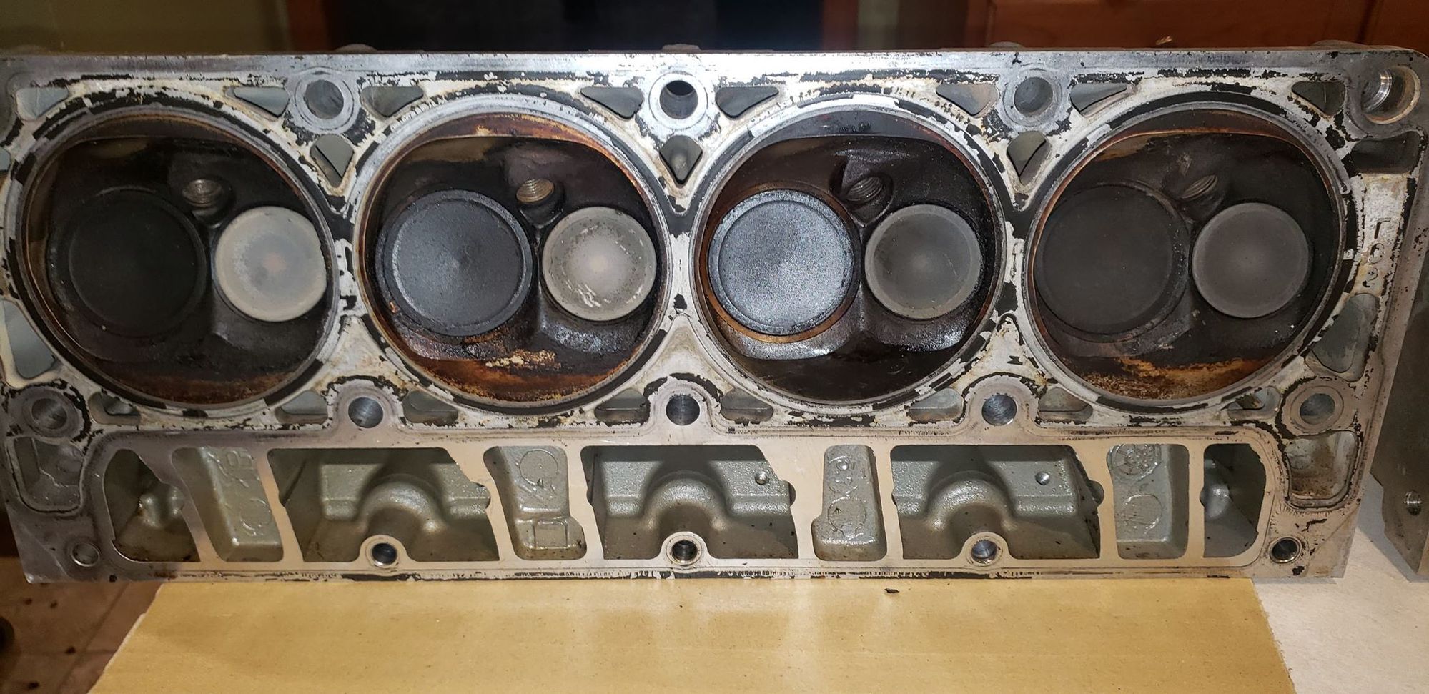

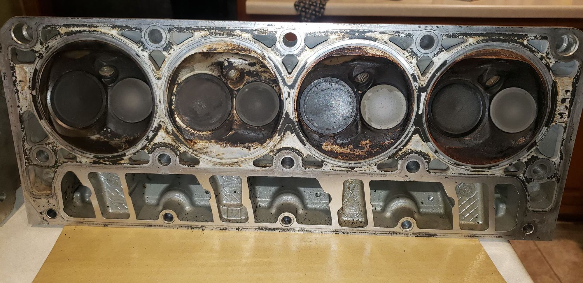

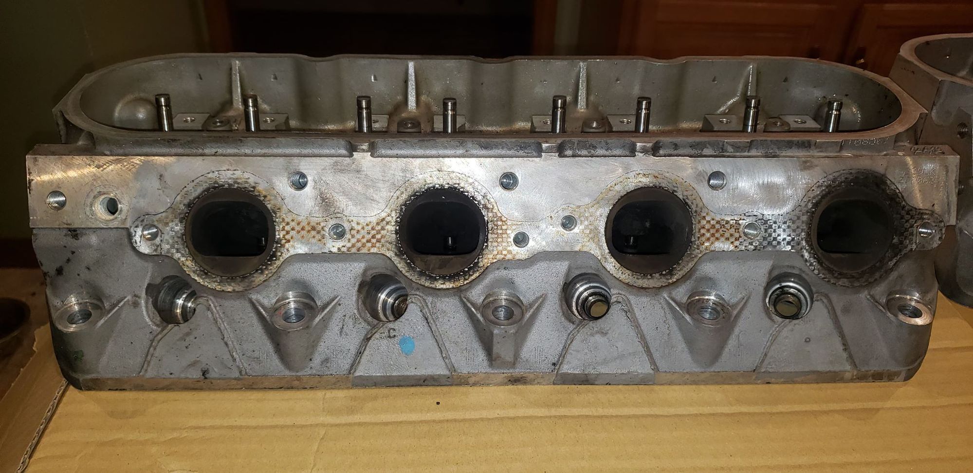

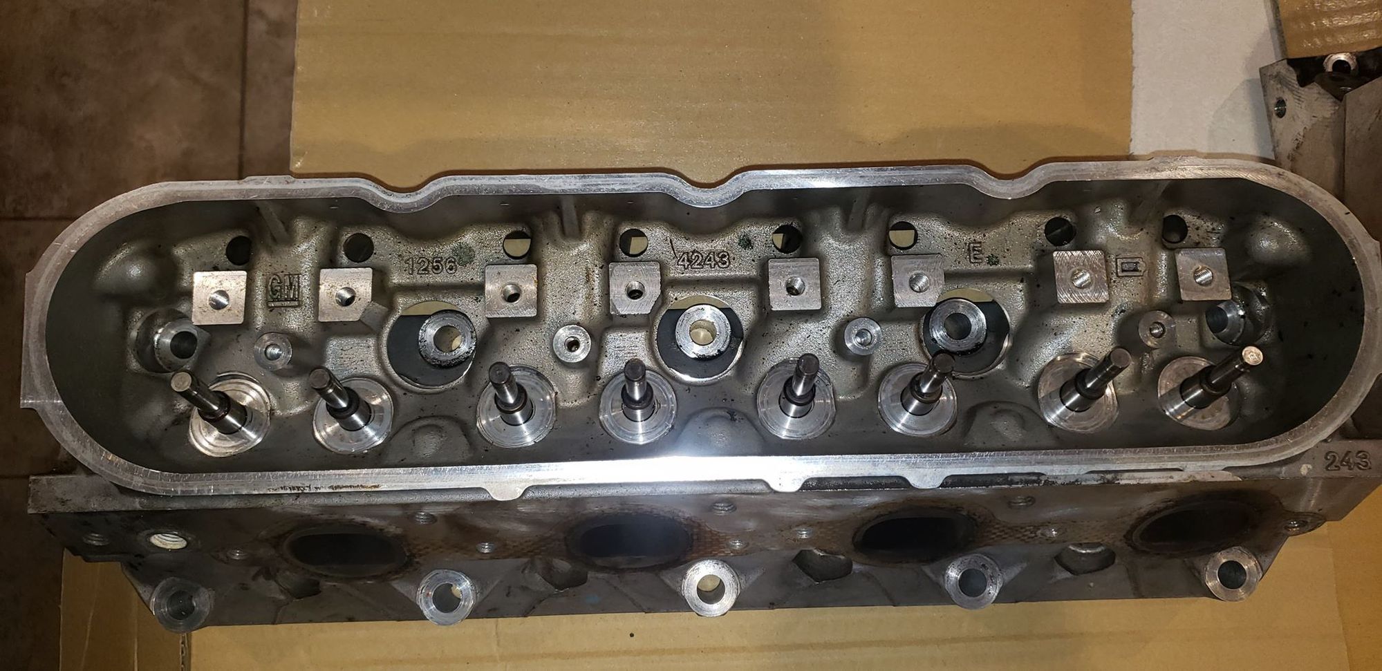

Stuff is already starting to come in.
The bare heads are ready to clean.
