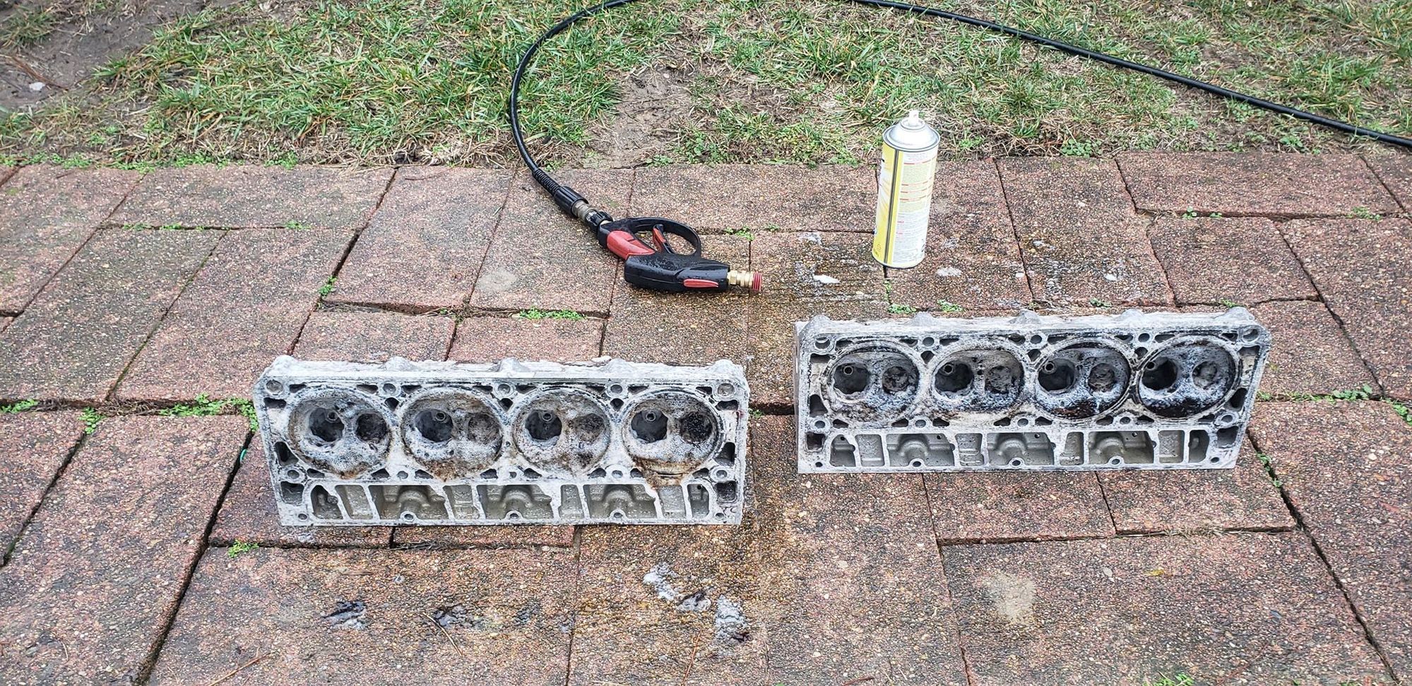

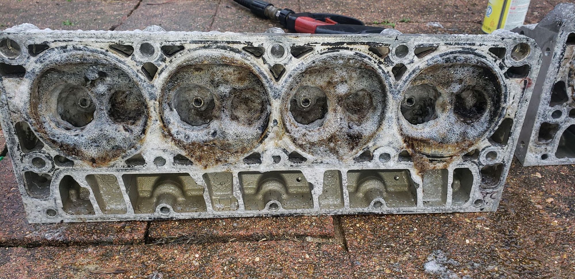

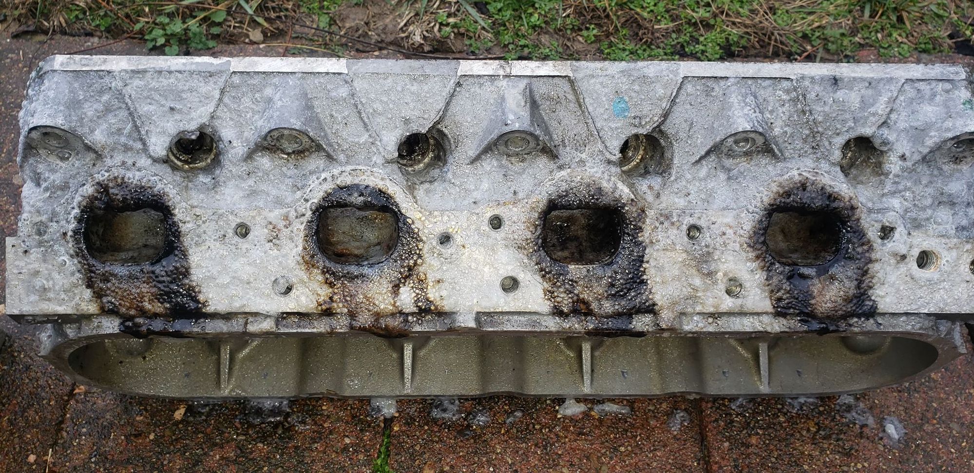

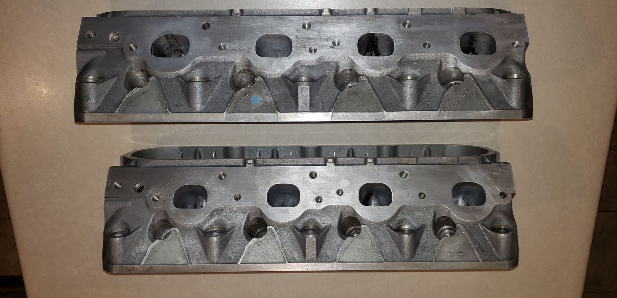

Getting cleaned up in order to go under the "knife". Porting begins this afternoon.
Old Jan 18, 2020 | 02:08 PM
  #63
Posts: 7,827
Likes: 5,172
Oooof. That stuff will eat aluminum. Contains Sodium Hydroxide. If you dipped the castings in a pool of it, they would be nothing but seats and guides left over time. Get that stuff off of there ASAP. Bad idea. Google it if you don’t believe me.
Old Jan 18, 2020 | 02:57 PM
  #64
blsnelling's Avatar
Joined: Sep 2006
Posts: 893
Likes: 41

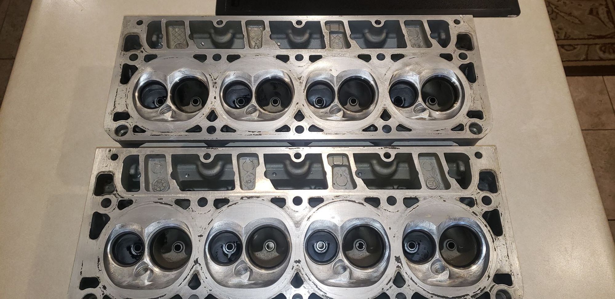

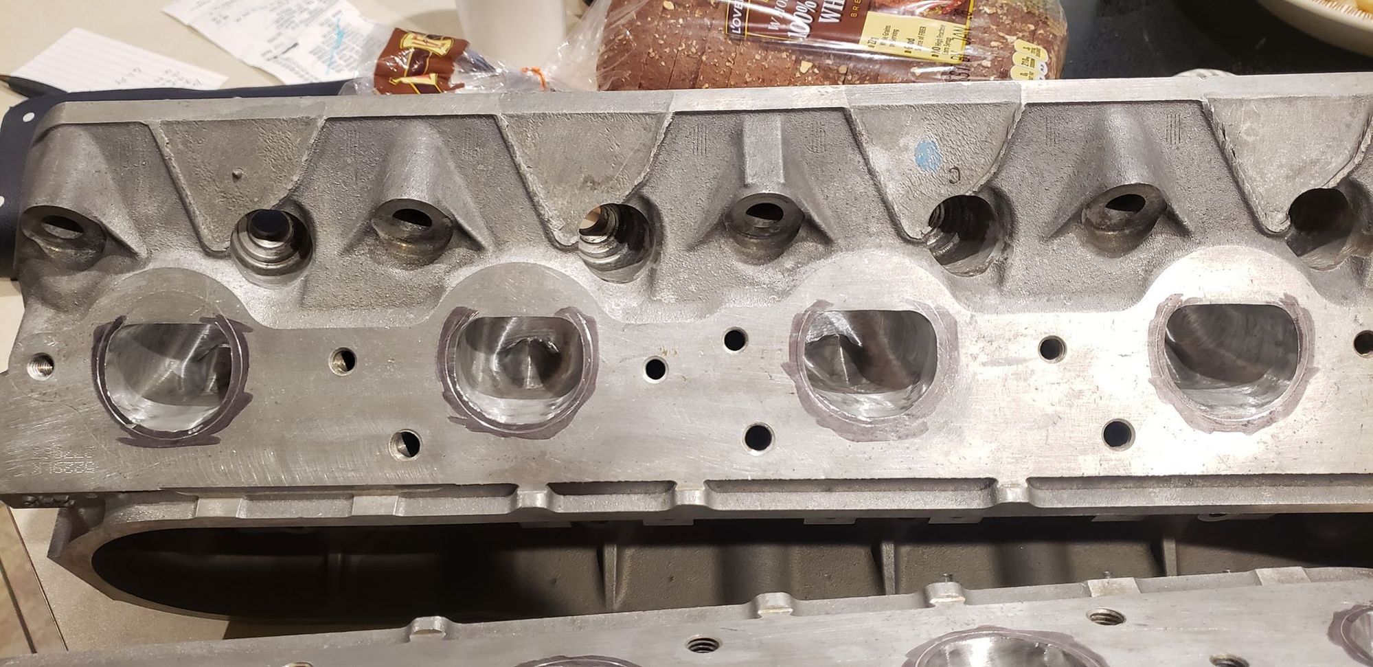

That was a concern. 30 minutes didn't discolor them at all. I sprayed them again and let them set a couple hours and they did start to discolor. I had to scrub them with a brillo pad. Here's the finished product. I didn't perfect the deck surface since they'll be getting milled.

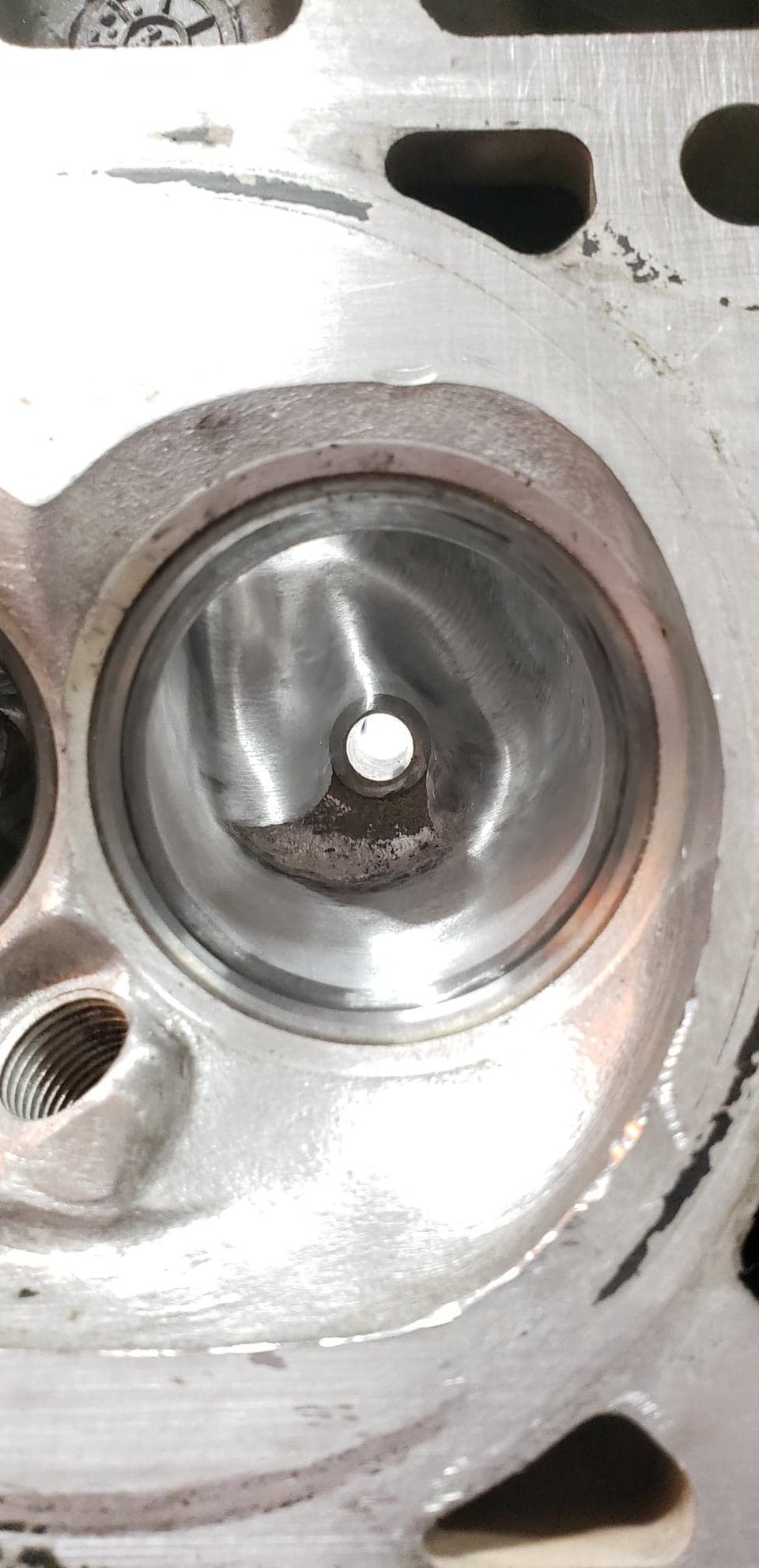

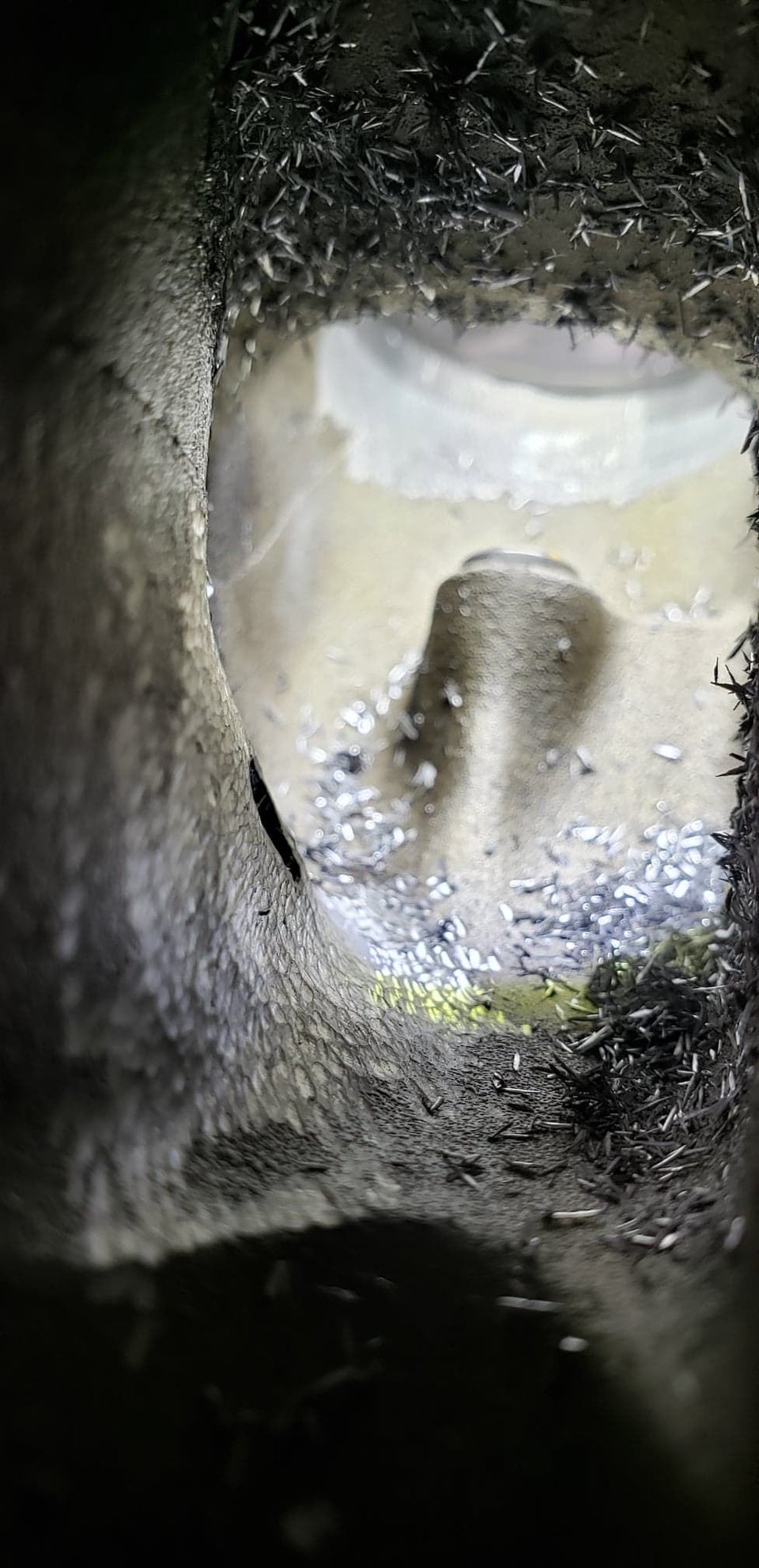

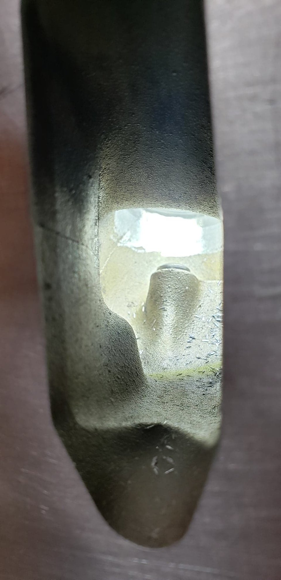

The exhaust ports are completely shaped and finished to 120 grit. How fine should I take them? The intake seats have been sized. I'll tackle them Monday. Lighting is so harsh in pictures. They are super smooth to the touch.
Old Jan 18, 2020 | 11:09 PM
  #66
Posts: 22,290
Likes: 3,615
Those intake bowls need BLENDING!
And lots of it That's on the agenda for tomorrow.

You should finish the runners with 30 grit. NOT KIDDING.

And the heads. Look up stuff about boundary layers and airflow and you should get the idea. Same principle as the dimples on a golf ball making it go further.
Look at most CNC heads. They leave the tool marks
THIS is why you port, but do not polish. Any time I read here that someone is going to "port and polish" their heads, I cringe a bit. Old school....

I thought that only applied to intake runners, and that exhaust runners should be polished.

I have not seen polished exhaust runners in a while. The intakes were more critical back in the carb days to keep the gas in suspension and not wet the walls. But it has been found that dry flow benefits also due to the boundary layer effect as Darth mentioned above.

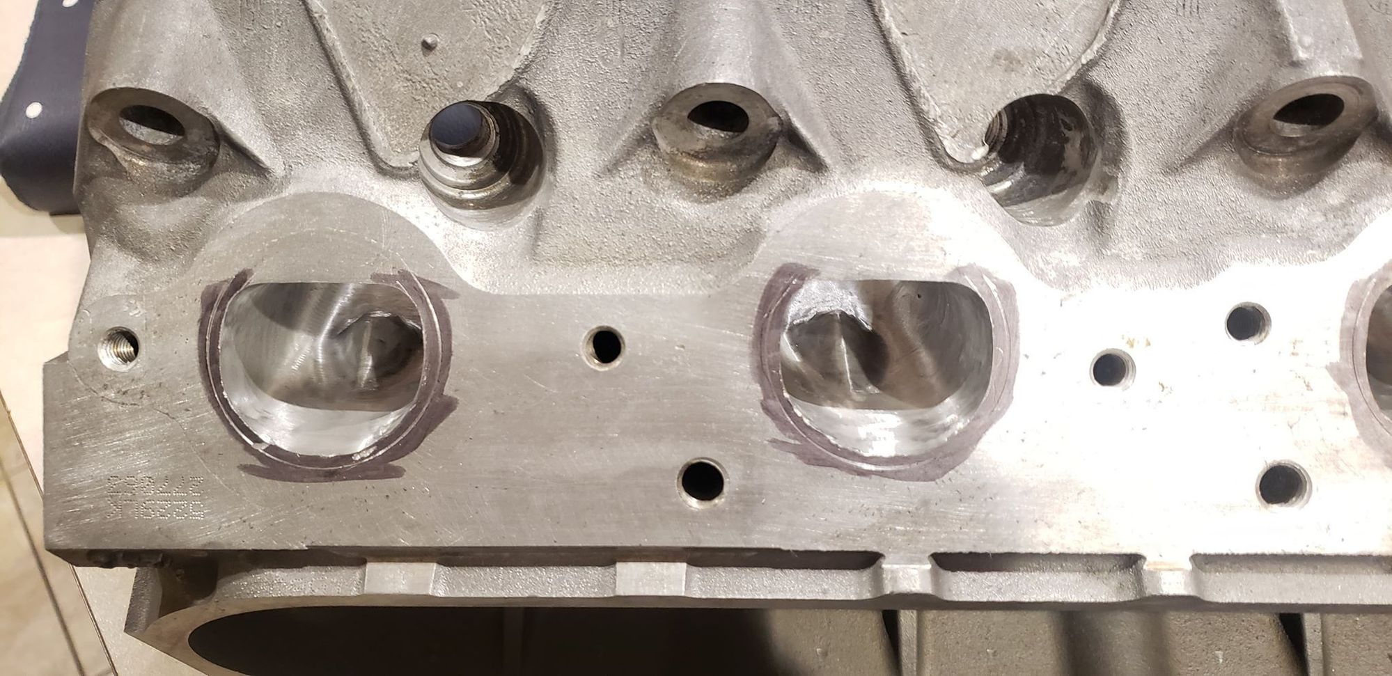

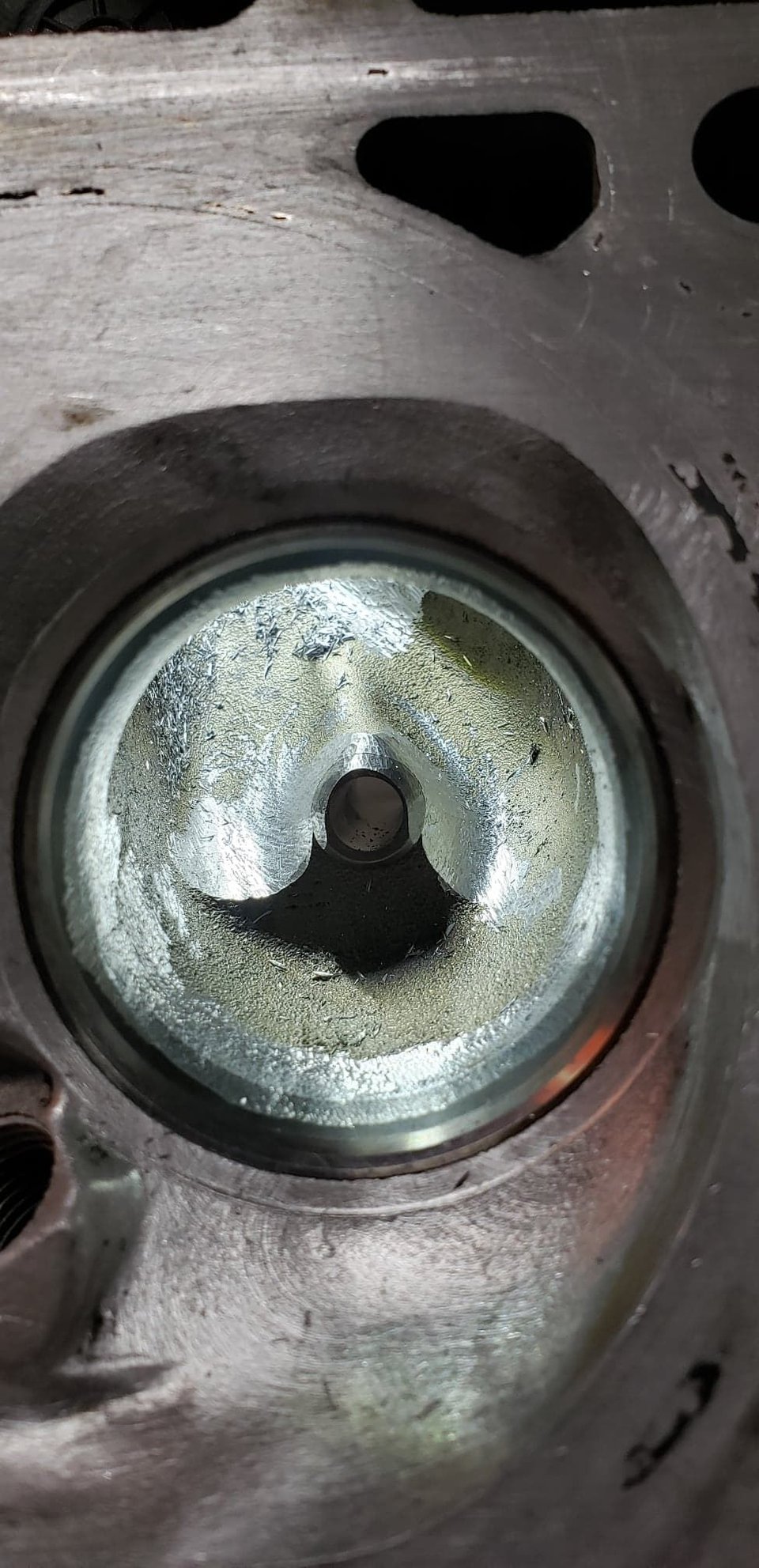

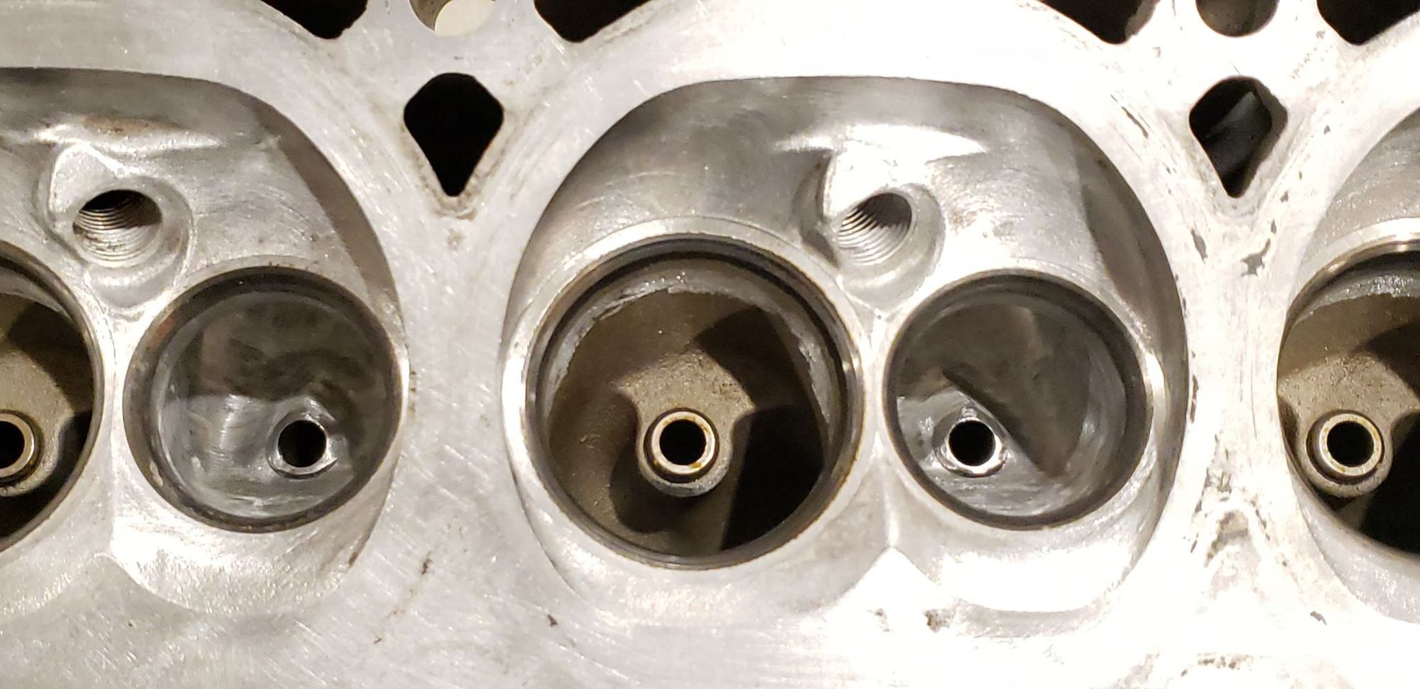

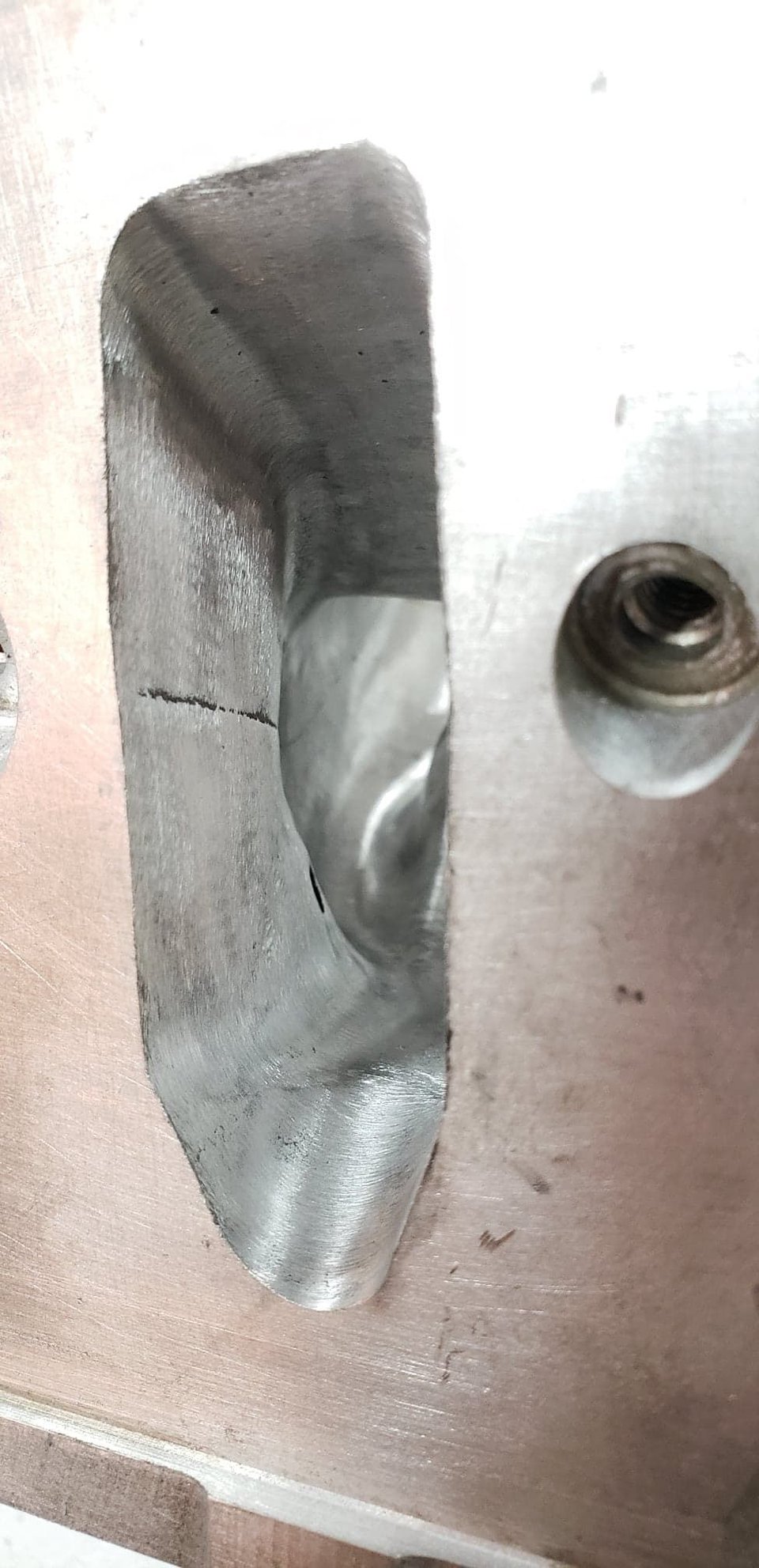

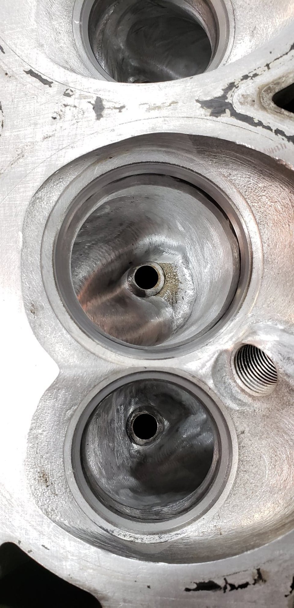

The intake ports are all roughed in and one of them sanded out to 80 grit.
Before
Only partially roughed in
Finished
Before
Roughed in
Finished
Finished

Only the Z06 LS6 243's got the light valves. Another way besides weighing them is measuring the length. They are .027 longer if I recall correctly, and the LS6 cam had a smaller base circle. Super weird deal.
Nice work on the heads man, those look great. What did you use to cut the seats out perfectly center and round? Or did you just whittle around and around with a burr?

Double edit, gotta compliment you again on the home grown head work. Those look great.

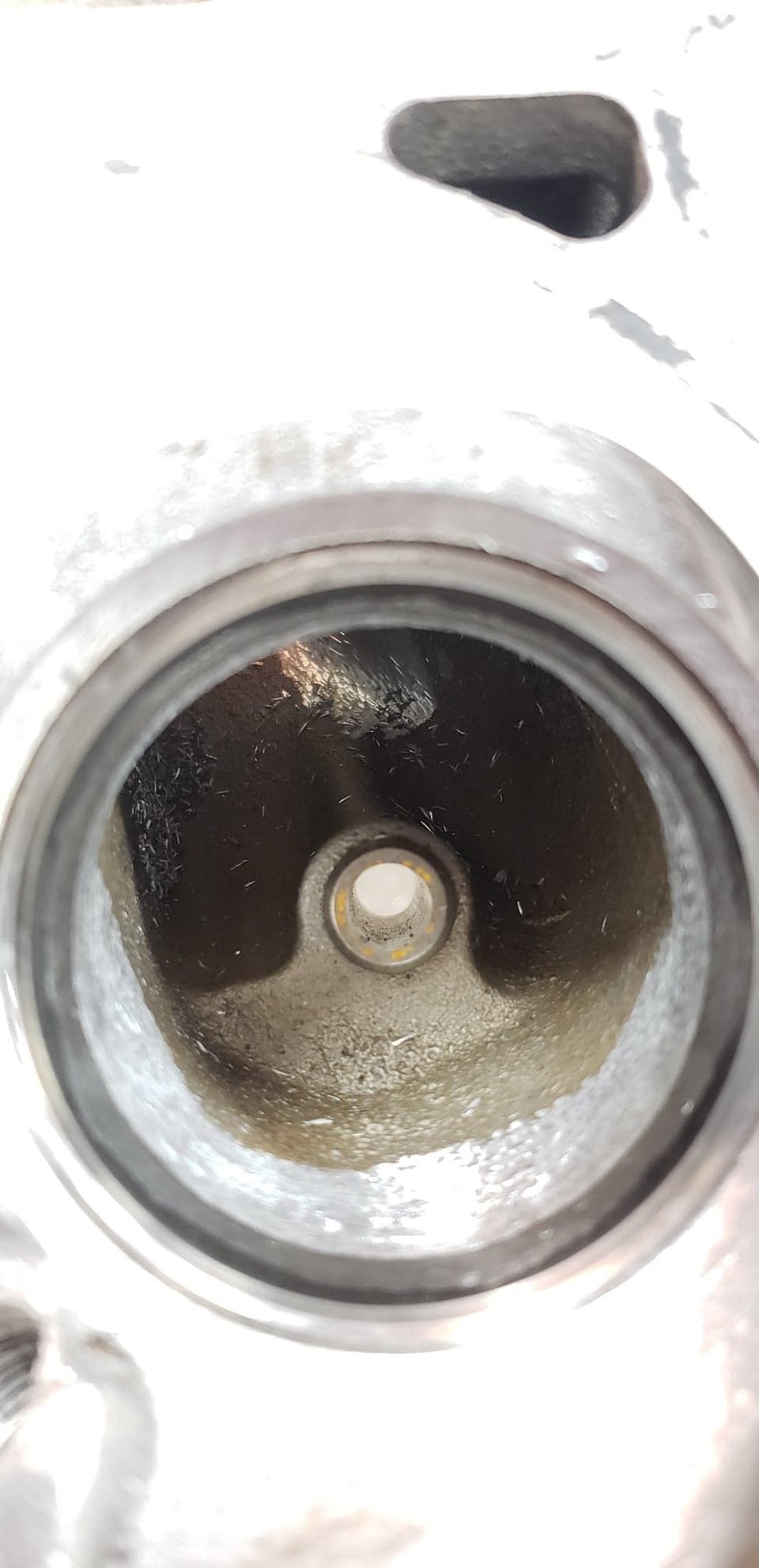

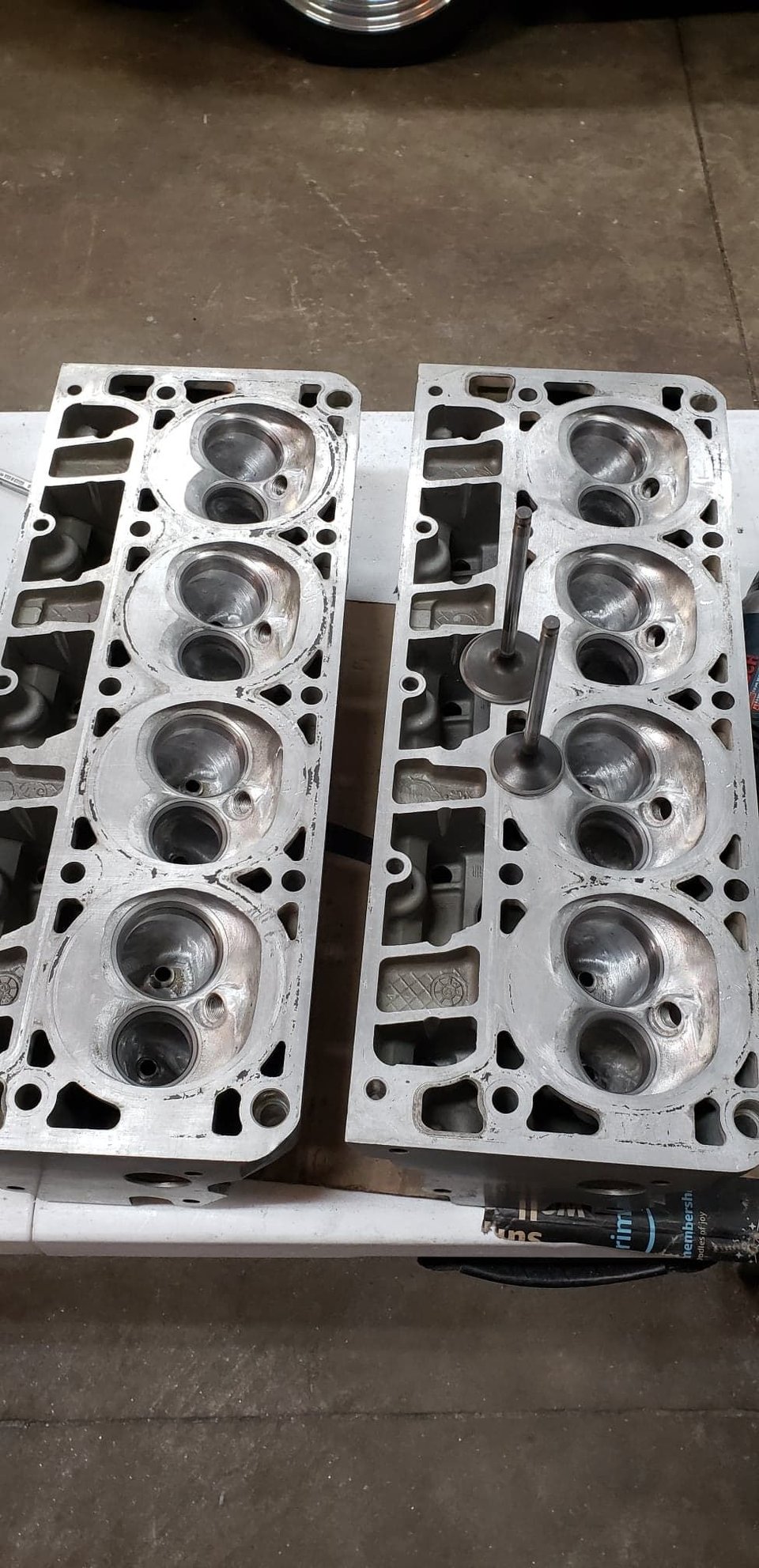

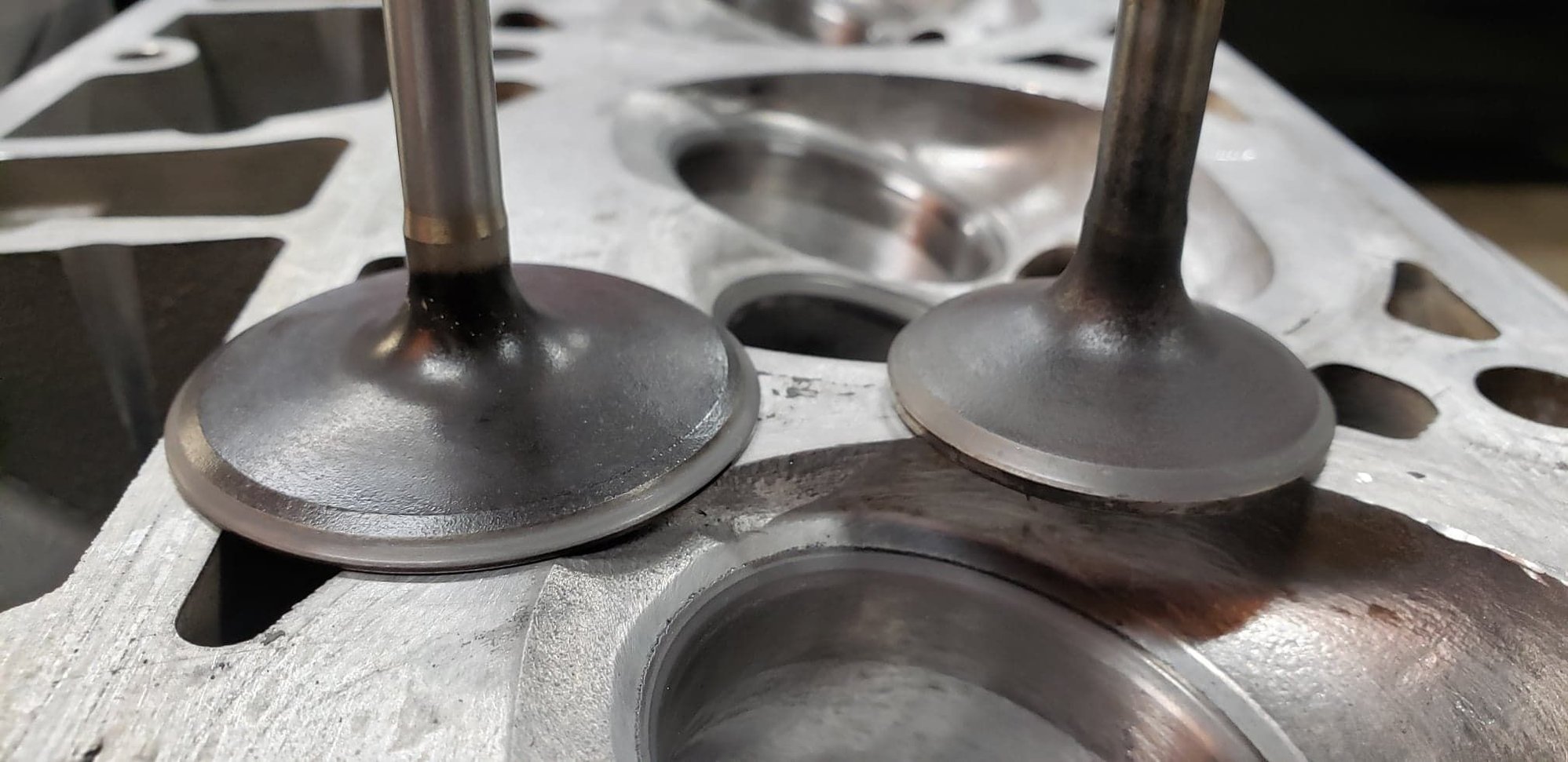

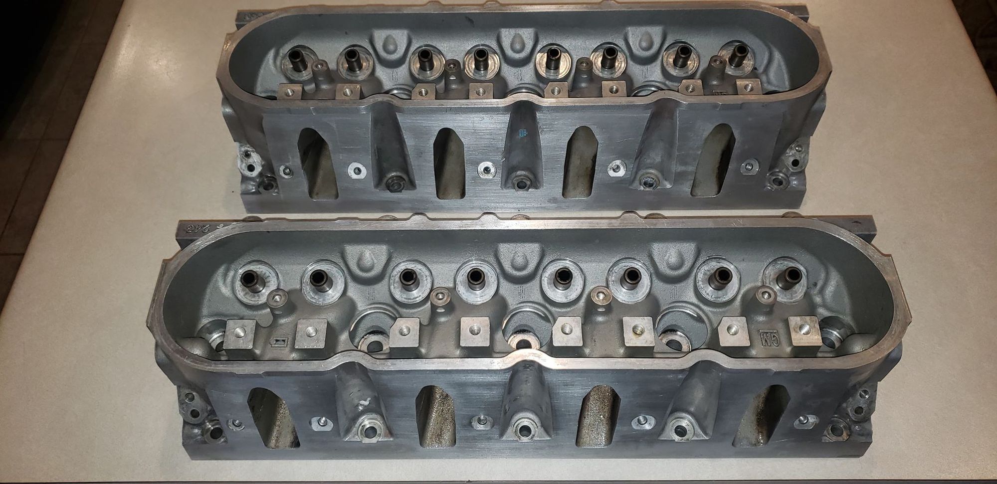

The heads are done and the mess cleaned up. The exhaust valves had some pitting, but they lapped in nicely. Now to get them to a machine shop and have them decked .007"-.010".
