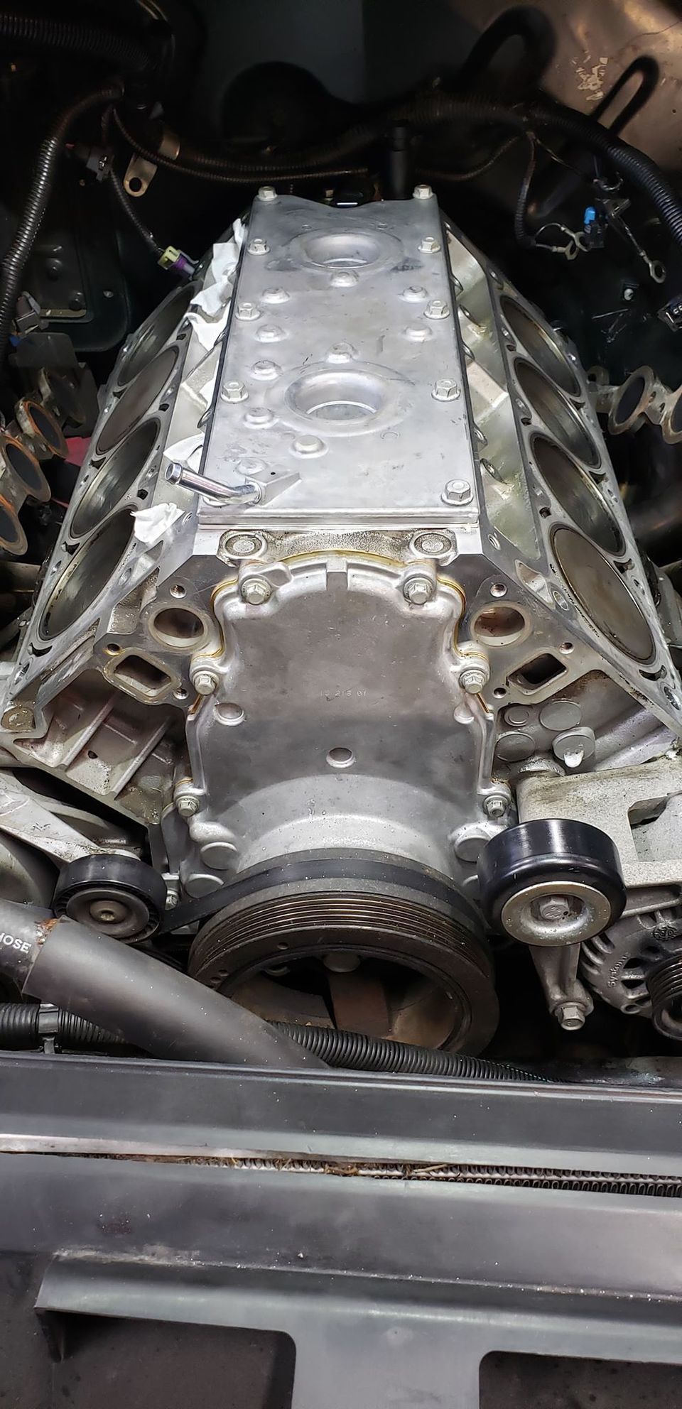

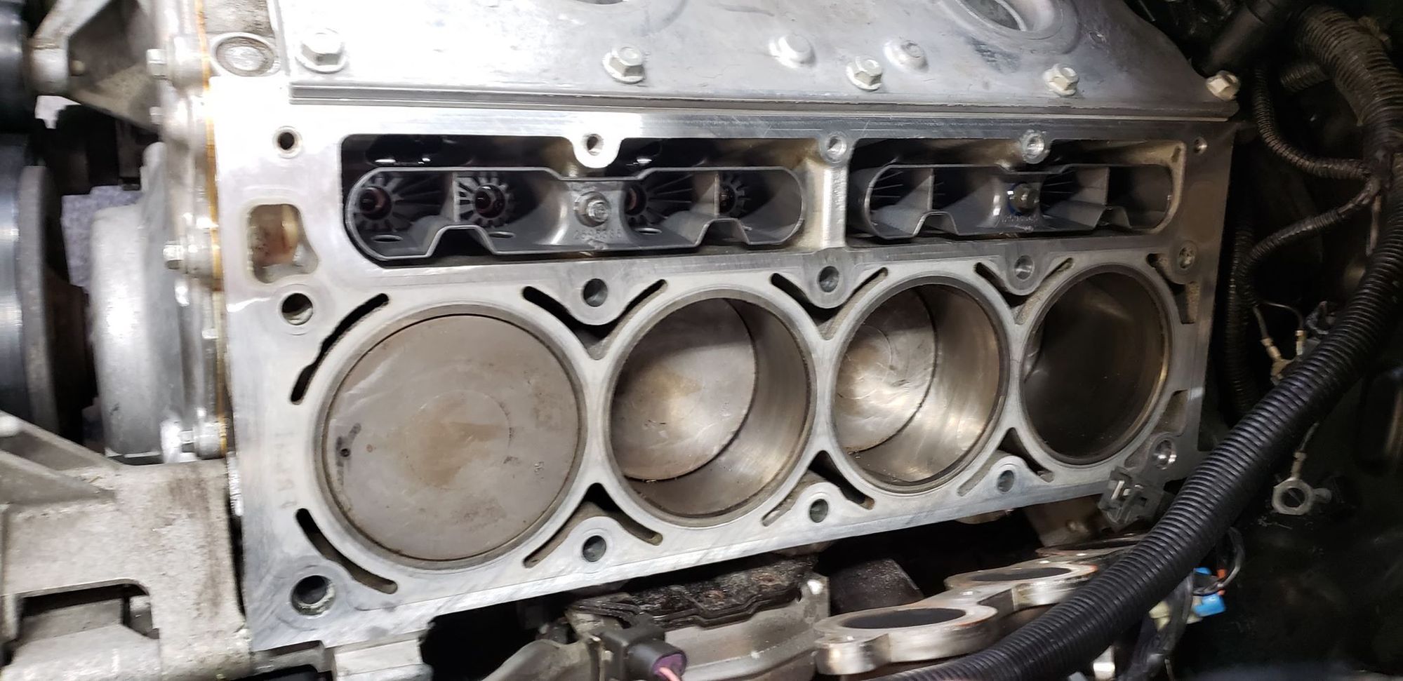

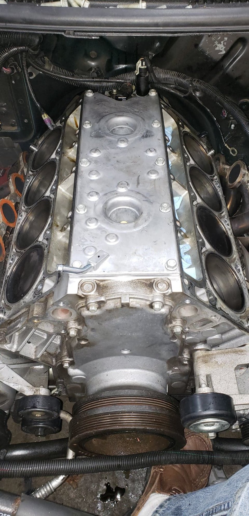

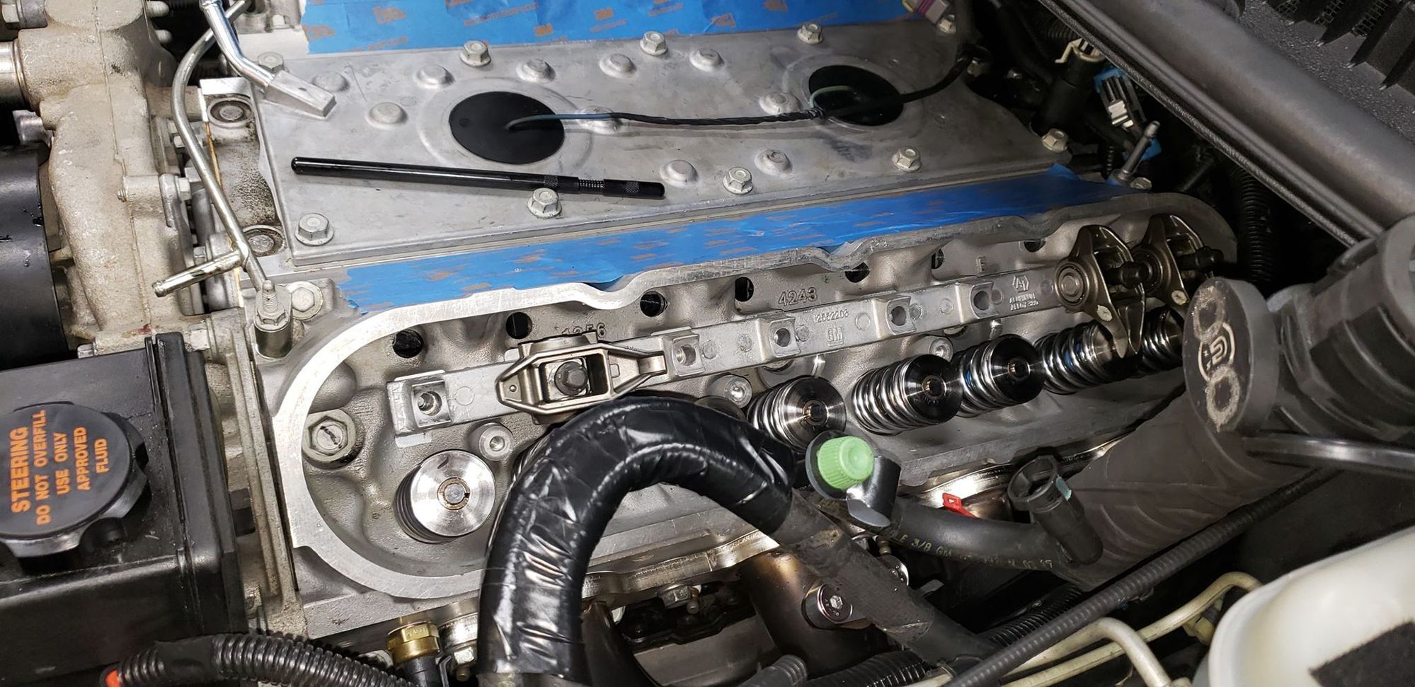

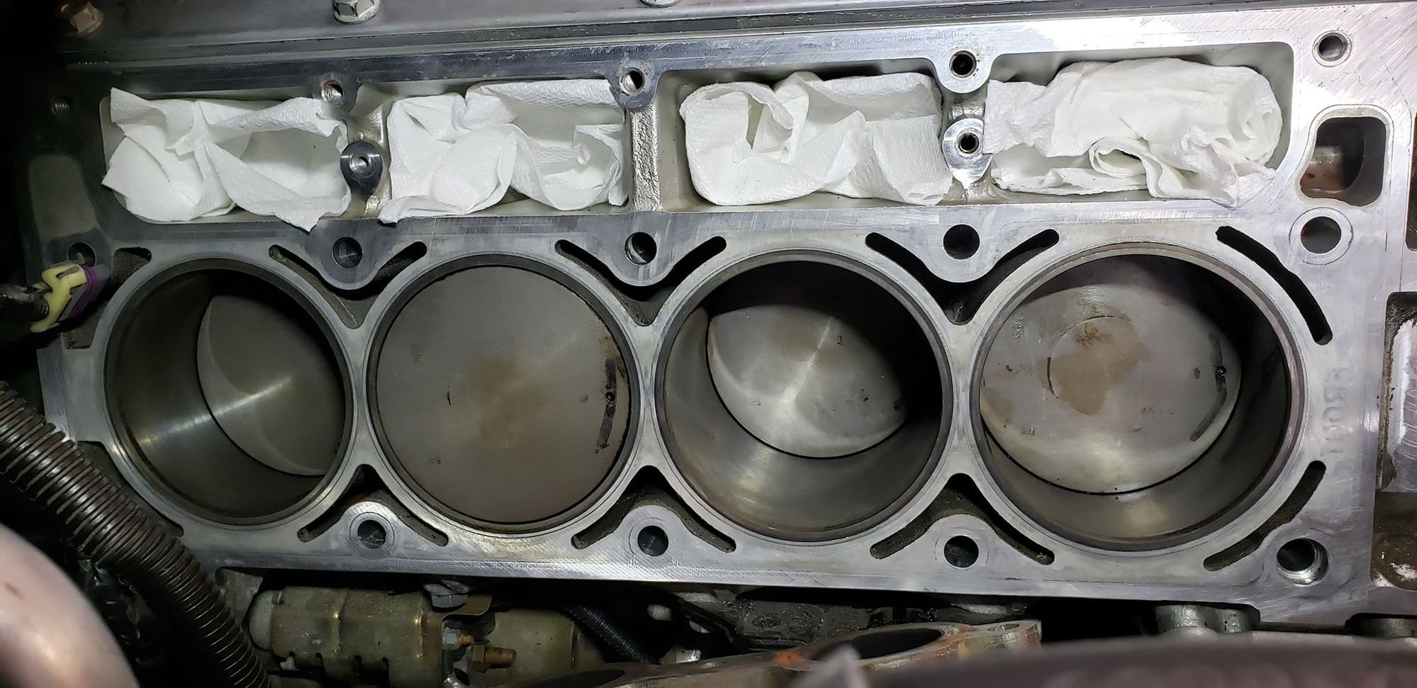

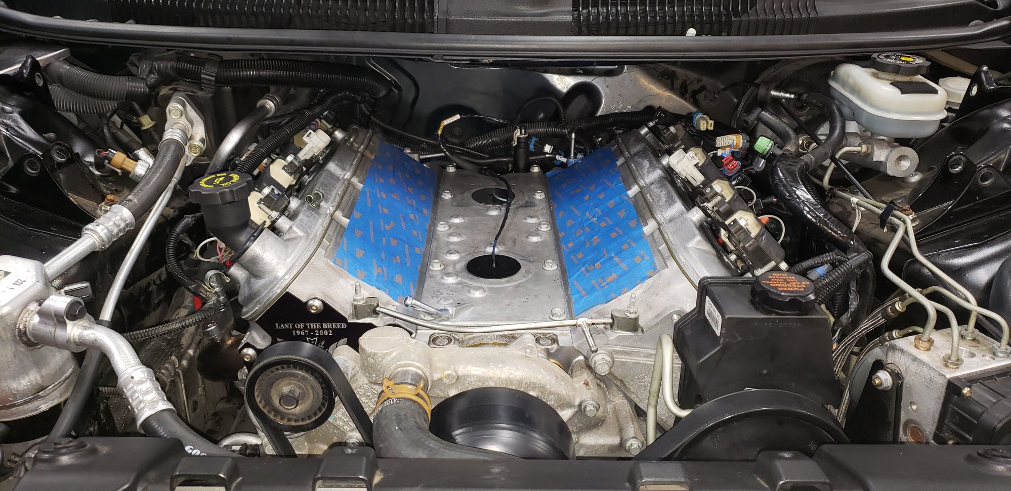

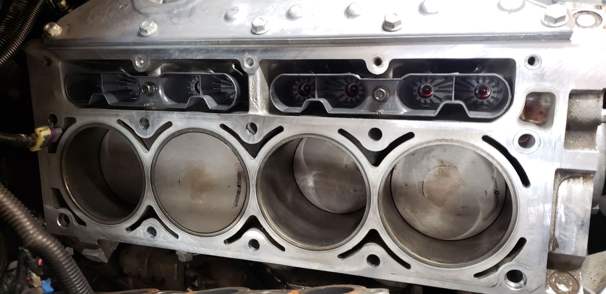

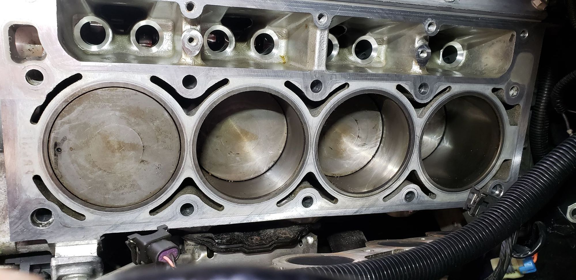

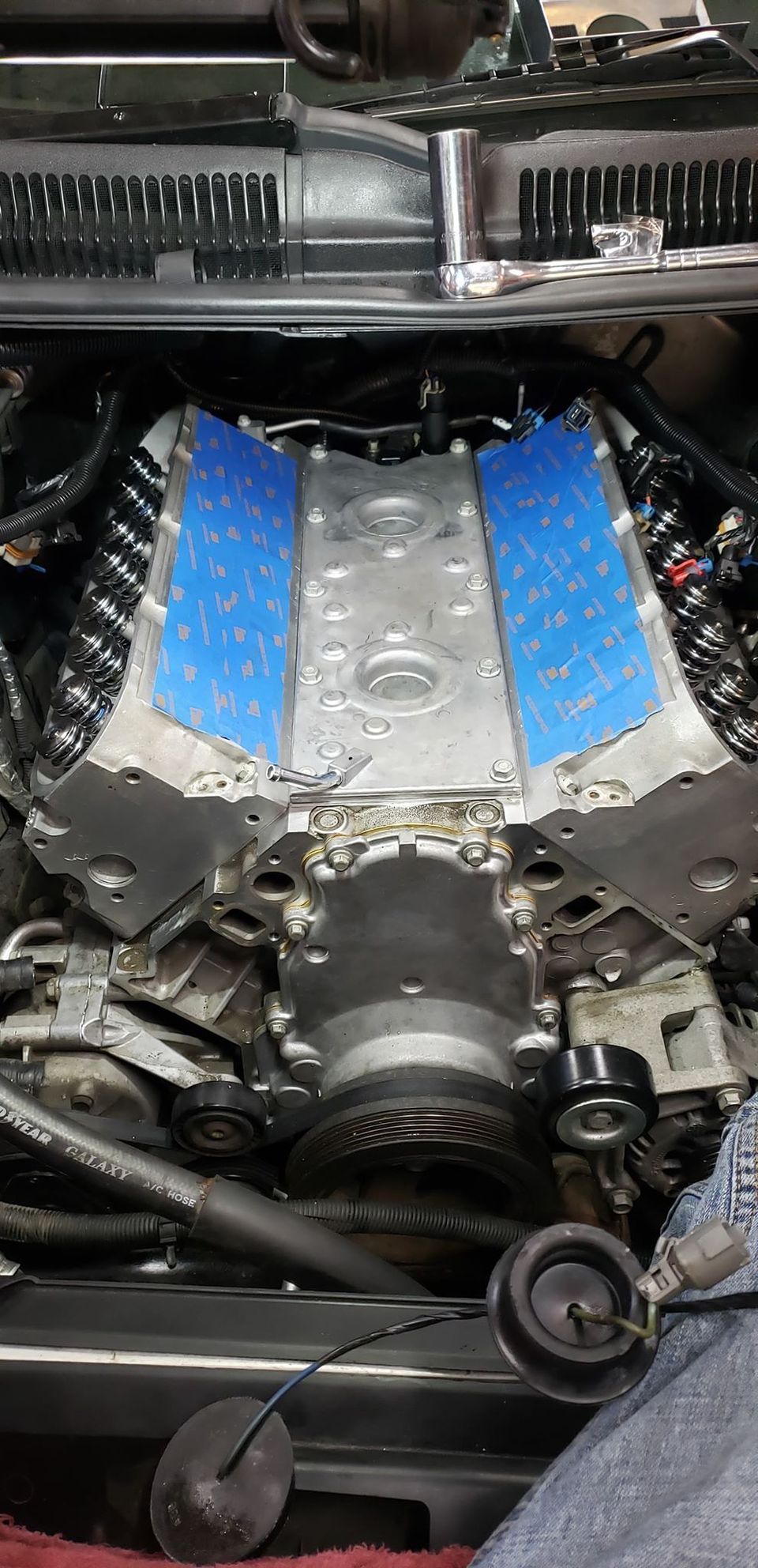

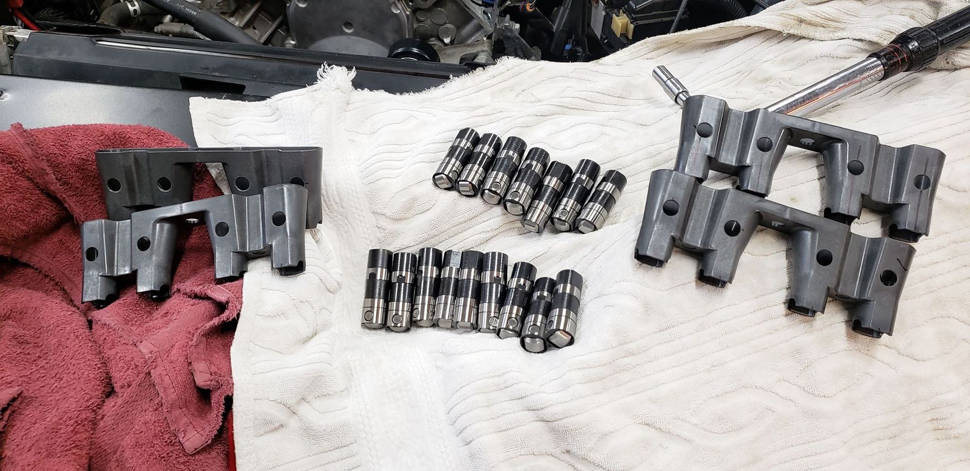

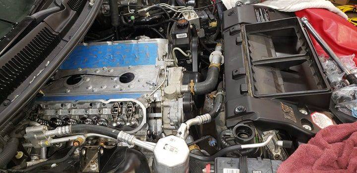

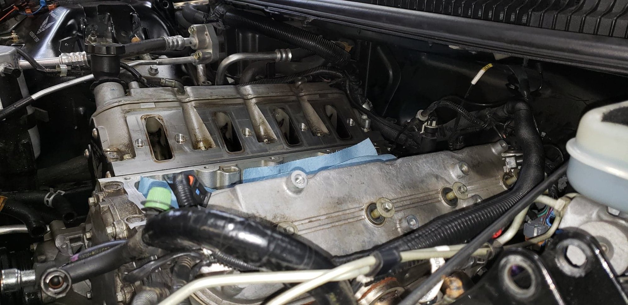

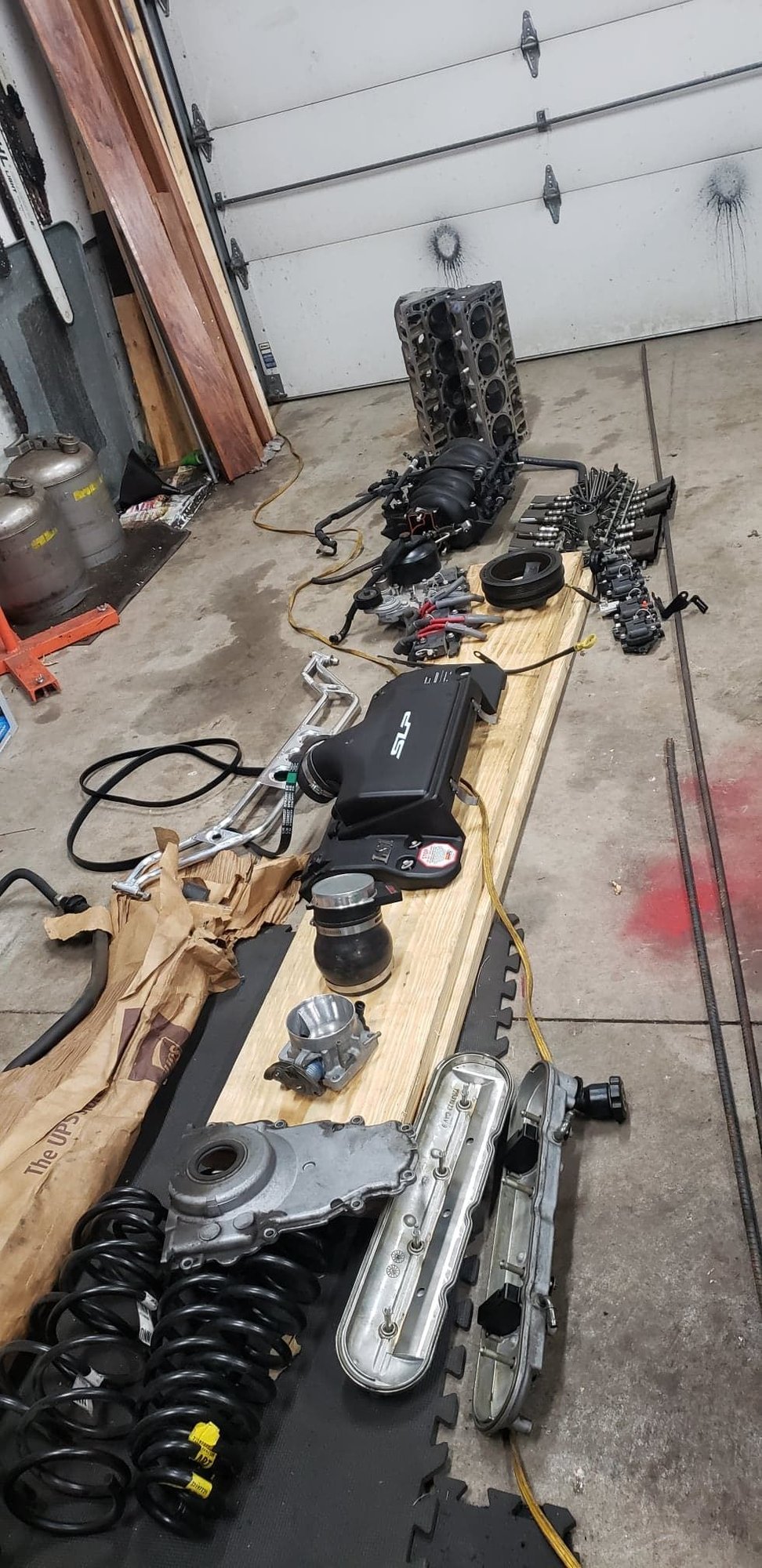

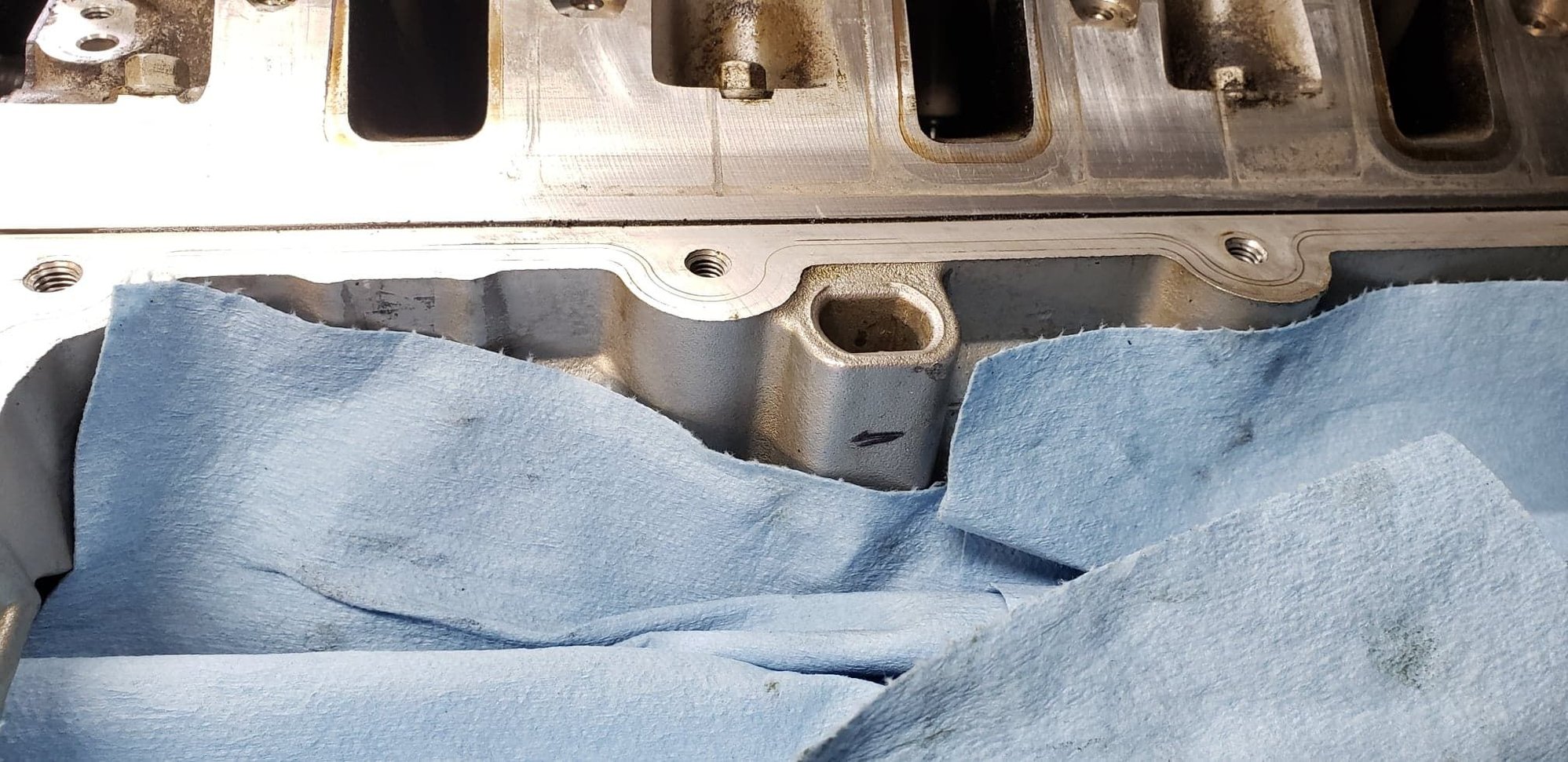

The heads are off and the new cam installed. Everything thing is ready for the new heads except for cleaning the block deck surface.
I forgot to take pics after removing this boss in preparation for the LS6 valley plate.
The new cam is in.

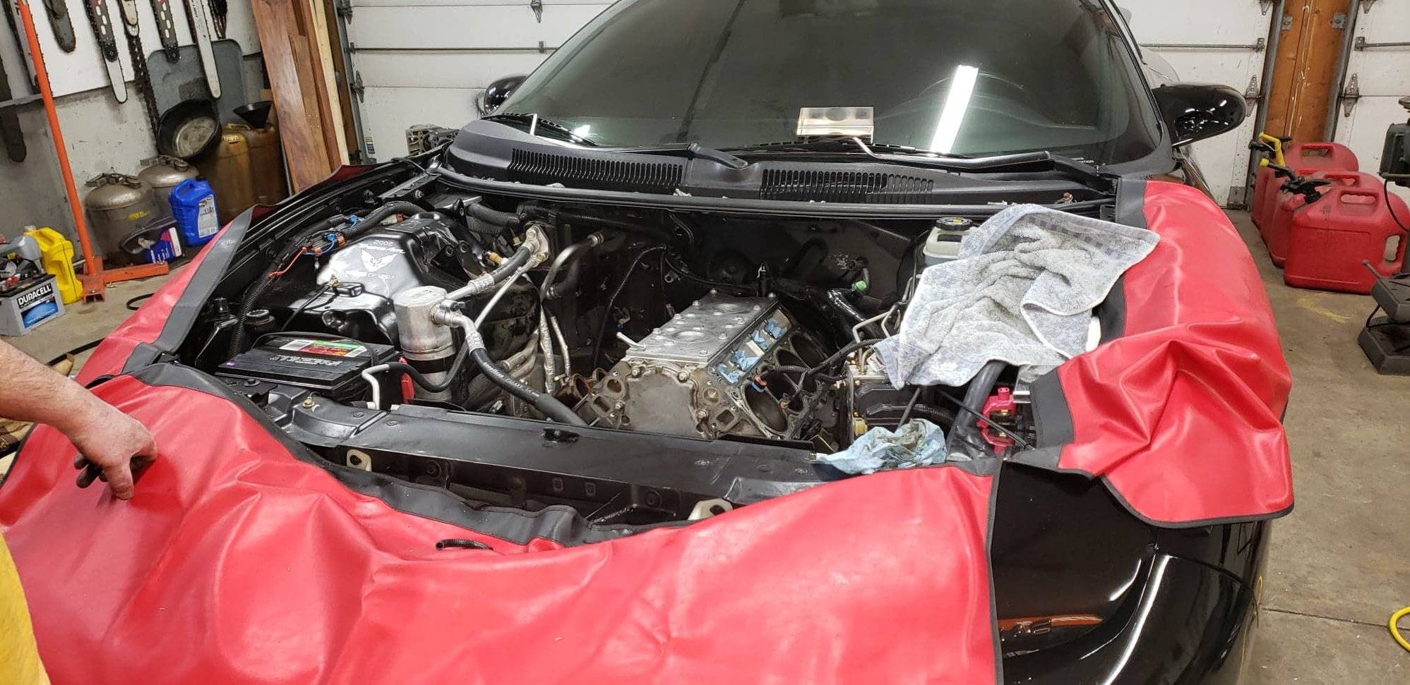

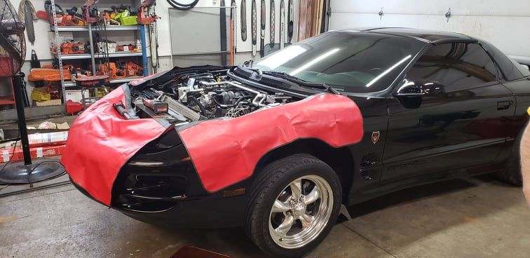

Covered up and put to bed for a couple days.
Yes, I cleaned up my mess when I was done

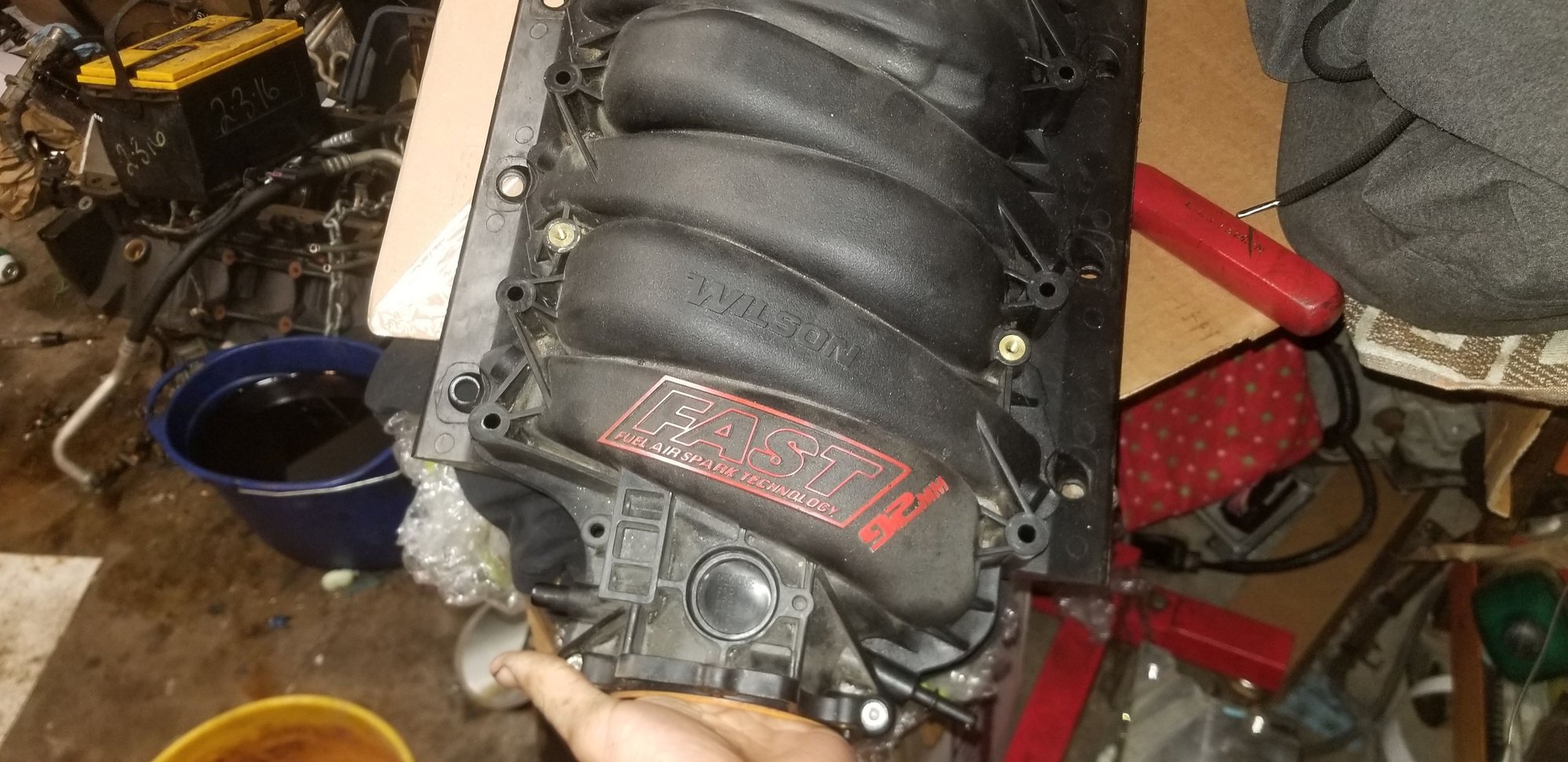

I'm still looking for a FAST 92mm intake. If anyone has one, please message me.

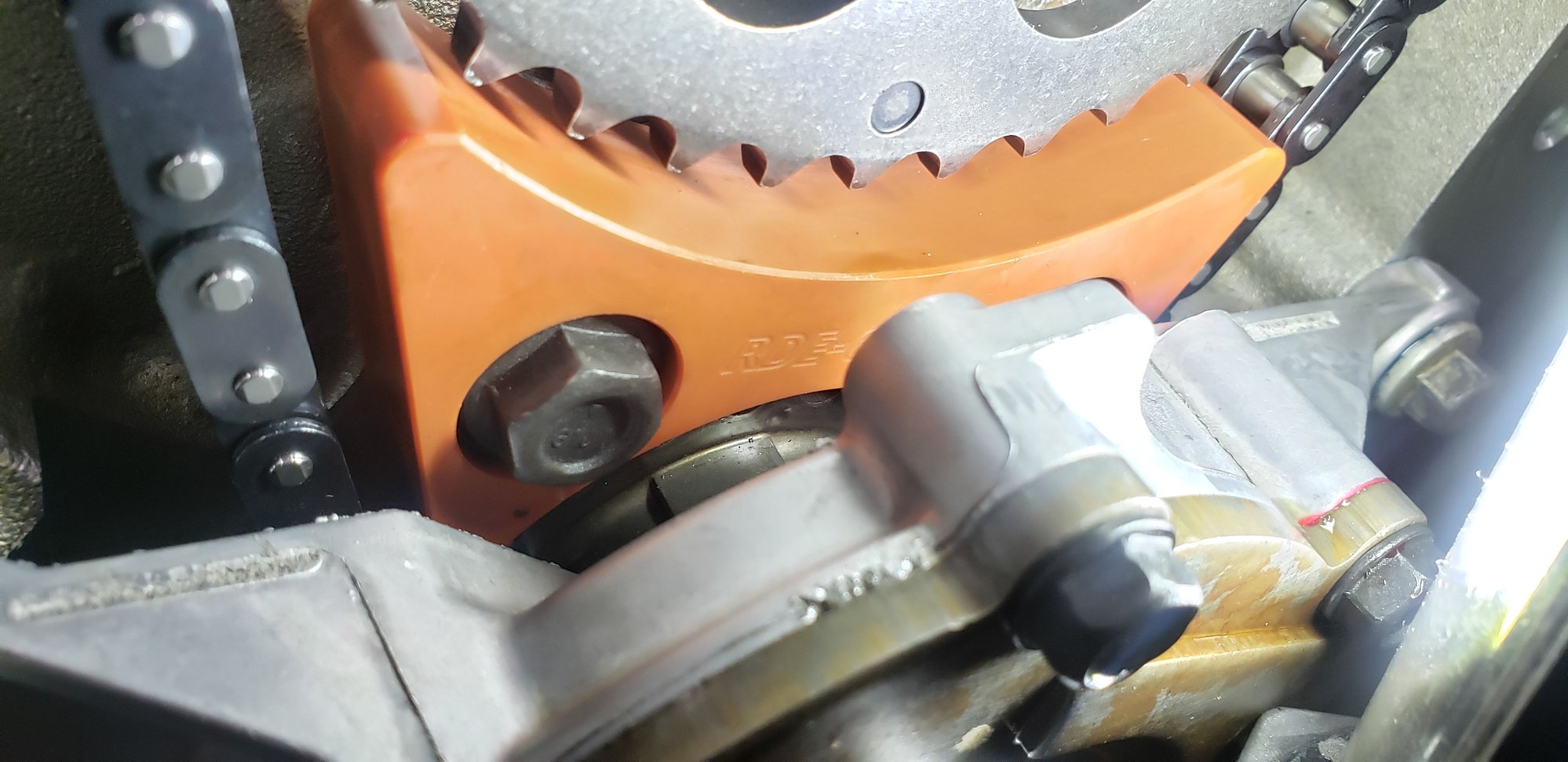

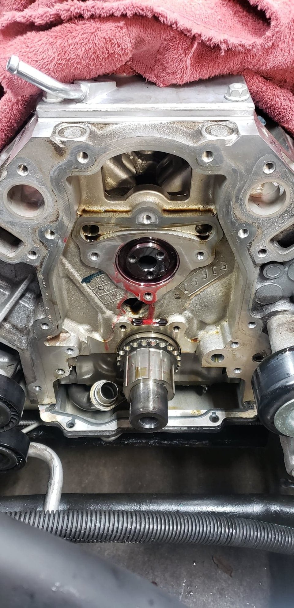

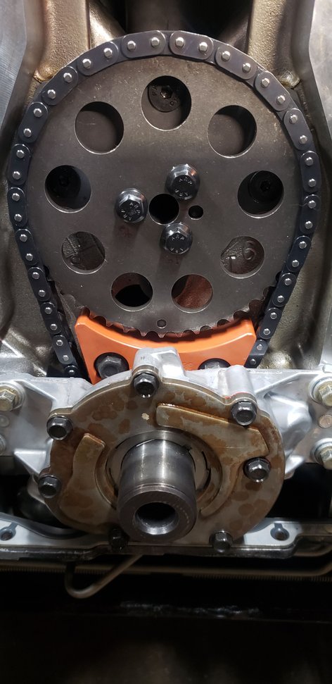

The oil pump is ported, the bypass valve shimmed .105", the oil pump housing centered and torqued down, the pick-up tube tightened, the o-ring replace, and the oil pan torqued back down. The cam gear is only temporarily installed to hold the chain up. I have new ARP bolts to put it in with. Another 1/2 hour work and the front cover will be back on and anything covered up.

The front is all buttoned up.

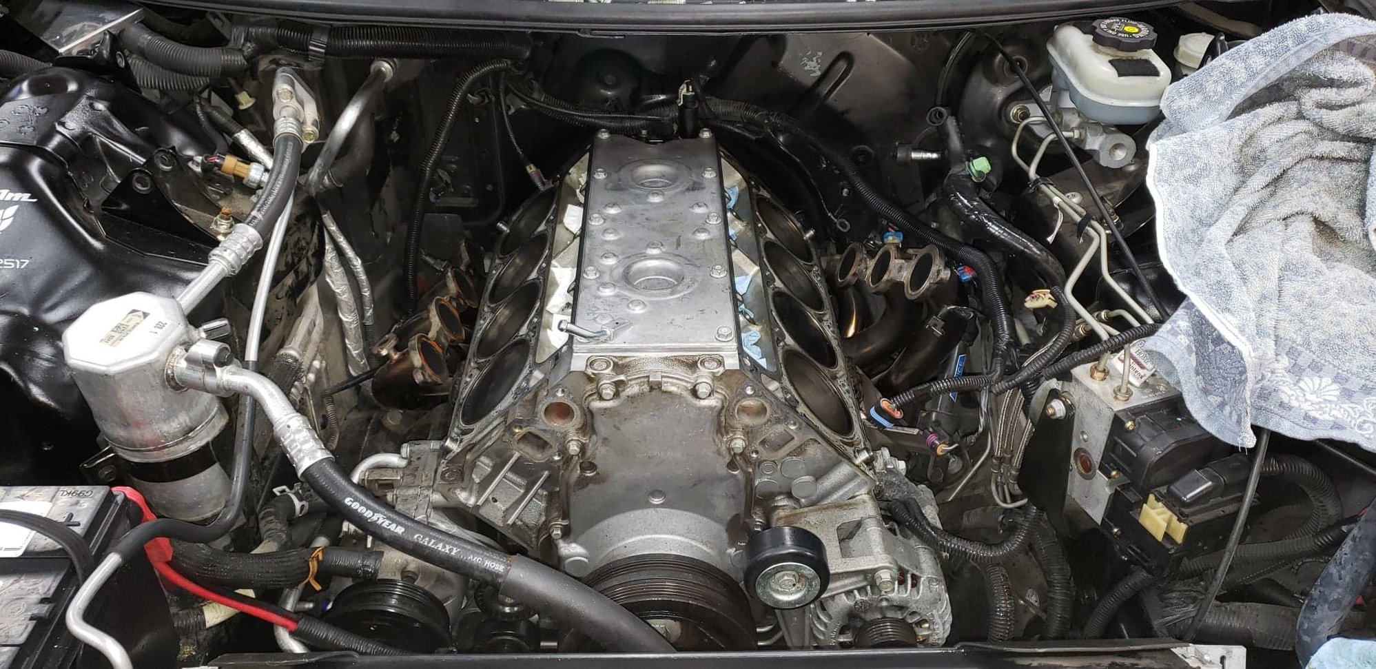

Lots of progress made today.

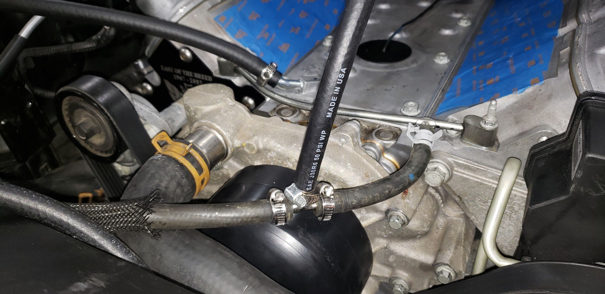

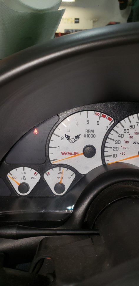

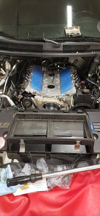

It'll be ready to run as soon as I get the intake on. If I wasn't going out for the evening I'd probably bolt the stock intake on it and fire it up. I pulled the fuel pump fuse and turned it over until it made oil pressure. I was shocked to see 50 PSI. I've plumbed both catch cans and the new PCV line.
Rear steam vent teed in. New PCV and catch cans plumbed.
