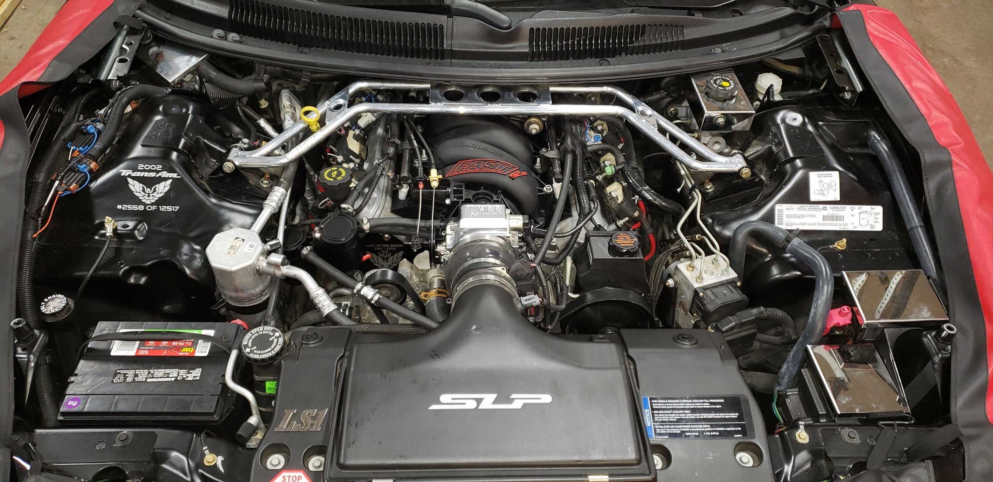

I couldn't help myself. I had to hear it run! The peace of mind was too close not to make it happen. We got home from eating out about 9:40. I had it running by 10:30 with the original intake and injectors. The videos don't even begin to do it justice. It's ear splitting loud, running open headers, and lopes like a monster!!! It desperately needs a tune! I was amazed that it didn't even have a hint of lifter tick on first start.

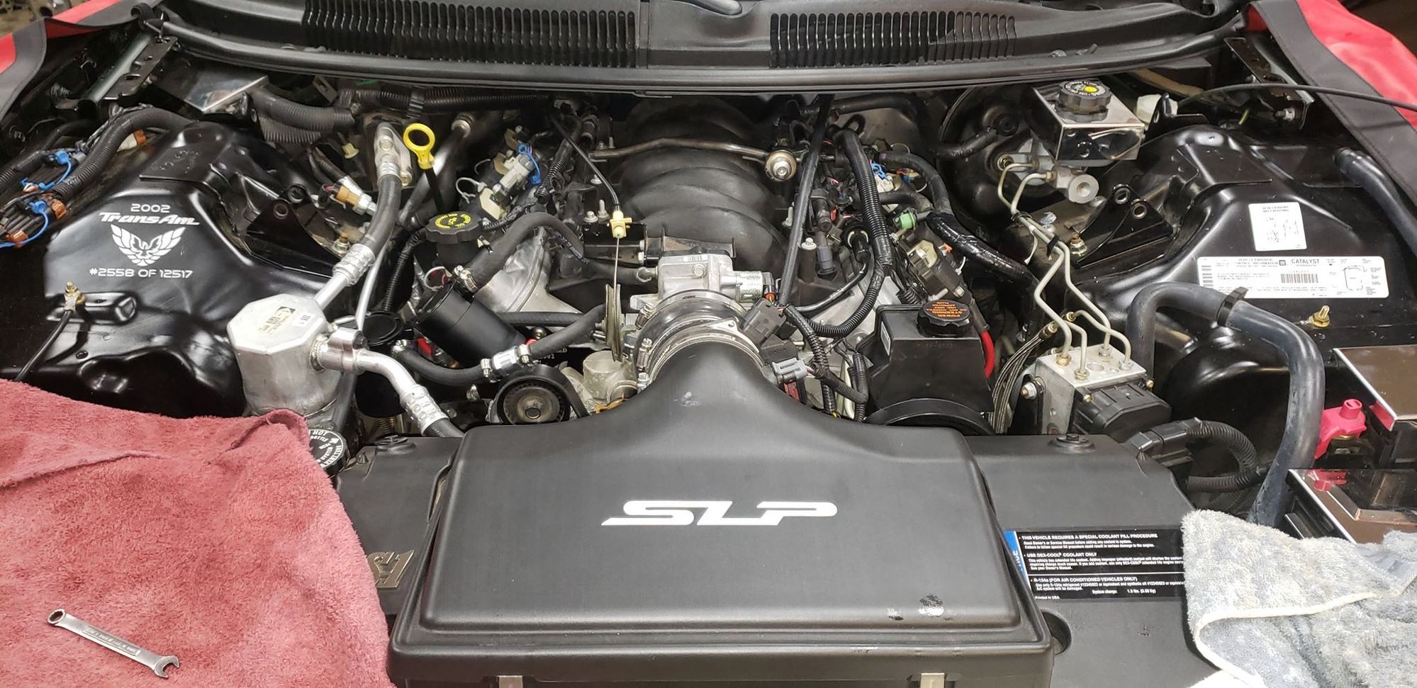

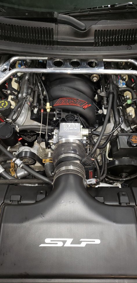

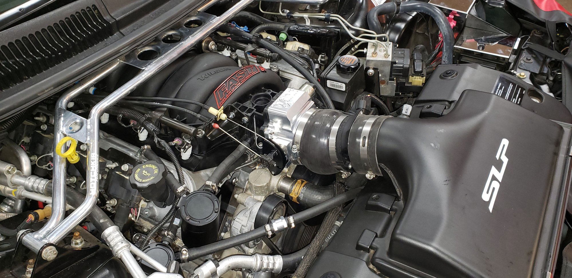

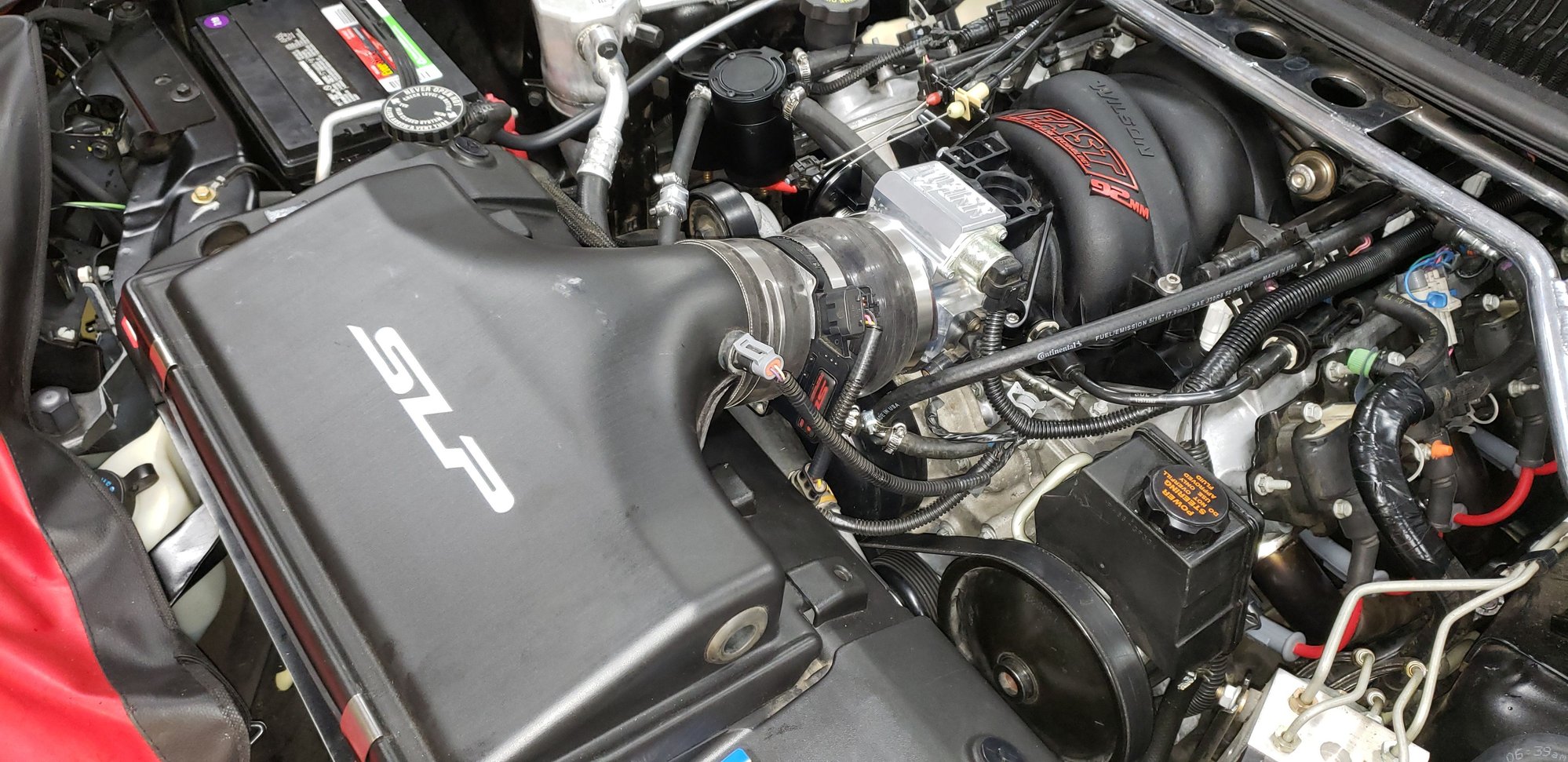

The FAST intake, 42# GTP injectors, and 92mm throttle body are installed. Now to drop the tank and install the Racetronix fuel pump and get the exhaust put back on.

Is it me or does the send line from the water pump look like its barley on the fitting?? Great build interested to see what you final numbers are and maybe a track time. Great job with the build.
