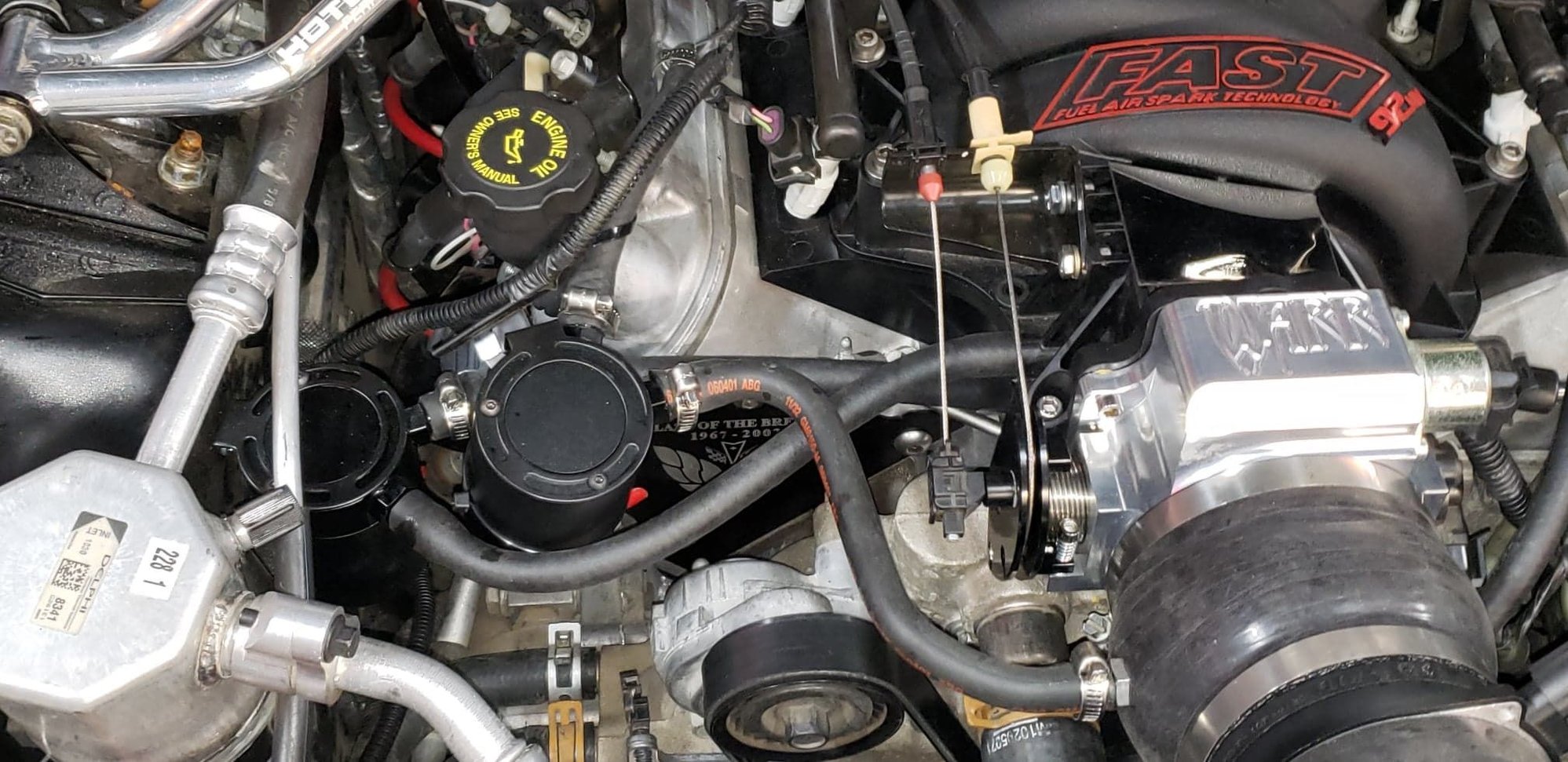

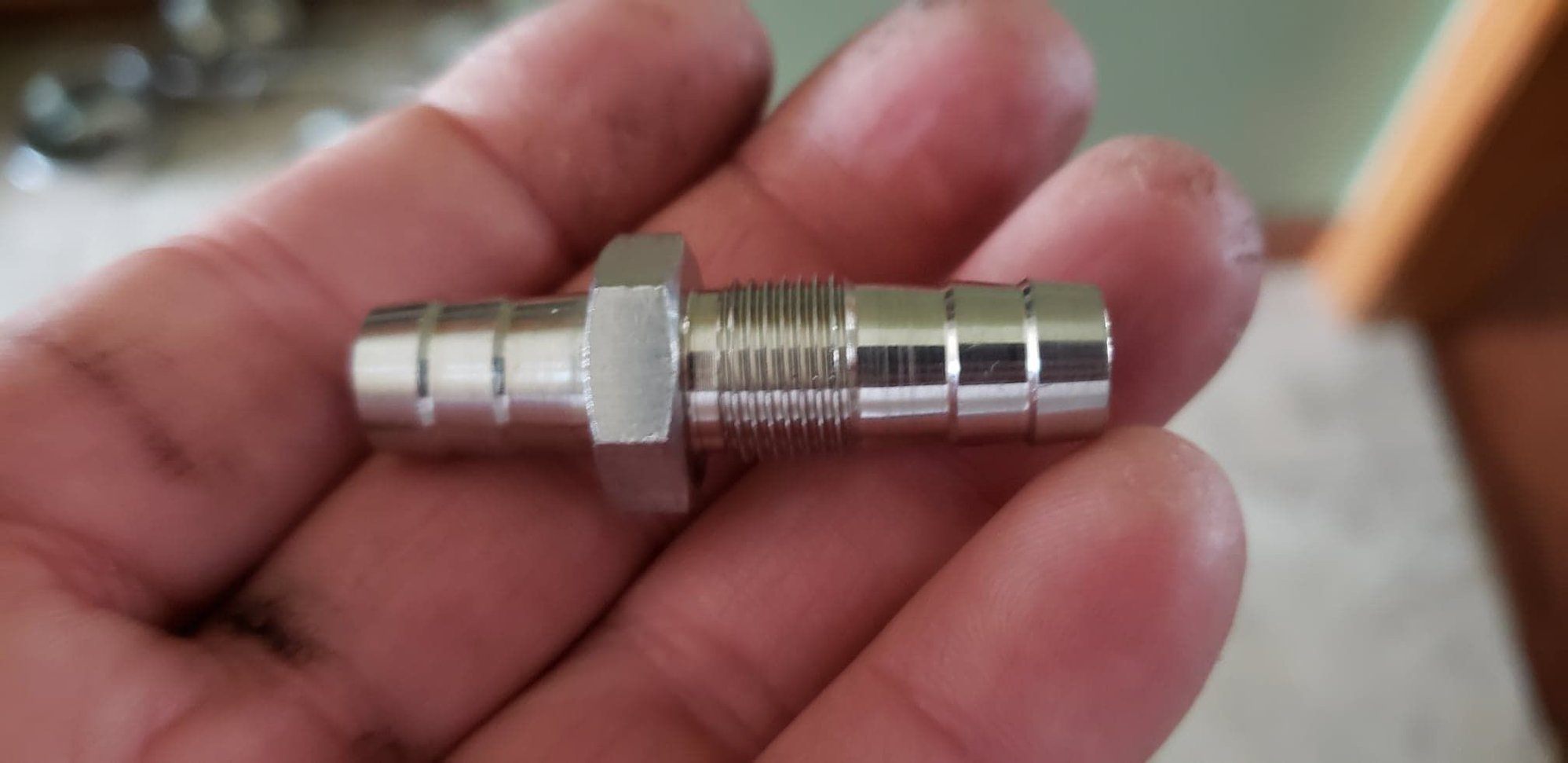

Here's the final PCV configuration. Am I correct that I do NOT need an inline PCV when using the latest LS6 valley cover?

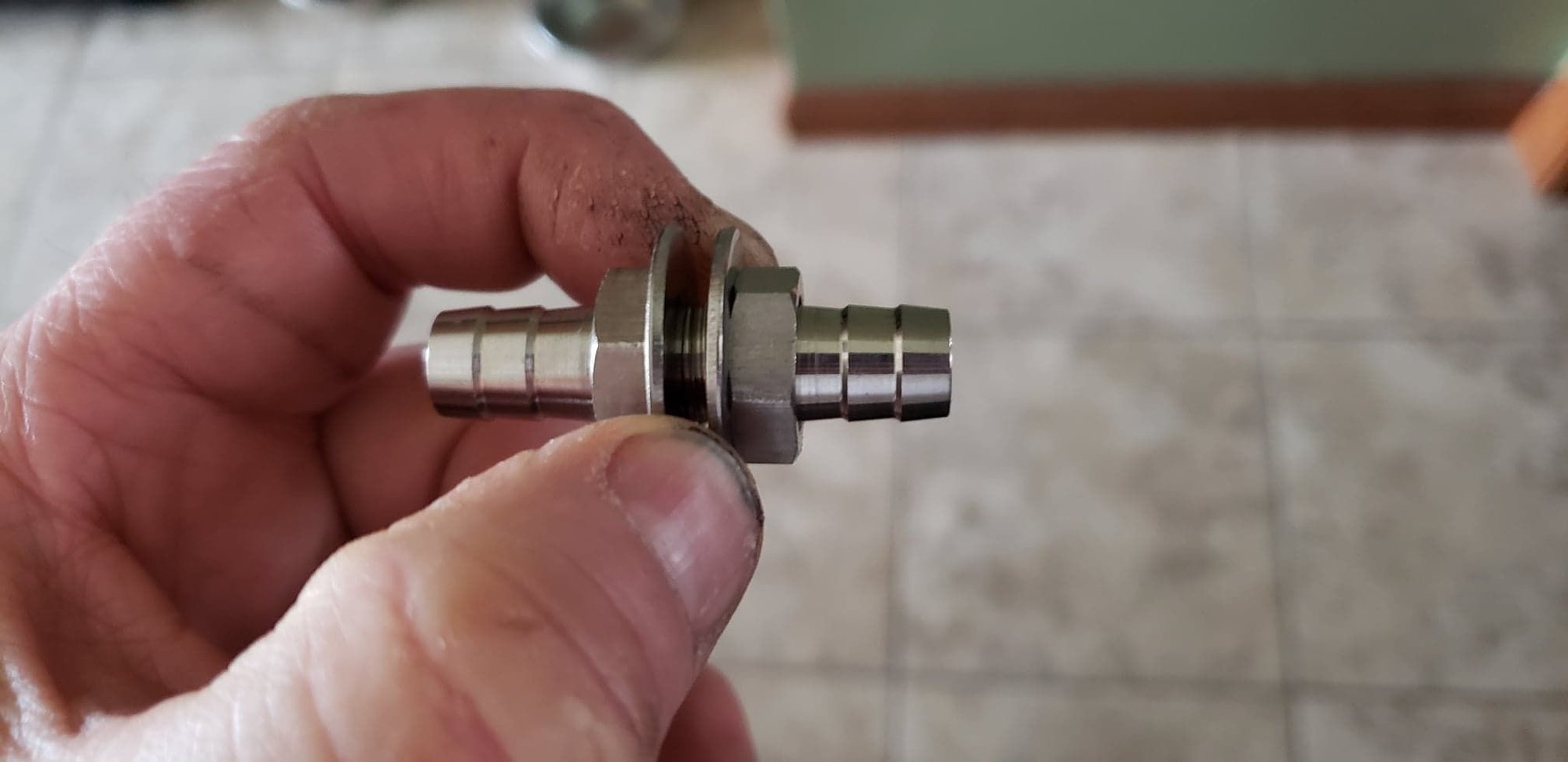

I cut the barb off just past the threads and put the nut on with red Loctite.

Yes, you are correct. The LS6 cover has an integrated PCV, so you do not need one in line.

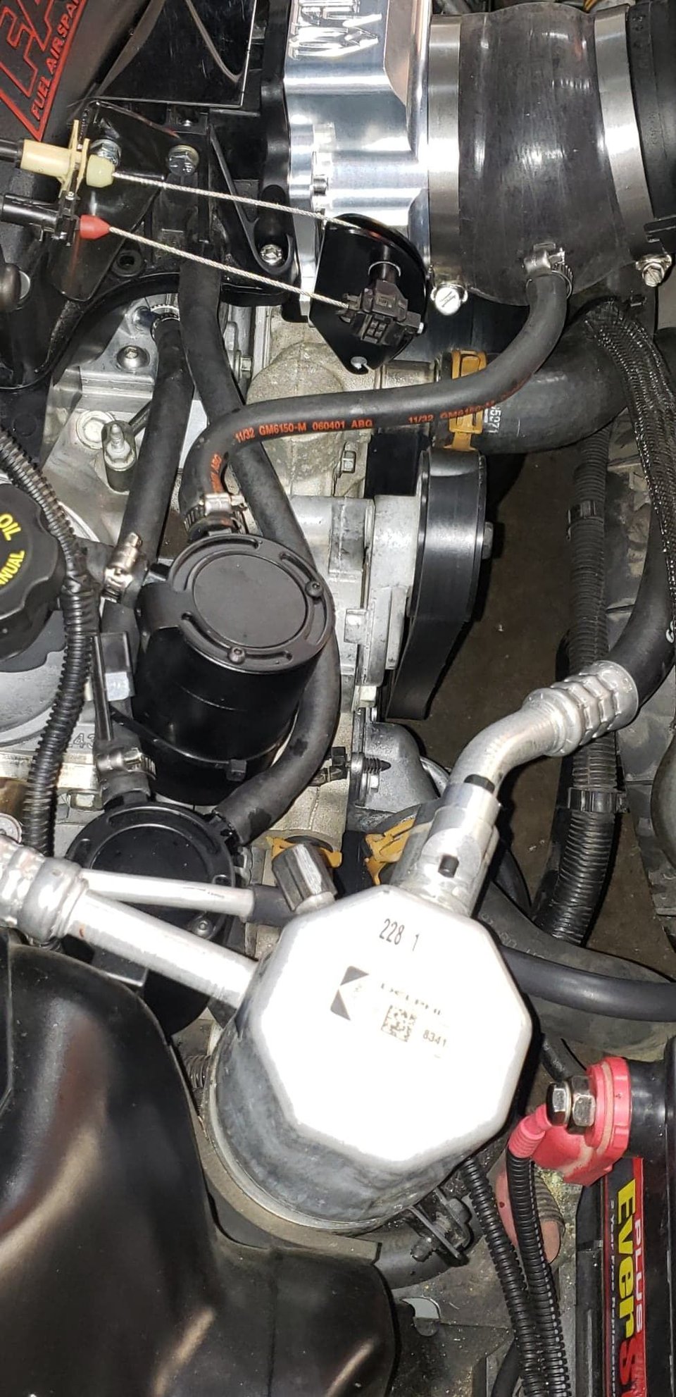

The two catch cans are un neccesary
Since you're using the LS6 valley cover block off your valve covers. Except for one fresh air inlet explained below
Run the valley cover into the catch can and the line out of the catch into the intake manifold. (like you have it already)
Run one hose with no catch or anything from your intake tube into the passenger or driver valve cover. OEM setup was to run the fresh air into the passenger valve cover
You have one catch can correct. The one between the valley and the intake. The other is useless. Take it out and run just a hose from intake tube to valve cover. It's just the air inlet side to the engine, it only pulls filtered air from the intake tube. Nothing to catch there.
Car sounds nasty and spinning is fun as hell, but get some real tires on it before it's wrapped around a pole lol. I love sliding all over as much as anyone, but too many close calls happen with power and street tires. Can't wait to see what it does on the dyno, I have high hopes for ya.

I've read that the PCV system can be overcome at WOT. When that happens, the fresh air side of the PCV will reverse and begin pushing air into the intake bellows rather than drawing. That's the purpose of this 2nd can. What I have done was engineered in another thread here on the forum. Is it need? I don't know. Should the the above ever happen, I'm covered.

Catch Can Routing

It's overkill, but hey I'm all about overkill usually myself so what can I say

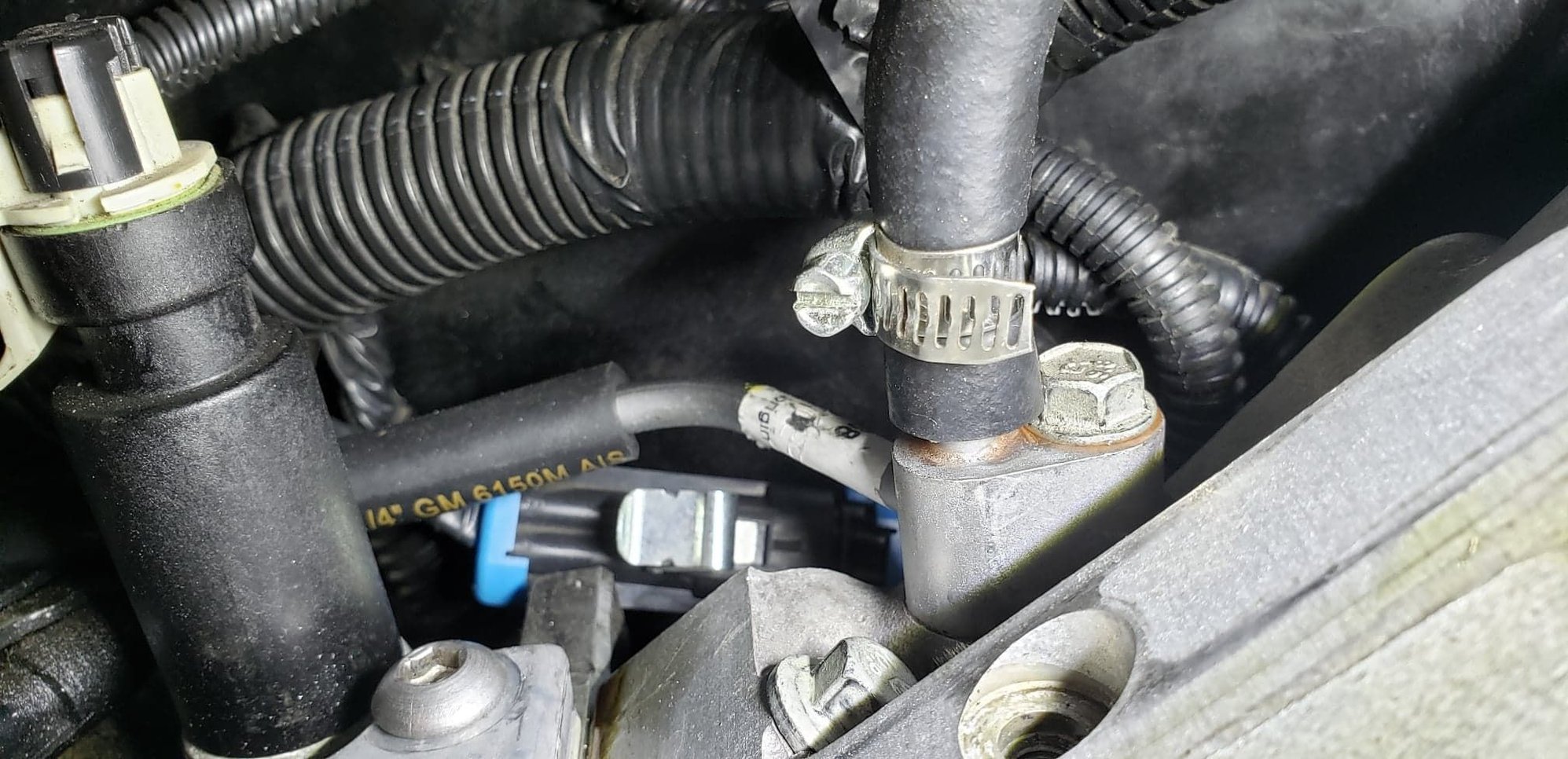

I'm not a happy camper. I was under the car doing the clutch master cylinder drill mod. I found a tiny leak on the far back, bottom corner of the driver's side head, right below the water port, and on top of a boss sticking out of the block. Oddly, I've seen nothing on the floor. I'm going to put in AC Delco 10-108 Coolant Tablets and install ARP head bolts one at a time. What are my chances for success? I've seen where many recommend using these tablets after every cooling system flush. I used them when I built my truck's 6.0. I also sprayed the GM MLS gaskets with Permatex Copper spray, but was advised not to on these Cometics.
It's so aggravating. I was meticulous in my preparation. I'm hoping the ARP bolts will give me a little better clamping force, along with the coolant tablets.

i would verify it isnt a rear steam port before you fo full panic mode

That would certainly be nice. I guess it could be running along the gasket line from up above. I'll probably pull the intake this evening.

On the other hand, I'm going to pull my intake, 15 minute job, and replace a leaking steam pipe seal tonight!

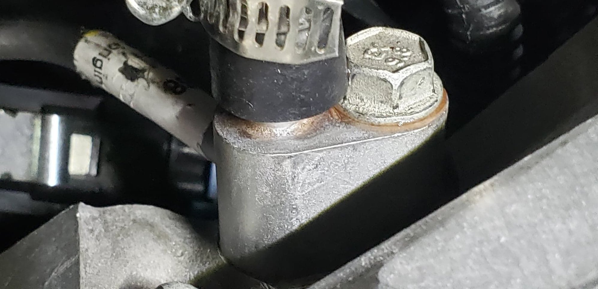

Well, it wasn't a steam pipe seal.................................it was a LOOSE HOSE CLAMP!!! I couldn't be more relieved and greatful. The rear steam pipe is new with new seals, but the clamp on the new hose had started leaking. I tightened it up and added a second clamp.

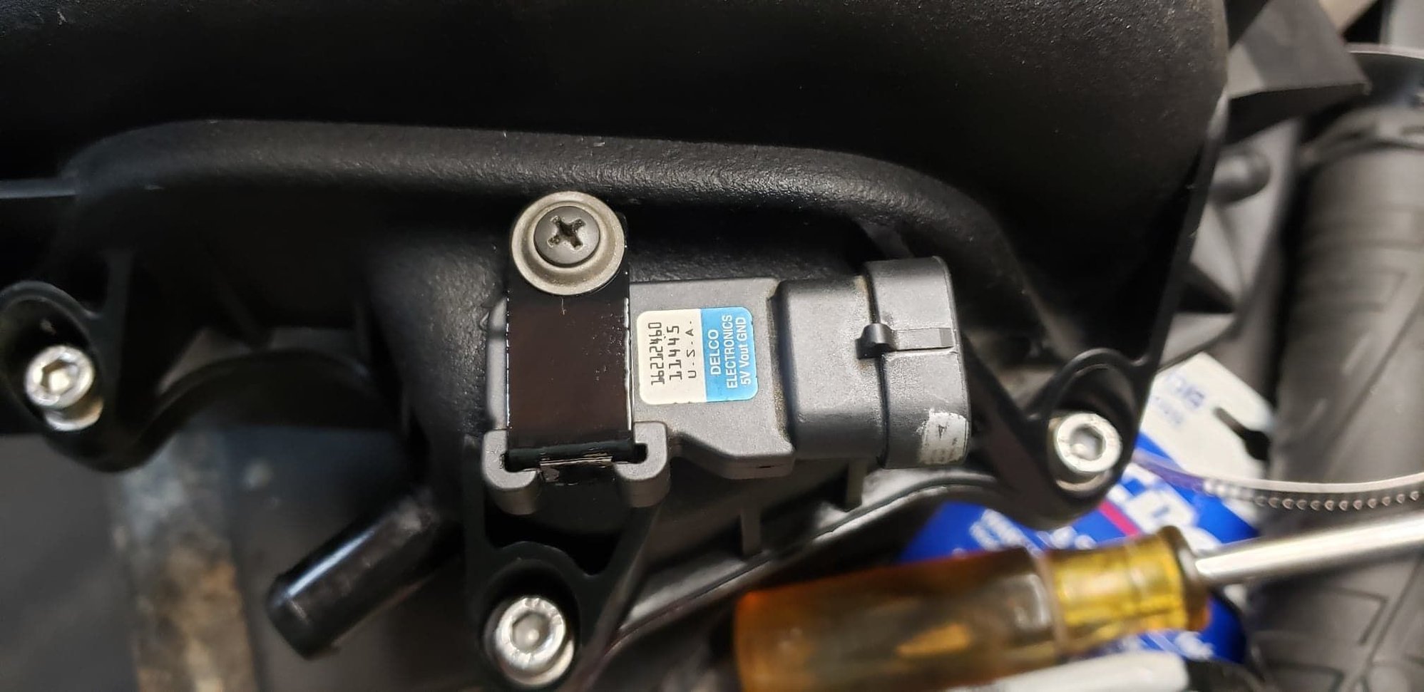

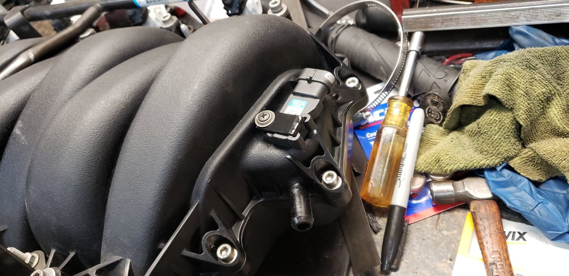

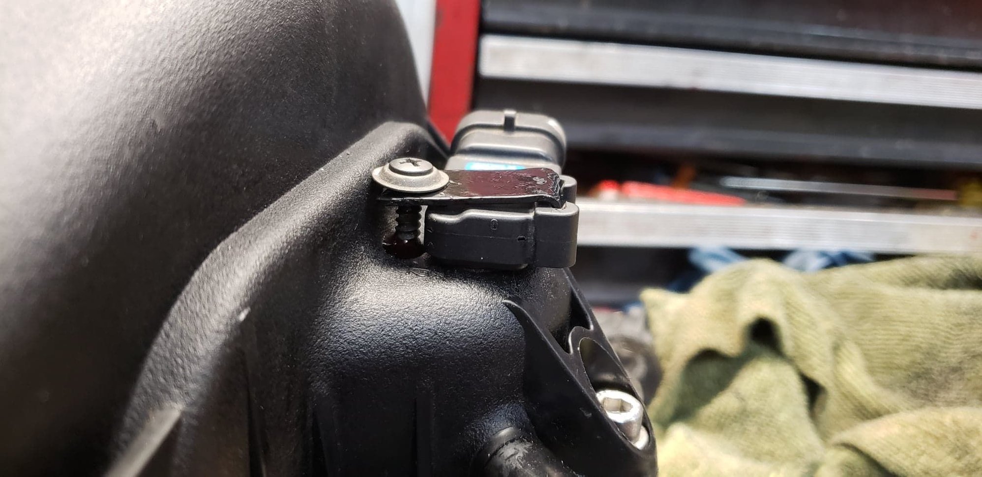

While I was in there I made a proper bracket to hold the MAP sensor down.
