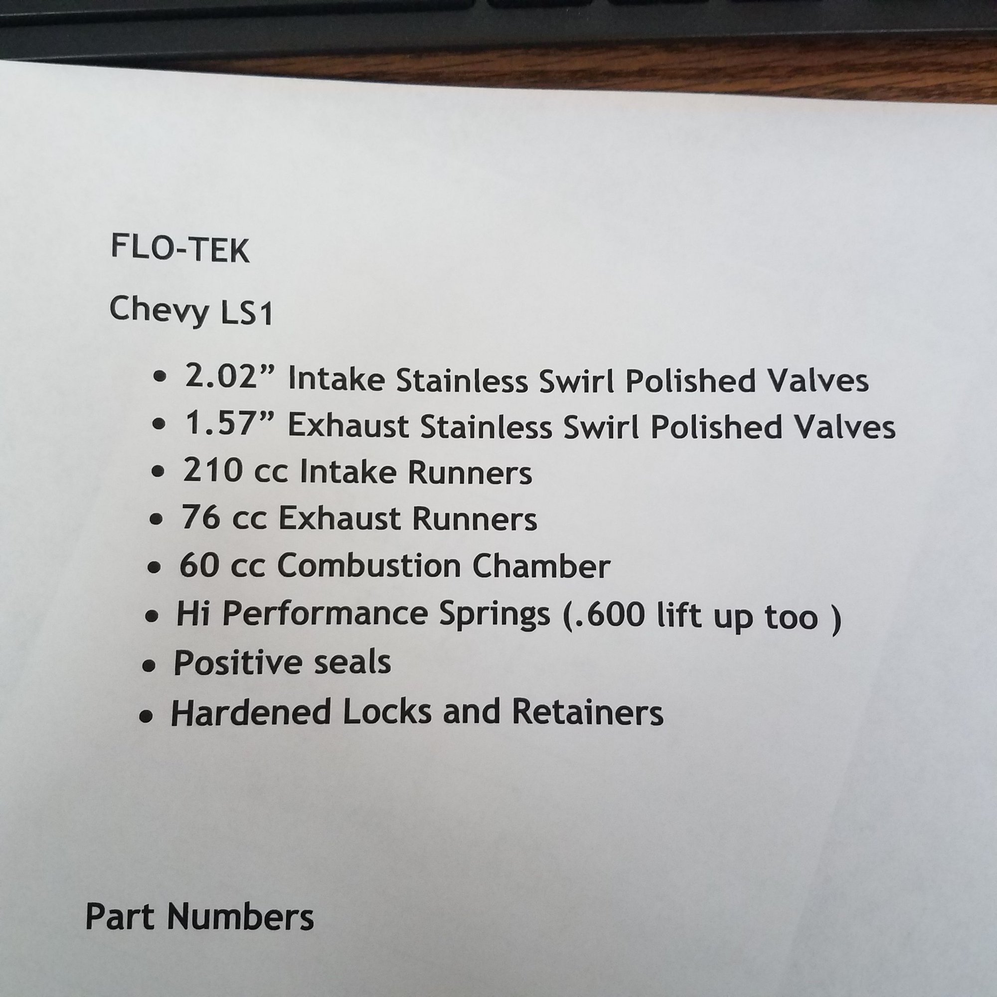

You are correct they are cast. I emailed flo Tec about the heads and they sent me this
Correct they look to be cast. I emailed flo tek and this is what they sent. I assume they no longer make them. I guess it’s their own casting. I would love to find out if any one has experience with them. Yes I live in Ohio. The numbers don’t look much do rent from CNC ported heads

Their online description says they're a 215cc runner and a 58cc chamber as well as the option for a 2.02"/1.60" or a 2.05"/1/60" Valve.
They look good on paper, especially with the 58cc chambers. I wonder how much material's left to work with for porting. I also like the raised valve cover rails for aftermarket rockers.

I've considered buying those same heads from John for a while now. He has had them listed for sale for a while but nobody has bought them.
They definitely don't flow anywhere near the CNC heads.
They're more comparable to 706/862 heads with the flow numbers of the 799/243, or the 243/799 heads with the chambers of the 862/706, however you want to slice it.
